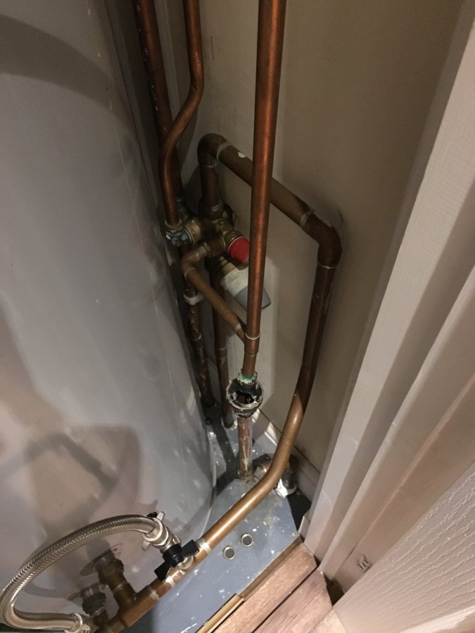

Can anyone tell me if this pipe is supposed to be weeping constantly? It comes from the water tank and exits in the garden at the back of the house. It has quite a steady flow on it, but more than a drip.
You can see it exit the water tank in pic 1
We have an underfloor heating system, not in use right now , it's turned off.
Something wrong or normal ?
Not normal. You have an unvented hot water system, the tun dish (photo 1) and external pipe are part of the safety system. Most likely the combination valve's pressure relief valve is letting by. You need to get it seen to by someone with a "G3" certificate. These cylinders can be dangerous, and should be serviced annually. It is NOT a DIY job.
It's difficult to tell from the second photo but is the red expansion vessel connected to the cold water inlet group of the cylinder ?
Get an unvented qualified professional in to diagnose ASAP, something needs fixed. As OB mentions, unvented systems are not to be played with and needs a qualified professional to work on it.
Thanks guys , I'll call someone in the morning ... Anything I should do in the meantime ? I'm assuming it can wait until someone can get round ... Or no?
Only one flexi pipe connecting the red tank to a group ... Extra pic. The flexi is the 2nd pipe from the back with the bend on it.

Get the expansion vessel changed for one suitable for potable water (normally white or blue) the red one is for central heating and will rot out and flood your house.

Is that the wrong tank for the system ? What's a guesstimate on getting it sorted ?
About £50 for the expansion vessel and no idea what it will cost for labour as the cylinder probably needs a service as well.
Get your un-vented chap out, ask him if the red vessel is attached to the safety group of the cylinder and if so is it marked for potable water. As D mentions normally it would normally be white or blue, is there another blue or white vessel in that cupboard? That one may be connected to the CH circuit so get your chap to check. One more night shouldn't be an issue but do get it looked at tomorrow!
