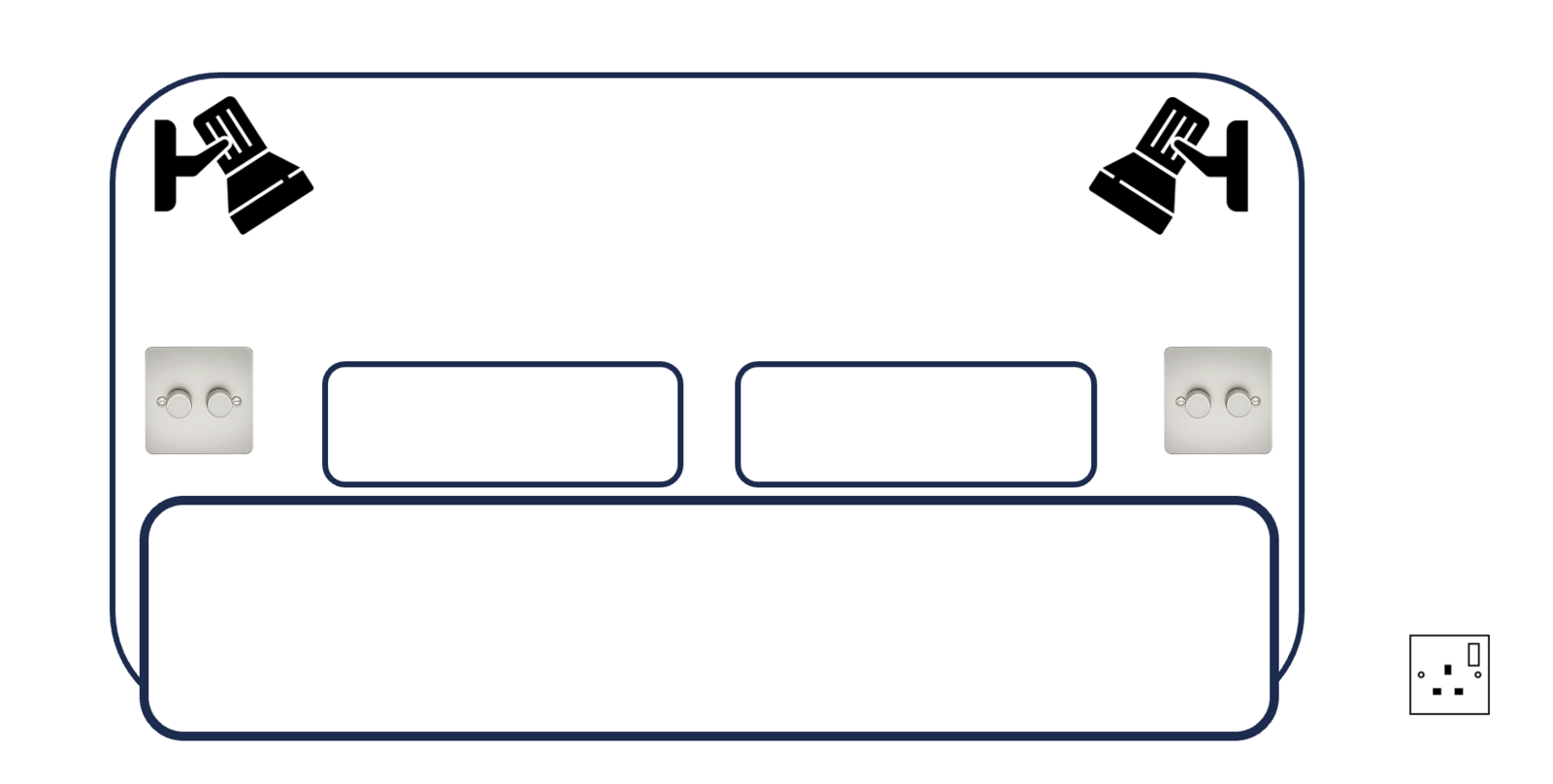

I'm building a bed and I want to install two reading lights to the headboard. I would like to have 2x 2 gang dimmable switches on each side of the bed so I can dim/switch each light from both sides. I'm planing to have all the circuit done behind the headboard and then switch it to a wall plug. Does this seem feasible?
A few questions in my beginner's mind:
Can I do this with two normal wall lamps that connect to the mains?
For LEDs, would it be better to have the transformer separately or incorporated in the lamp?
Would it be ok to connect the whole thing to one socket?
I've read that dimmable LED can be tricky, any special consideration to have in mind?
Lastly, in the perfect world, I would also have a switch next to the bedroom door, but I'm not sure this is even possible without having to break the walls.
Thank you.
To achieve that with 2-gange switches on each side of the bed would be "child's play", but to have each light controlled by two dimmers might (depending upon the dimmers be somewhat more of a challenge.
I have almost that arrangement in my bedroom, but with just one dimmer (and one other switch) on each side. The dimmer controls the brightness (as well as on/off) of the light on its side of the bed, whereas the switch switches on/off the light on the other side (whose brightness, when 'on', is controlled by the differ on its side of the bed.
Mains-powered LED lamps/bulbs do not require an additional transformer anywhere.
Adding a switch (or switches) by the door would, electrically-speaking, be straightforward, but to what extent the walls would have to be damaged to install the wiring would depend on gthe situation. However, there are some clever things like "Quinetic" switches which require no wiring at all (working by very low power 'wireless' communication).

@JohnW2, thank you very much for all the info.
Something like this? That would work for us, your arrangement would be ideal.
In terms of wiring, would I just connect a lead to the socket, split it into two sides and then wire a 2 way, 2 gang?
