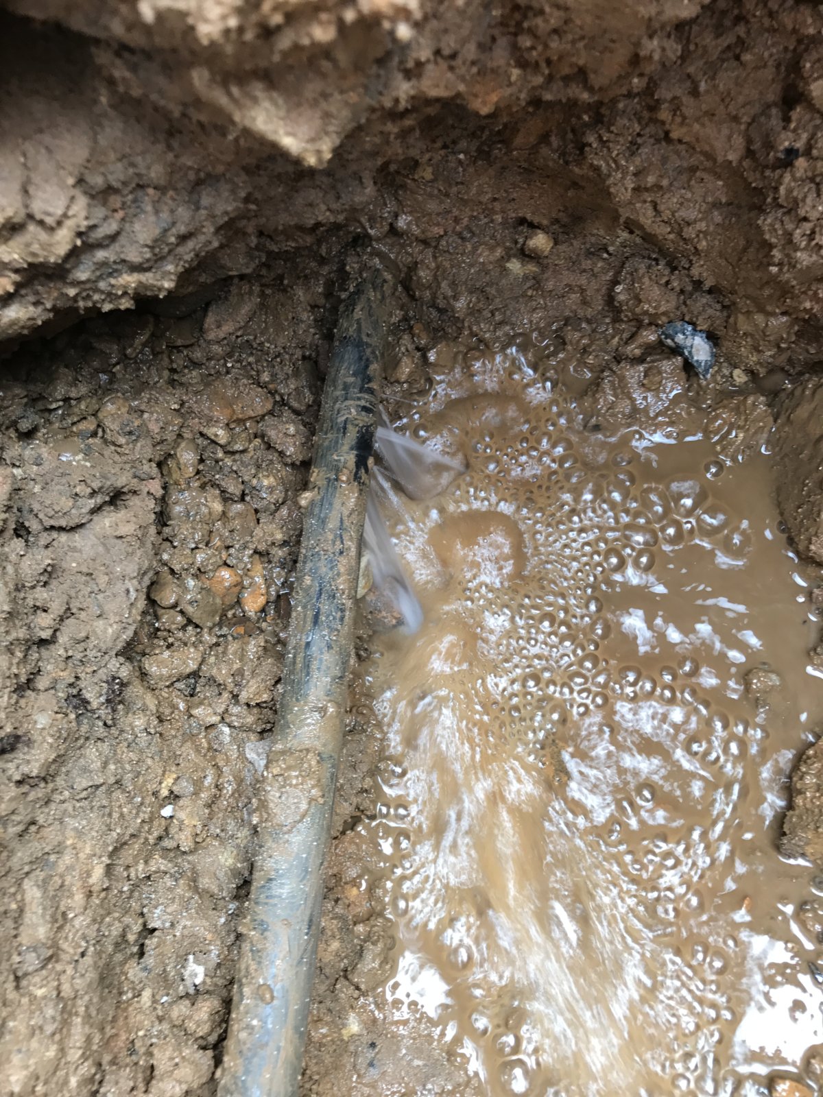

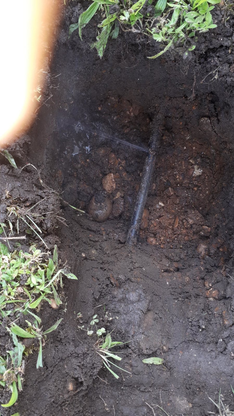

I had a plumber round & he said that when the house was renovated the chances are he could bend the pipe & put a joint in & advised I dig.

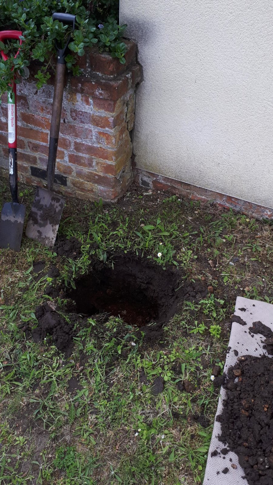

I dug 3 foot no pipe then saw water in neighbours garden & dug, found the pipe.
So the pipe is about 2/3 foot in neighbours garden,, she said permission wasn't asked. So no sleeve either.
Well at least leak found.
Snap!!

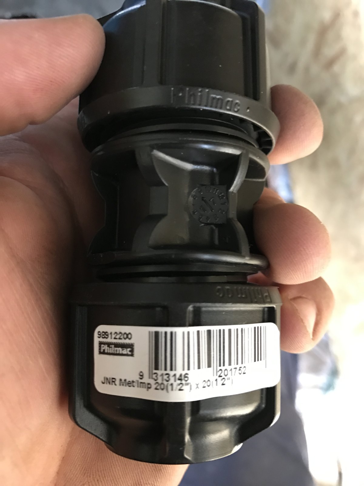

If yours is holed rather than split you could simply cut it and rejoin with a Philmac 20mm UTC.
Its a hole.

You just need one of these then:
I can't imagine it leaking again.
