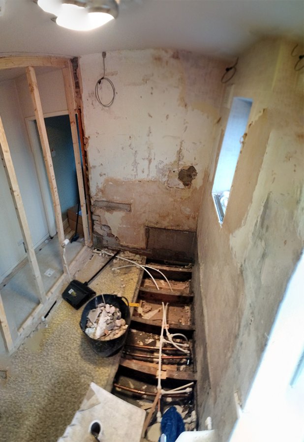

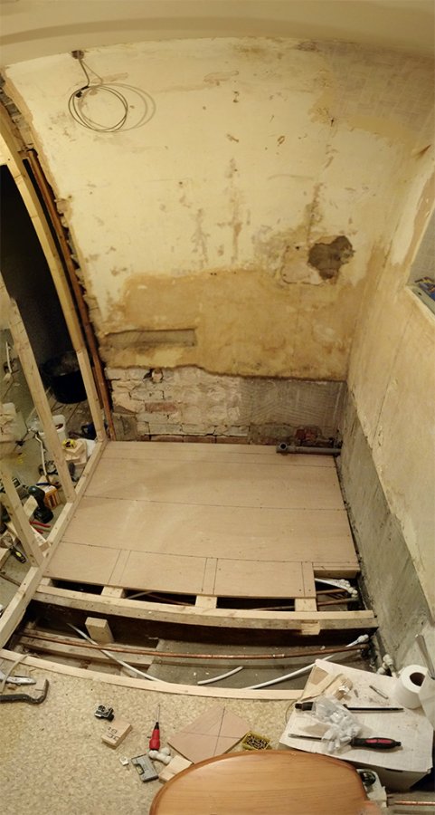

here is how the bathroom looked before this weekend, the bath has turned up and it was time to make a proper start.

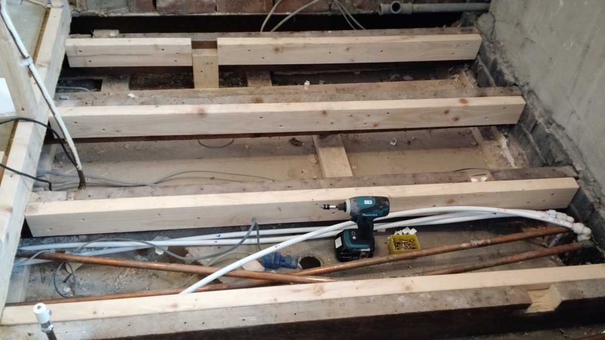

the plan is to change the orientation of the bath and move the sink around leaving the toilet where it is. in order to do the tiling ive pulled up the floor to fit a thick plywood floor as recommended on here. I also realised that, the plumbing had been set up where there would have been a number of connections under the bath in locations impossible to reach when the bath is in place, so i decided to re do all the plumbing so there are no connections under the floor in the bath room. All connections will be accessible from the hall way and a small access area that will be under the kitchen unit. this should future proof it from any leaks, as i wont need to pull the whole bathroom apart to fix it.

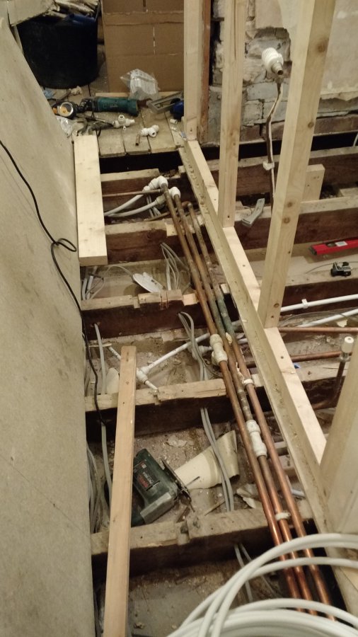

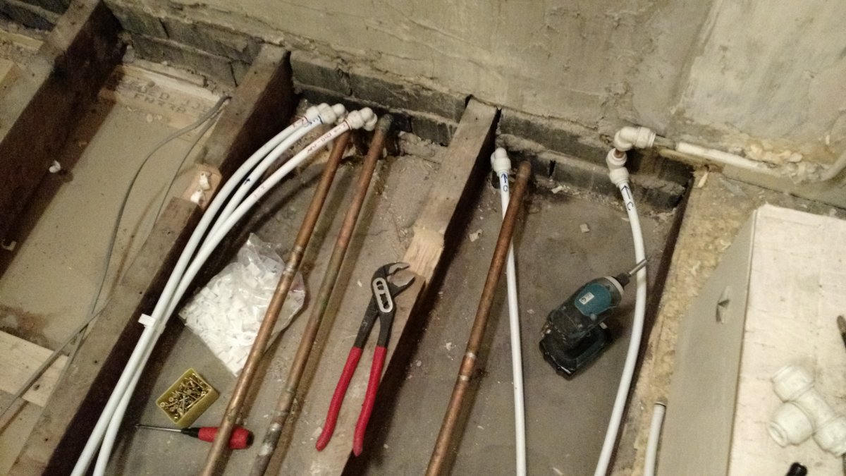

heres how i moved the pipes

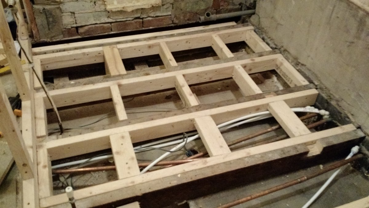

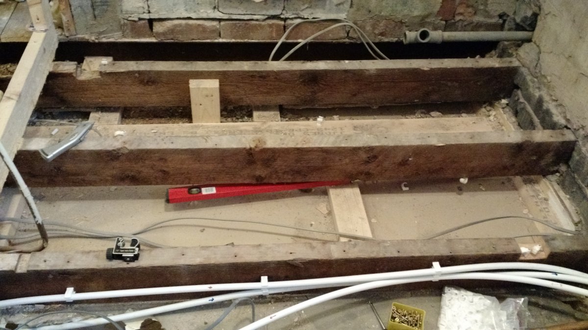

the next step was to level out the floor, the joists were far from level and i wanted the floor to be as flat as possible, so i decided to add move wood to the joists and then nogin between to make it as strong and solid as possible.
only half the room done as im trying to leave the toilet in place as long as possible, living in a house without a bath/shower is bad enough
