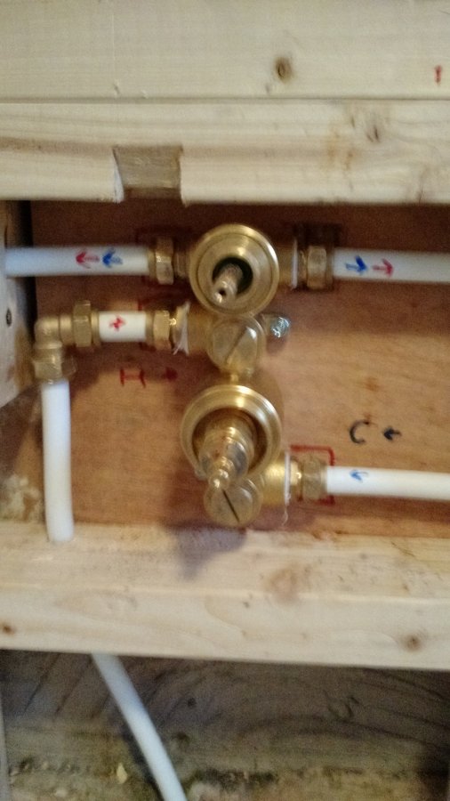

took out the bar shower for a start and reconfigured the pipes under the bath to give me a little more room.

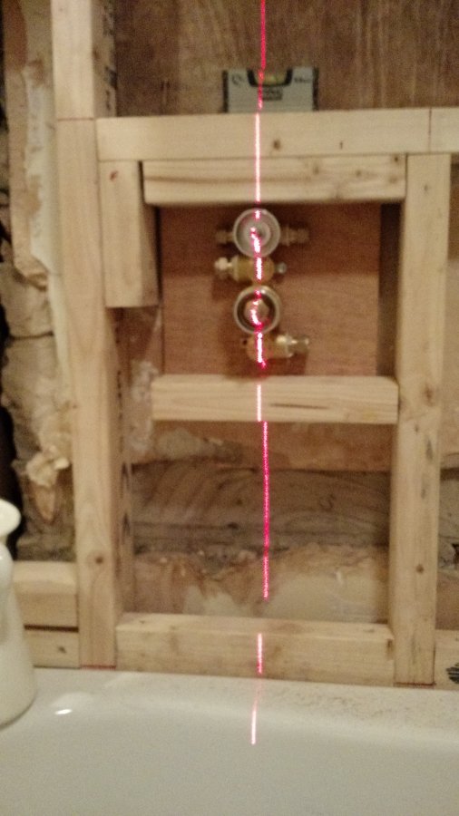

planned the position of the valve

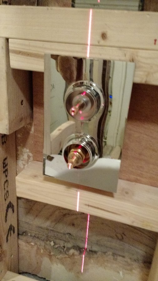

put the shower "arm" directly in the centre of the controls and the taps to the left, so it should look in the correct place, luckily my laser does above below and gives me a nice big cross to mark.

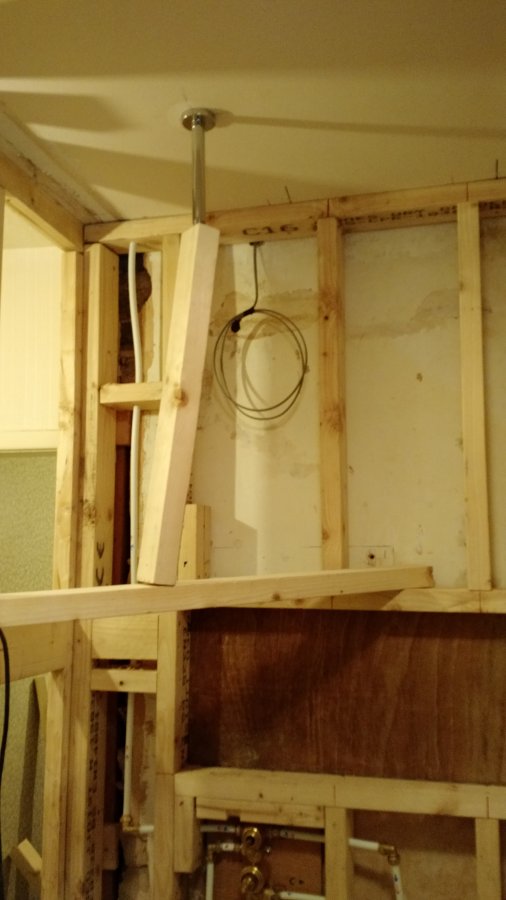

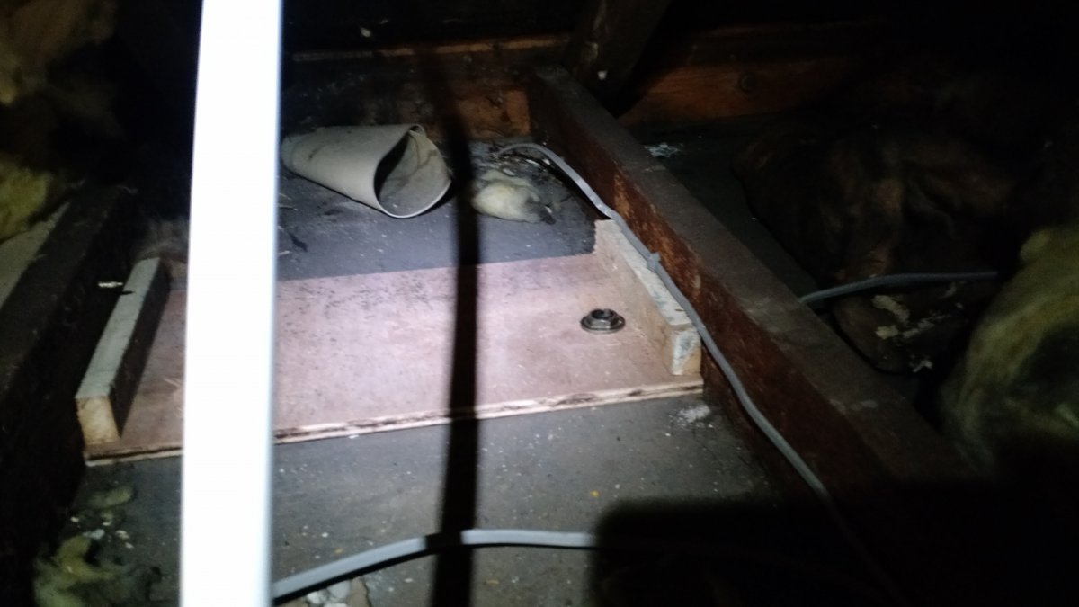

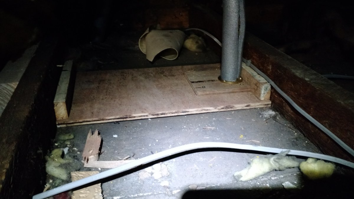

Had to think of a way to hold it in place while i went in to the loft to fit the collar that holds it in place.

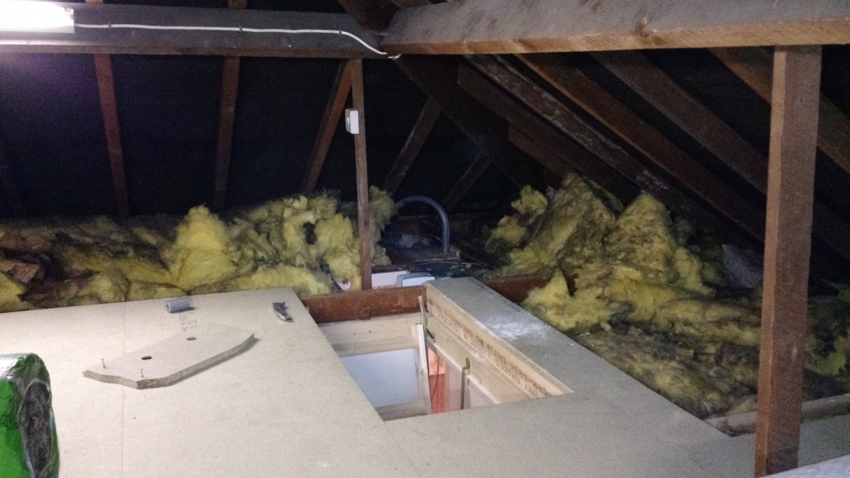

I decided to cut a piece of plywood to add above the ceiling to give the shower a solid base to screw down to, i screwed this plywood to the joists at each side. However this presented me with a problem...

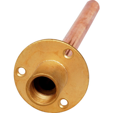

Just enough thread to screw it down, but not enough to add a tap connector to join the pipework... Doh
I looked all over for some solutions that would extend the thread for me and allow me to add a collar and pipework, but the only available extensions only had enough room for the tap fitting, so i wouldnt be able to tighten it down.
much head scratching and a post to DIYnot later i found the following (i really needed something i could get from tool station or screwfix, due to them being open on sundays)
I forgot to get a pic of it in place before i put some insulation over the pipe, but I screwed it to the floor after adding an extra layer of plywood, to reduce the amount of thread showing on the underside. I then used a straight compression connector to add the pipework
I used compression fittings here as all will be inaccessible when the walls are in place and tiled, so i would rather it doesnt start leaking.

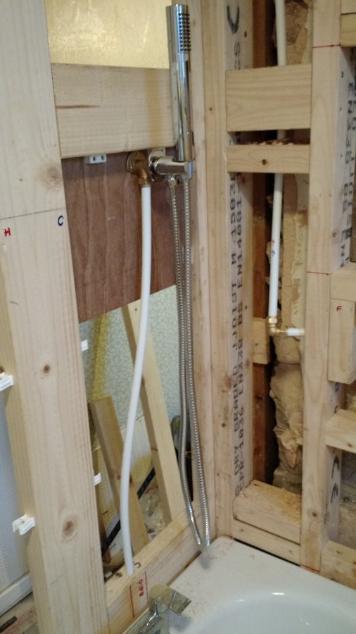

I then finished plumbing up the hand held shower head, that we can use to wash the dog etc.
valve plumbed in
just waiting for walls now!

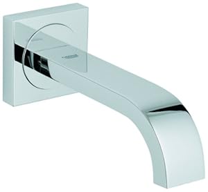

had i found it before drilling the tap holes in the bath i would have plumbed in the third option to be a bath tap like the following
you then control the bath tap from the same interface as the shower and cut down on clutter

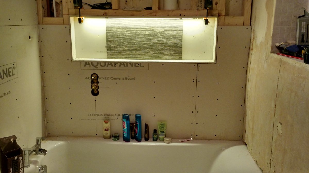

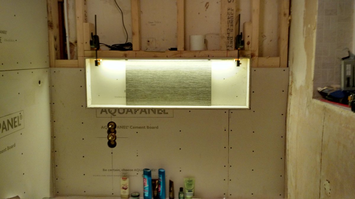

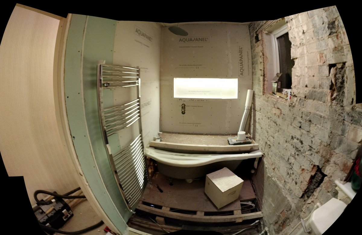

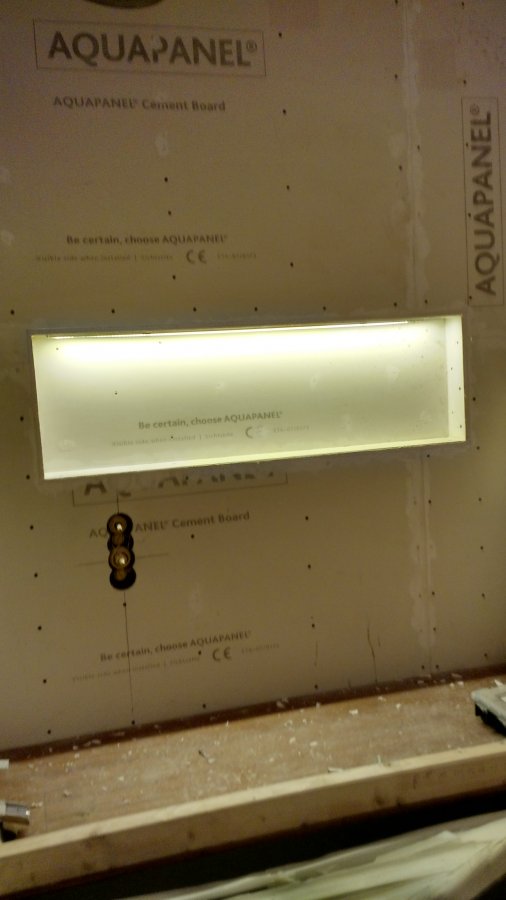

More movement on the bathroom, ive fitted all the aquaboard now, and ive added a light into the niche, Its 12v LED and IP67 fed for the time being from the main light switch, but i may put it on its own switch as it will be nice for low level lighting in the middle of the night when bright lights hurt your eyes. think its going to look great when tiled.

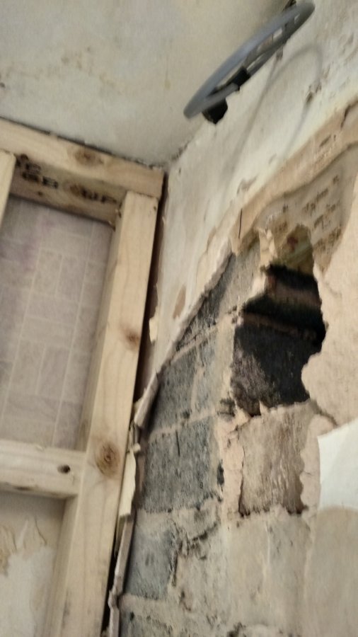

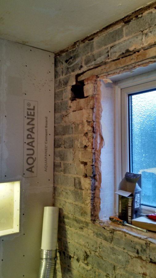

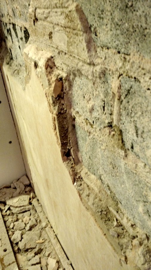

ive had to knock off all the plaster on the outside wall because i realised it was extremely uneven, at the worst point there was 3 or more centimeters of plaster where the thinnest part was less than 1cm thick, the wall itself is level, so god knows what inebriated soul did that job. I went to pick up moisture board to re cover that wall but it was too wide to fit into the estate, Doh! so i may get it delivered this week instead. I plan to use plasterboard adhisive to stick it to the wall which from my research looks to be acceptable.
Ive fitted the radiator in place so i can get the pipes ready in the wall, my biggest problem at the moment is the extractor ducting as i dont have a hole saw big enough to cut the brick on the outside, or a ladder tall enough. but im sure ill sort it soon enough.
Ive filled the gaps in the aqua board with some flexible tile adhisive and im going to tank the majority of it with a paint on tanking kit so it should be pretty waterproof when its done.
the bathroom unit, toilet and sink turn up on tuesday, so i may take some time off next week to try to get the new toilet in and get to a tiling stage as these are also ordered and on the way..

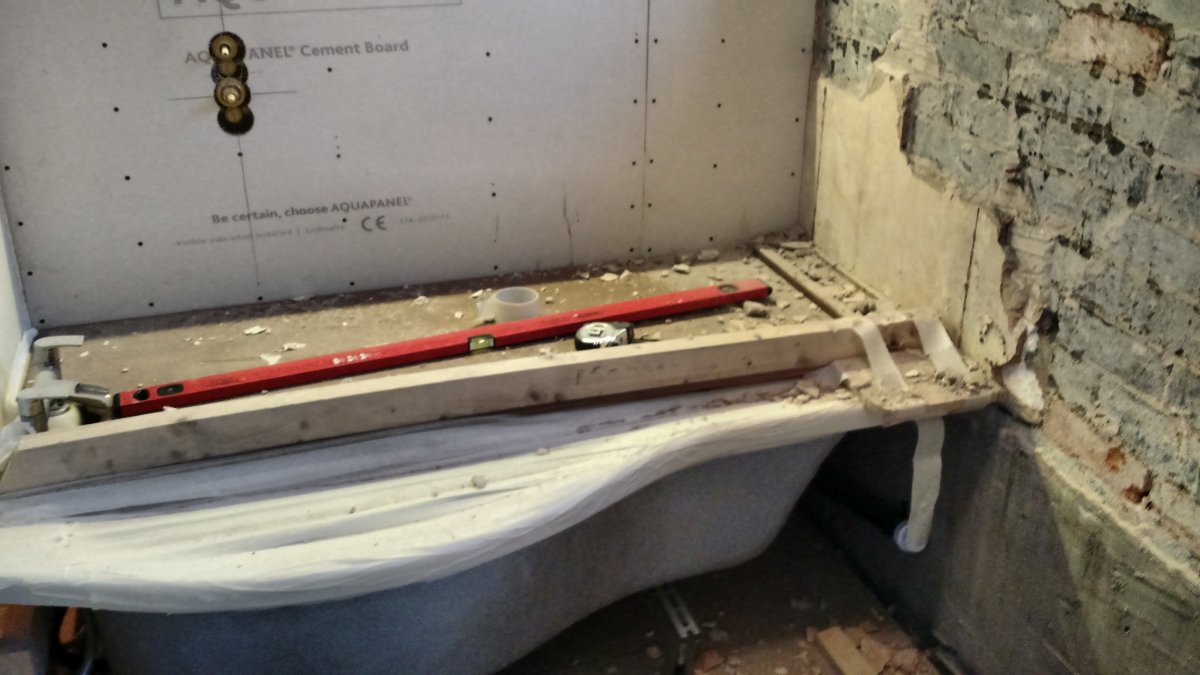

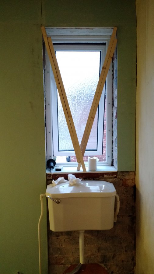

First step was to finish plaster boarding the walls, dot and dabbed into place still have the window surrounds to do, but all the walls are done

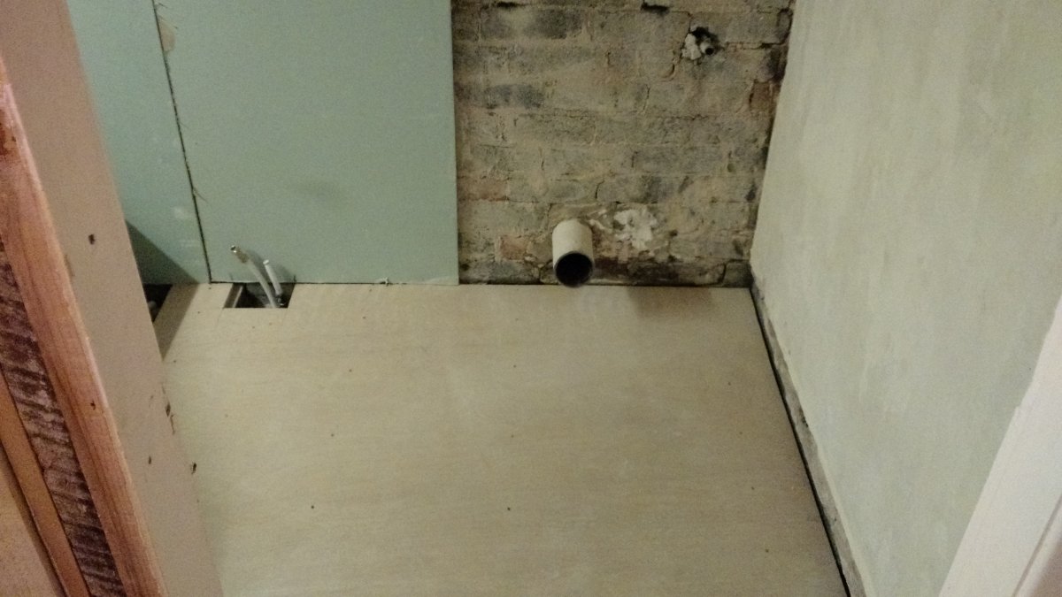

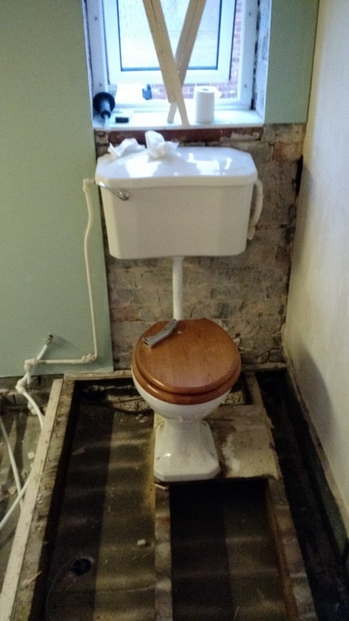

Next step was to rip up the old floor boards, i elected to try to leave the toilet in place as long as possible
I forgot to take pictures of the next stage, but its the same as i had already done on the other side of the bathroom. i used a level to mount new joists to the side of the old ones to provide a level support, i also then noggined all of the joists to add rigidity, and finally i screwed down a new plywood floor that i can tile on to.
in the middle of this i had to remove the old toilet, this was effectivly welded to the cast iron waste pipe, so in the interest of not creating too much noise and mess, i decided to saw it off with a hacksaw with a new blade
Fitted the new floor
