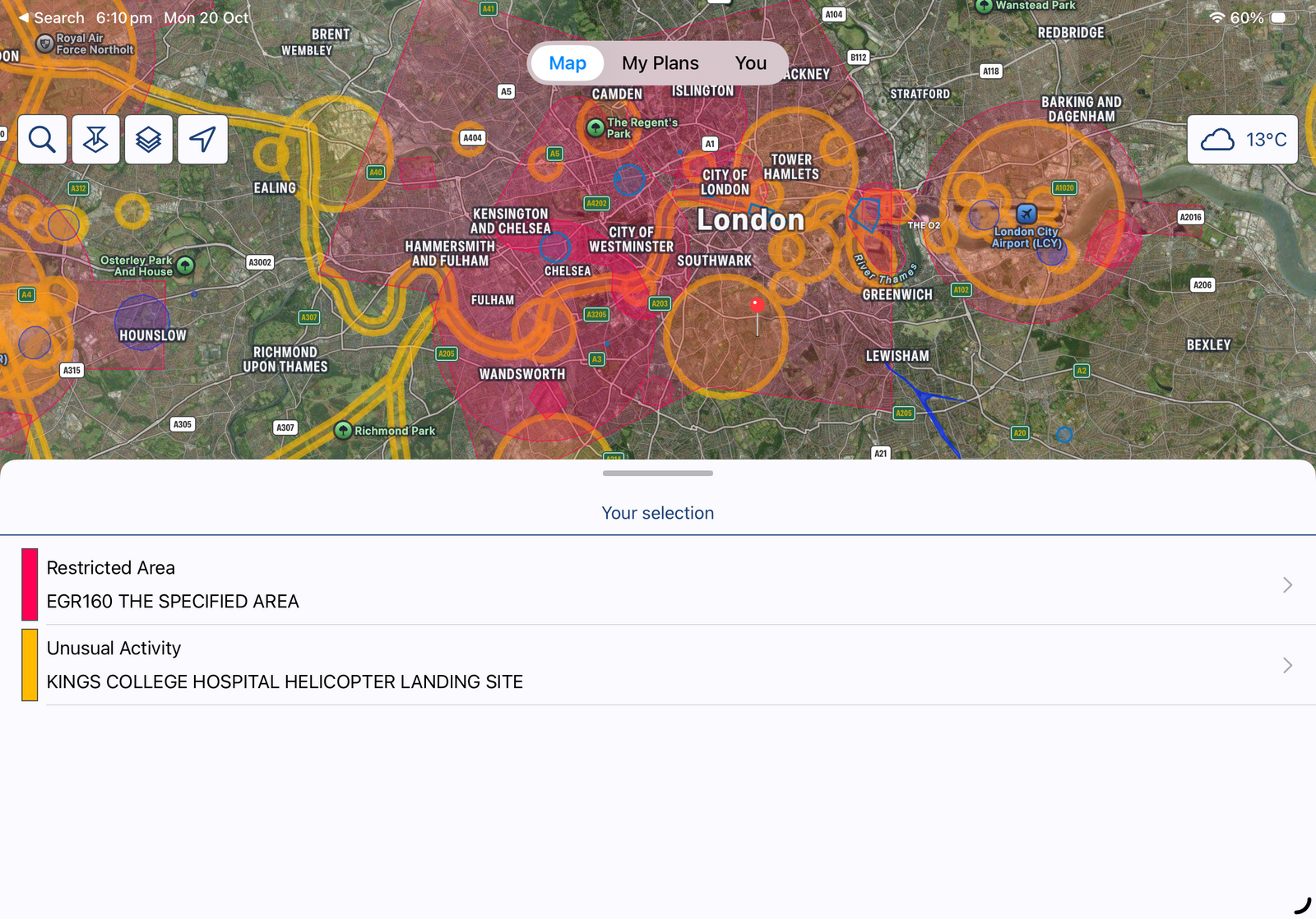

There’s an app called drone assist tgat shows you where you can’t fly etc.
AIUI The Drone Assist owners have gone into administration, so all info from it should currently be taken with a pinch of salt and double checked.
