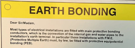

How bad is this house wiring?

I disagree with the statement is not "Earth Bonding" as until not that long ago we correctly called main bonding "Earthed Equipotential Bonding And Disconnection of Supply" Known officially as EEBADS or EEBAD or EEBADOS
so how come the Earthed Equipotentil Bonding portion is not Earth Bonding then?
Earthed is not the same as calling it "Earth Bonding". Earthing and bonding are completely different things. EEBAD was renamed ADS when the 16th Edition was withdrawn in 2008.
both Earthing and Main Bonding rely on the Earthing Principle according to John Whitfield`s Electricians Guide a few years back
It is bonding of the Earth supply from the mains to other things so I am struggling to think Bonded Earths is that far away from earth Bonding.
Yes Bonding and Earthing are different yet we bond the earth to our pipework etc too.
Is it so wrong to call it Earth Bonding, well yes, but only slightly, they are two sides to similar things. Not quite totally seperate, very closely related in some respects but different concepts in the main. It is equi-potential and it is earthed (main bonding, supplementary bonding is a bit different)
Hence EEBAD as we used to call it.
supp bonding is equipotentioal.
Main Bonding is equipotential EBAD(S) Main Bonding is earthed EBAD(S), It is both so it is EEBAD(S).
Earth or Earthed , pretty much similar? small play on a basic word.
