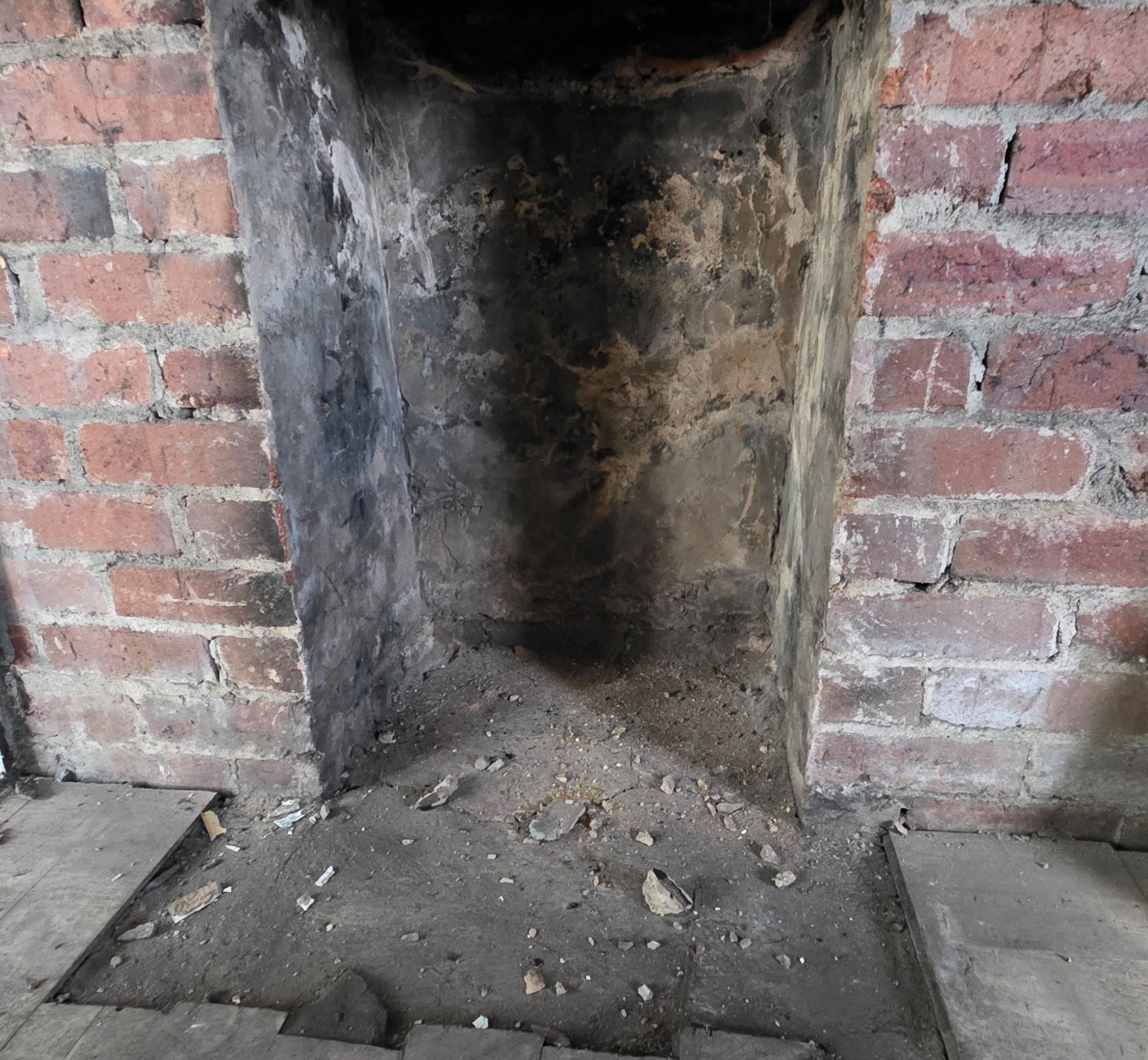

Hi
I've just bought a house that had a real fire, im going to get a log burner installed and preferably want to expose the brickwork in the fireplace but it seems to be covered in mortar
What do you think the best way to expose the brickwork is if its covered in what I assume is sand cement ? Chipping it off will probably damage the bricks a bit and take mind numbing ages
I thought a still wire brush attached to a grinder or drill might shift it
See pic

Forget the wire brush & similar. The render is almost a thin skim and can be easily chipped off with a hammer & chisel - slide the chisel behind the render & kind of prise it off.

Anything mechanical cleaning risks looking contrived. The best way is to re-line an opening with new brickwork.
The opening looks a bit of a tight fit for installing a wood burner, so perhaps taking out the old plaster and re-lining with new (tiles?) would be best.
It is a bit tight admittedly but it wont need a big stove so ill have to check.
Depending on the thickness, I wonder about using a combination of a flat sharp chisel - flat against the brickwork at the sides (not sure about the back face), and (brick acid) hydrochloric acid...
You might find it comes off quite easily. At the back a scutch hammer could be easier, just don't hit it too hard and take small bits off at a time.
