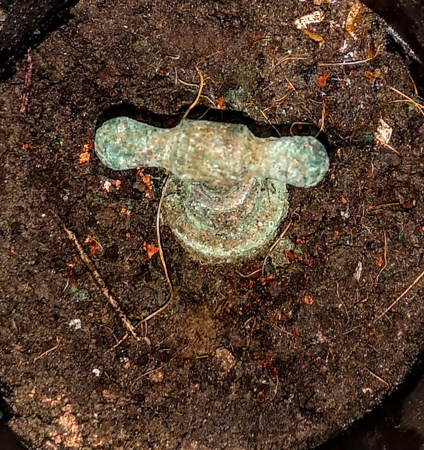

Most likely soft copper or Alkathene ' If you can get a clear photo of the stopcock in the pavement - even clean off the pipe on your side - we may be able to tell you . Also your indoor stopcock , showing the pipe coming in

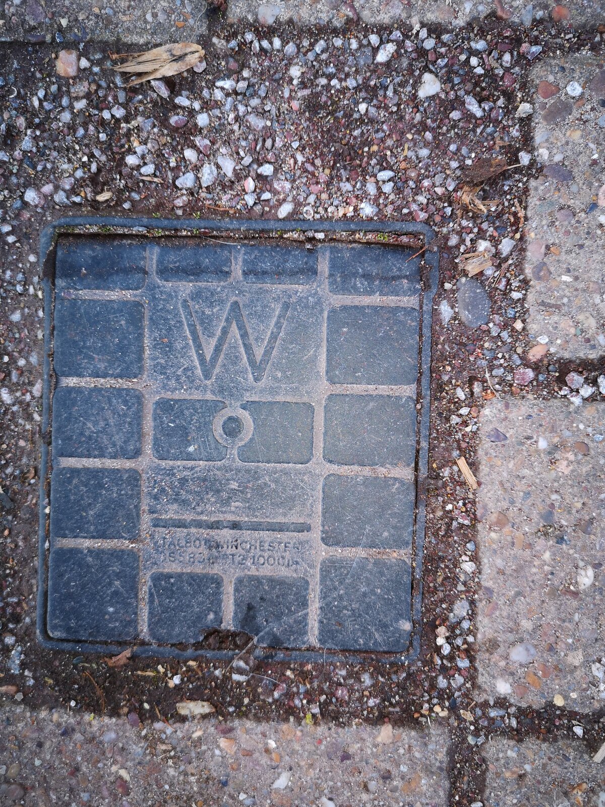

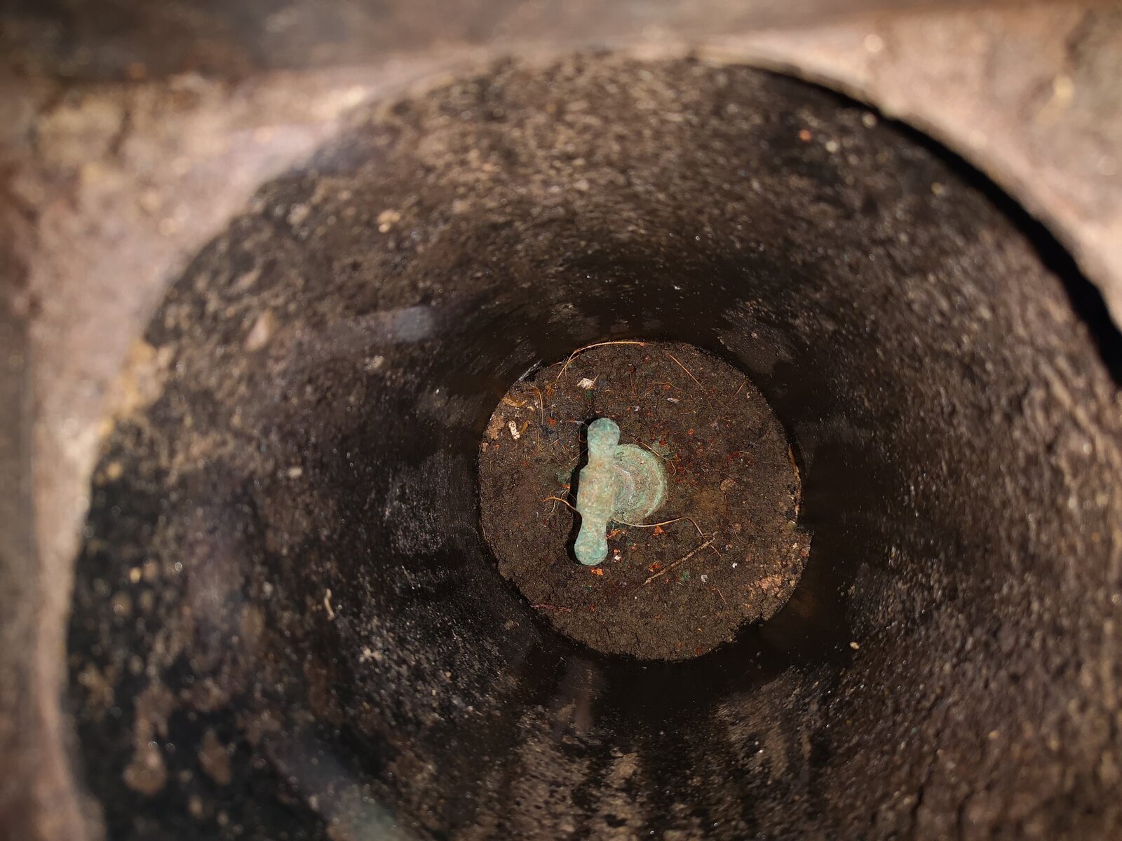

A couple of photos. Not confident to clean down there in case I break it... or something eats my arm off...
The indoor stopcock is on 1/2" copper, so likely(?) that the 15-17m run to the pavement stopcock is too (just buried - That's a lot of old joints sitting in the mud?).
Is it likely that they would have connected the big main to the pavement stopcock in 1/2 inch copper too? Just wondering if they might have made provision for growth or they might have done that bit in lead.
The stopcock in the pavement looks ancient, but most likely dates from 1963. The supply pipe on my side is unknown, although the pipe visible in the house is 1/2" copper.
I know that the only way of really knowing is to excavate, but views are welcome
As said - a henry hoover would get that debris out the pit - that's a good photo but the bit we need to see is just under the debris:(
