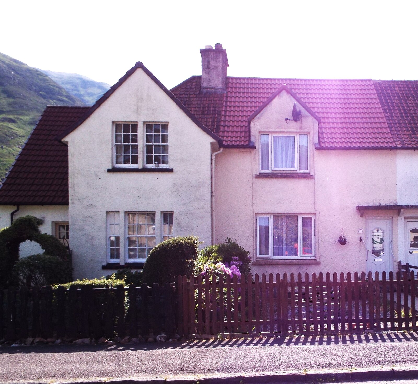

Hi, I know I ask some strange things on here but is there an optical instrument that would measure from the left end of this house to the edge of the protruding bit where the white downpipe drops, behind the bushes. I would like to transfer the measurement to the back of the house where the neighbour from hell I've mentioned before has definitely stolen some ground from the elderly lady next door.

at a guestimate, if that is a 3" downpipe, then a tad under 12'6"

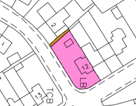

Thanks all, I have the title deeds at 1 to 2500, but haven't a clue how to get measurements.

Complete waste of time measureing anything off google earth, a map, the deeds. Any map or deeds plan will have been copied multiple times and lost any meaningful scale and any lines are about half a metre thick.
what sort of accuracy are you aiming for ?
This will do it down to a metre.
(although I have just measured my house and it says 19m when its only 17.5m
a digital camera will do a much better job, place an object of known dimensions in front of hedge, have exact distance from camera to object, and guess as accurately as poss from object to gable wall. (make sure camera to object is at least twice as far than from object to gable. I'll do the maths for you.
12ft odd is the width of the gable facing the camera, think he wants the total width of the house up to the party wall, so more like 19ft/20ft. Which kinda tallys up with google earth and the road markings.
I can sometimes get my iPhone to make a reasonable estimate of measure using its camera
If you have the size for the door or window, you can extrapolate the size of other parts from the photo using pixel distances. Best to use cameras that have large lenses to minimised lens curve distortion when taking the picture.
Additionally, if you use the chimney for reference, one side of it marks the boundary.
