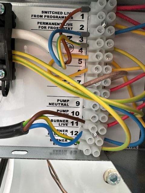

How can I tell if my external boiler is wired properly for frost stat operation??
Hi exedon, mine is the 15/21 which is a tightly fitted unit and why I chose it as it was going on a walkway of 900mm and only taking up 400mm all in. I’ll get a look at the wiring tomorrow and if it’s no right I’ll get you it sorted.
But I guess my main question is how can I tell if there is no permanent live to the boiler at present by using what is actually there??
Cheers
You need a permanent live its that simple should be wired In to L2 . You need to check connections if any of incoming supply's have been linked that's not correct either.
They really are a simple boiler to wire including pipe stat work in boiler 10 min max.
When you get cover of post some pics.

Exedon,
As per pictures above it is clearly not wired correctly just a twin and earth to the boiler off the programmer switching. No wires back to the wiring centre to feed the pump nor heating valve either obviously…
I’ll have to get on to the plumber next week and get the spark back.

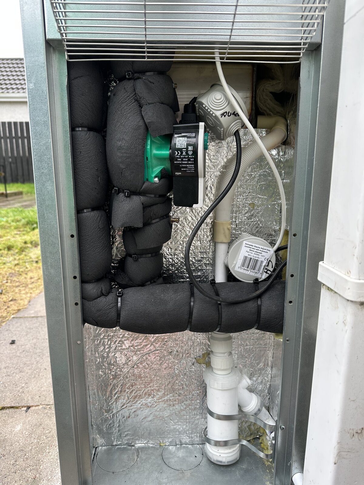

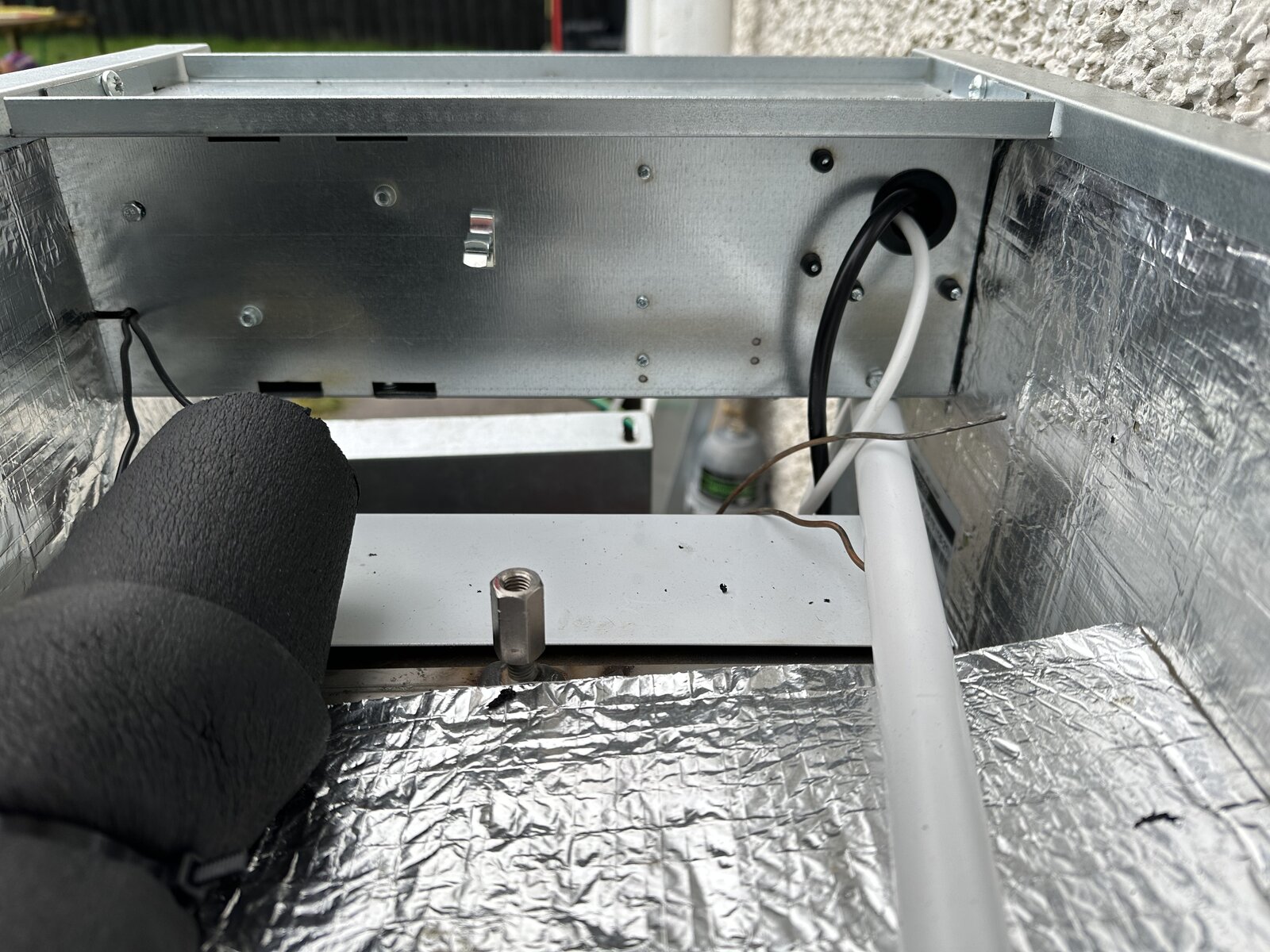

Couple of observations that's a cat's breakfast way to pipe it up . Even on that model there's enough room to fit pump above boiler leaving room for system filter to be in back section,
We use 'spare' flue hole to take pipework into building using a section on soil pipe as a sleeve.
We would always take condensate waste into boiler case in
1 1/4 never have overflow pipe external.
Going by the collection of junction boxes you probably have enough cables into boiler just need to be reconfigured .
I guess a cats breakfast looks like a Dogs dinner…
And I agree completely. Strangely the installer is well thought of locally and I was put off using several others because of their bad reps so who knows what they’d be like 8-|
I was expecting them ( plumber and mate) to take the pipes through the holes for pipes individually with 50mm core holes and insulate right through.. I hadn’t considered the spare flue hole which has loads of room as you say and would leave loads of room.
The pipe work in the boiler was barely lagged so I redid that all. The condensate trap was sat on top of the flow and return with the flexi condensate pipe going upwards like a rainbow before dropping back down with a kink in it…. And the rest of it was a proper picture… I redid that myself and while I know 32mm is ideal outside there is very little exposed to freeze and I’ll be covering the internal pipe with a layer or 2 of insulation out of the old boiler so it will only be a the last 200mm exposed.
