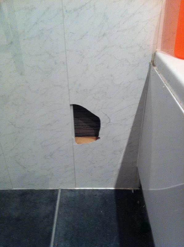

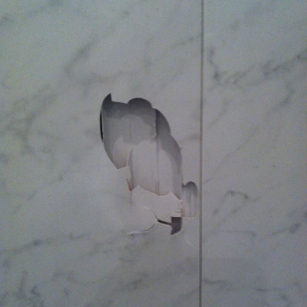

Hi All
I have a bathroom cladded with the cheapy plastic TG marble effect and in a few places there have been knocks/holes.
These are in the middle of the wall in etc and all are screwed/siliconed in place.
Will i have to cut a section out ? But how wouldi put it back in as its t&G??
Any ideas ?
Cheers
Bottom pic is obviously an end piece, so the new one would snap in after cutting to size/shape. to remove, use a sharp stanley type knife and cut at an angle so as not to remove too much of the t&g. The top pic could be inserted at one side and then curved by hand and located then snapped in. PS i've done that myself.
