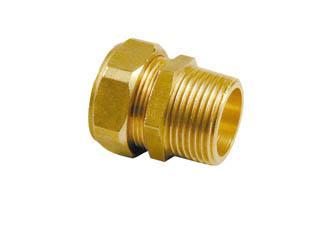

- movement was only slight, and it treacled out underneath - ive got the valve off and the ring/sealer is compressed into the pipe and pipe is bent (not by me) so cant put new one on (i have 4 compression stop ends) - what would you recommend with the pipe? - even if just a temp fix for tonight?
If i get it sealed and capped can i fill the system without the radiator on for heating tonight? - then, perhaps tomoz while I have the floor up i could splice a new pipe in there for proper new seal on the valve......
thanks again m8y - much appreciated
cut the pipe back fit a comp stop end
then all you have to do is use a comp straight when you reconnect
if its under the floor all the better :wink:
thats what I was JUST thinking - cut top off to fit new stop end for tonight...
what its 'comp straight'..? - is that just using the nut and sealer ring from one of my 'compression stop ends' to seal the valve on new piece of pipe I fit onto it? (as you can tell i dont know the proper names for the bits hehe)
yeah the new piece will be under the floor - spliced into old pipe , so new piece is sticking out the floor - then i will use a nut and sealer from one of my stop end packs and screw em into the valve so it has new fresh seal - jobs a good'en... hehe

comp= compression

i knew comp was compression, i just didnt know what you meant by 'straight'

I know what you mean now by comp straight, its just a join for two pipes, at least I know what I am looking for now......
