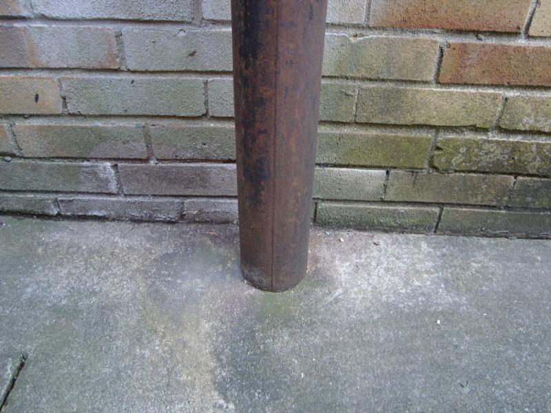

Below is a picture of the bottom of my early 1960s cast iron soil stack. It has been cracked further up for a while, but the freezing weather has resulted in a couple of large pieces falling off.
As a result, the smelly brown stuff is leaking out, causing a bit of a stink!!!
Due to redundancy, I need to replace the stack myself. I have done some plumbing over the years. My questions are;
1) How do I join the pipe where it goes into the concrete at ground level? Do I cut the pipe off flush with the ground level, or can I chip away some concrete around the pipe, and pull the pipe out of the ground?
2) What connectors are best for the bottom joint?
3) Is push fit best, or do I need solvent weld pipes and joints for the whole stack?
Many thanks
You need a large angle grinder to cut off ABOVE ground. You have to cut a slot about 200 mm high to enable the body of the grinder to reach for the rear of the c.i. pipe.
Then cut off above damaged part or remove the whole lot.
Use a rubber joint which is tightened onto the c.i. and the plastic with Jubilee clips.

hire some cast cutters to cut bottom.
A good plumbers merchant will sell everything you need inc the bottom joint.
Use pushfit for everything cus its easier except vent where it offsets around soffit as the wind may make it move.
If these "cast cutters" are the ones with a "chain" of cutting wheels then there is not usually enough space behind the c.i. pipe.
Tony
cut the soil pipe level to floor then insert one of these.
look better than the rubber sleeve and jubilee clips.
looks like theres room from photo, and I would rather use cutters then a angle grinder.
