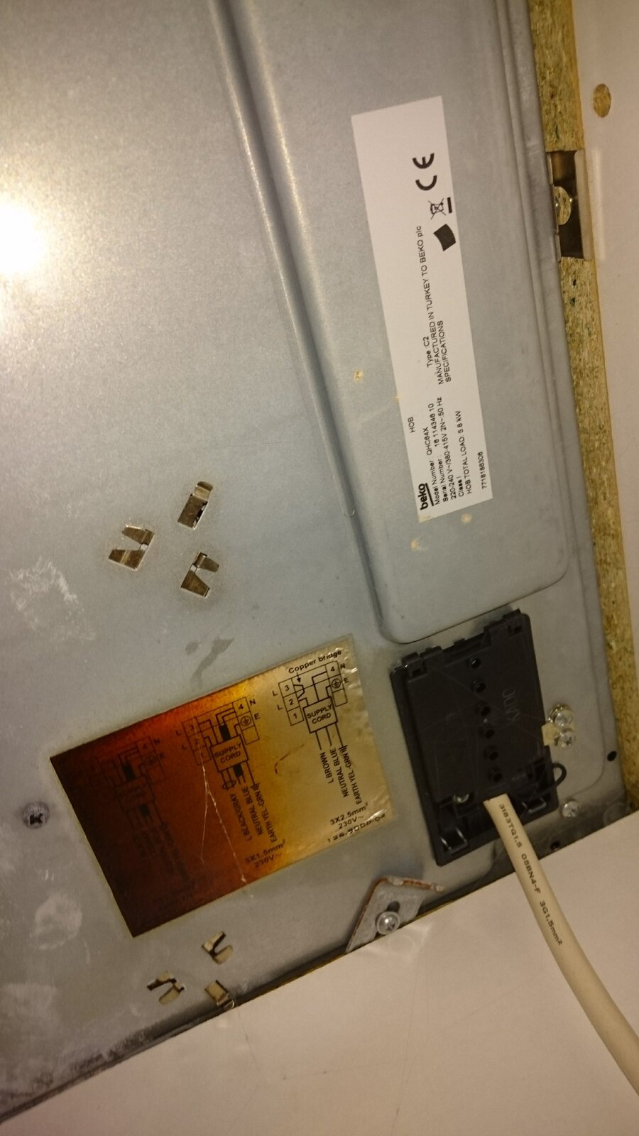

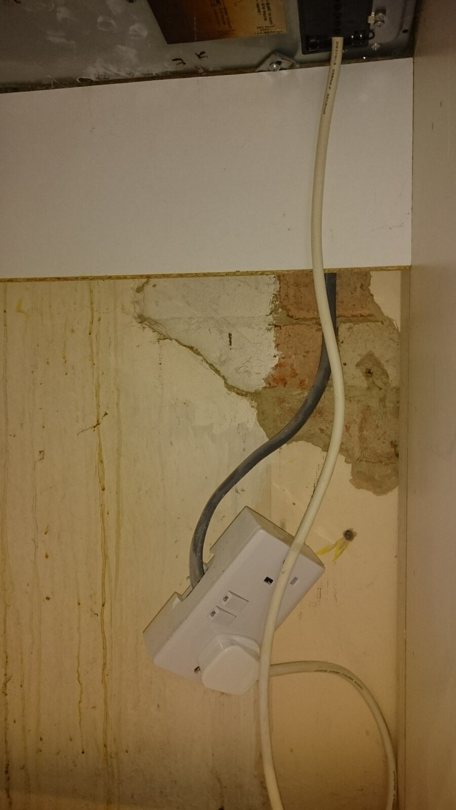

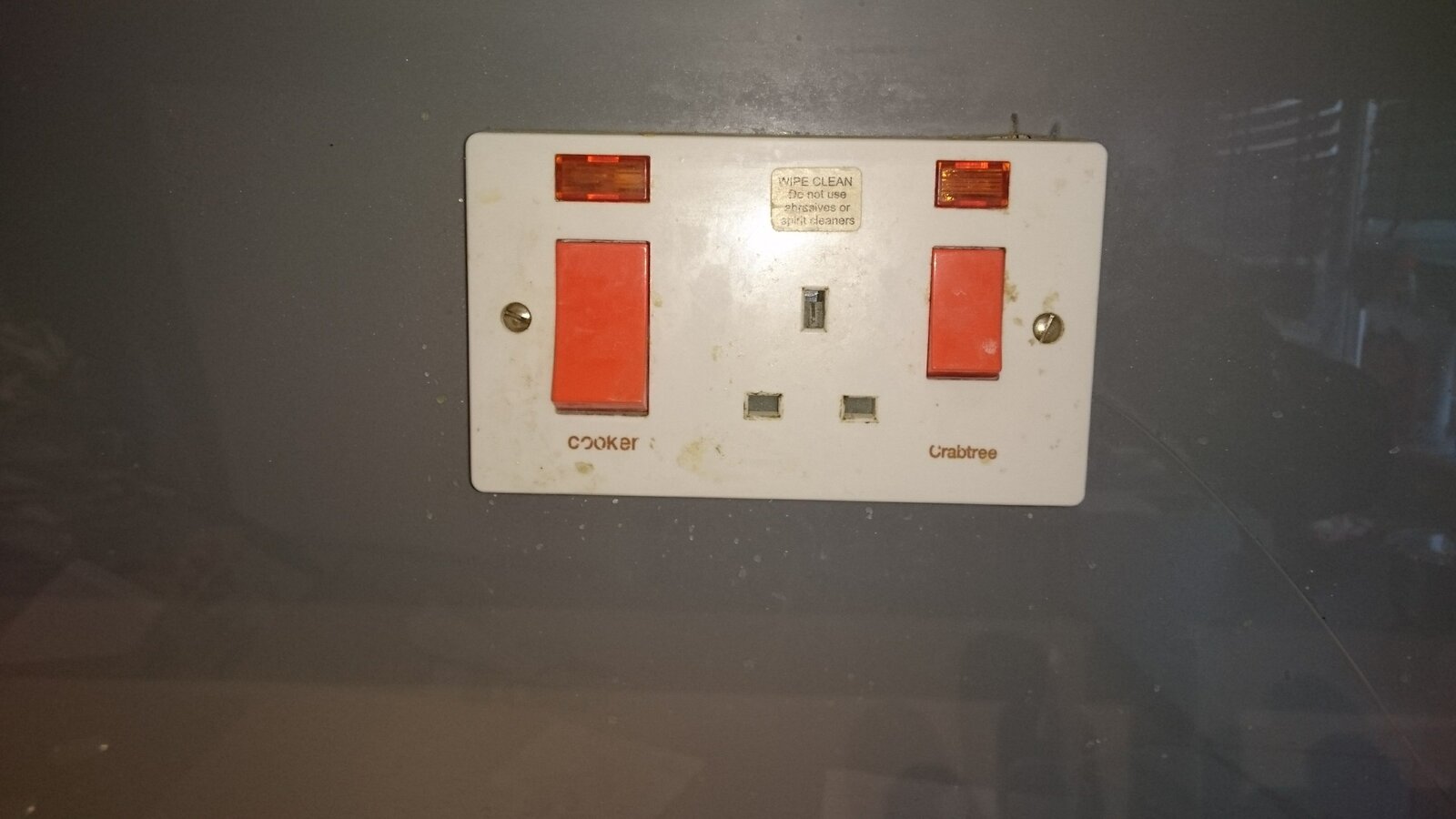

The new oven is rated at 3.6kw. The manufacturer states that "it needs 16amps". The cooker came with a cable that ends in bare wiring. My cooker and hob sockets are connected to a control panel as pictured.
I understand that the only way to know if my wiring is good enough is to find the thickness of the cable. I can't see any writing on the grey cable.

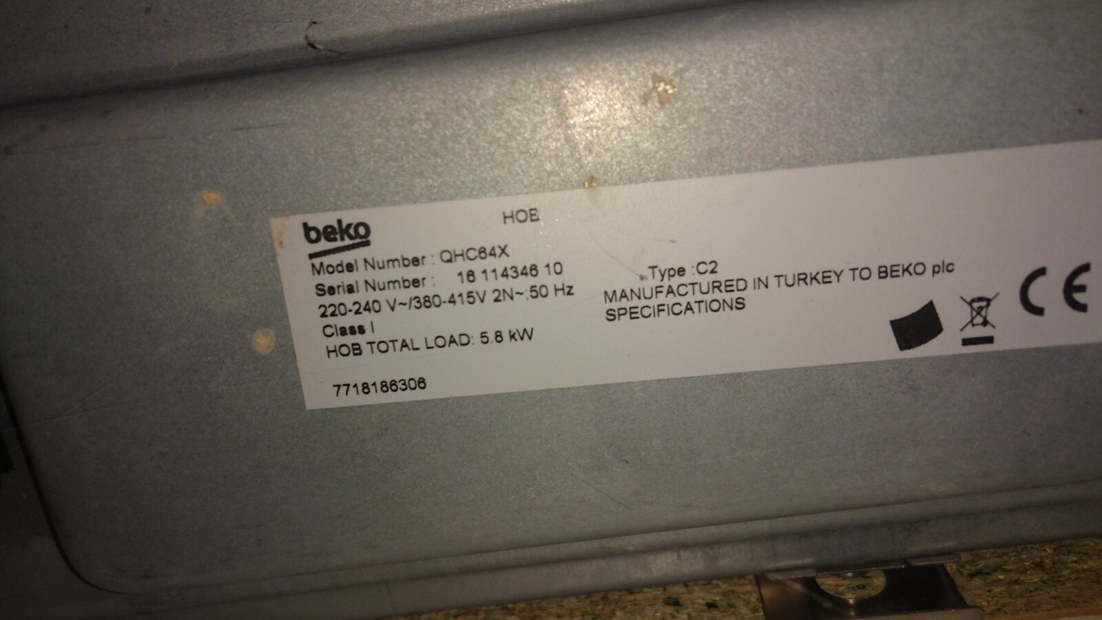

The hob states it is 5.8kW which is 25A which is too much for a plug/socket and the 1.5mm² cable - although neither looks damaged by overheating.

Can you get a clearer image of the electrical rating plate of the hob?

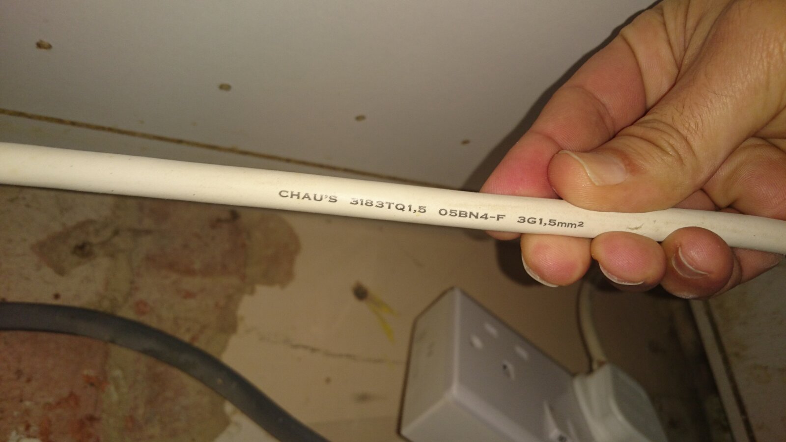

Maybe a photograph of the inside of the hob plug would give us a better idea of the cable size.
1.5mm2 flex.
It appears to be 3 core.

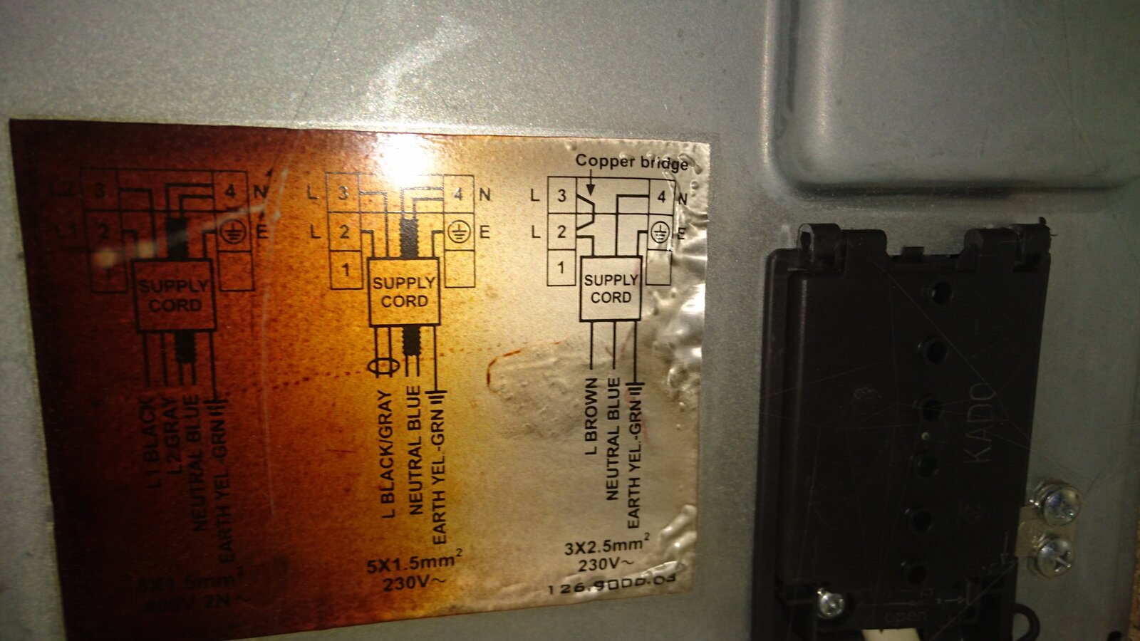

As seen on the middle picture, you can use 5 core 1.5mm2 flex but not 3 core.
I can only assume you use just one or two rings at a time, if the 13 amp fuse in the plug hasn't blown.
Best follow EFLI's advice, and remove the socket, and connect the two appliances as he described - changing the hob flex for 3 core 2.5mm2 heat resistant flex.
Be sure to connect the hob correctly, as shown in the diagram using 2.5 3core flex.

Yes, I only use two rings at a time, but only God knows how many rings the previous occupants used (or they replaced a blown plug just before putting the house on the market). I'm looking to replace the hob in the near future so I used the existing hob cable (yes, it is only 3 core, 1.5mm, but I will be replacing the flex with the correct one tomorrow when the store opens). Are electric hobs usually around 5.8 KW or is this one unusually high?

The cooker outlet will fit on a one gang flush back box because it doesn't matter that it overlaps a bit.
