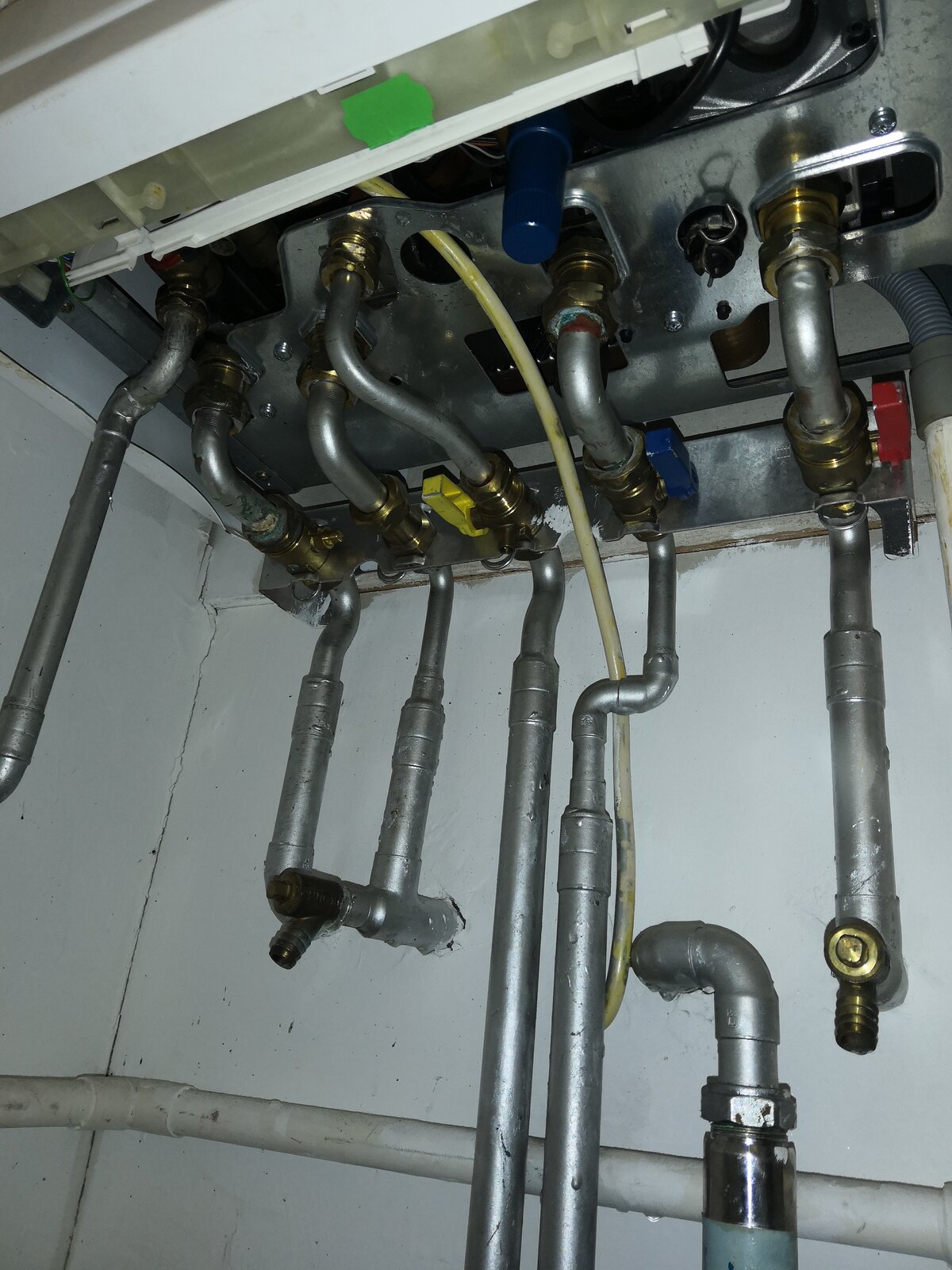

Hello,
My boiler wasn't working earlier, it had a pressure of 0.4 with a flashing red light. I've turned it off, left it for a while and put it on, it's now working with a pressure off 0.6, how do I increase it myself?
I've attached an image.
Thank you for and help
Grip the blue round knob under the boiler and turn gently (clockwise as viewed from above the boiler, anticlockwise viewed from below) until you can hear water passing into system.
Turn knob back when 1.2 bar reached.
