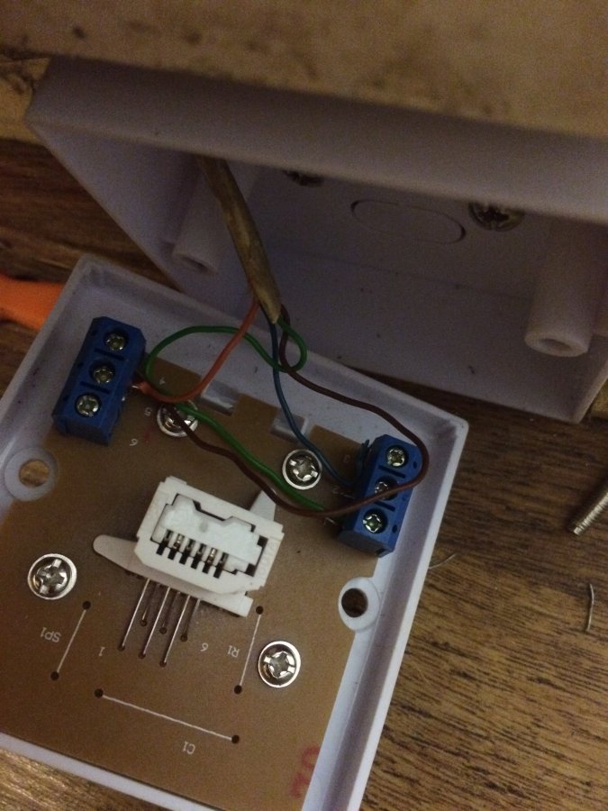

How do I re wire bt phone socket
9 Jan 2016
I have changed by box and have forgotten where the wires go. The colours are brown, blue, orange and green.
Can some one please help .........
Assuming that it was wired the usual way, blue to 2 and orange to 5 connects the line. The usual convention was brown to 3 for the ringer (green to 4, though not normally used), but some conversions to the new jacks with this older-style cable were done with brown & green the opposite way around.
You could check the other end of the extension to be sure.
