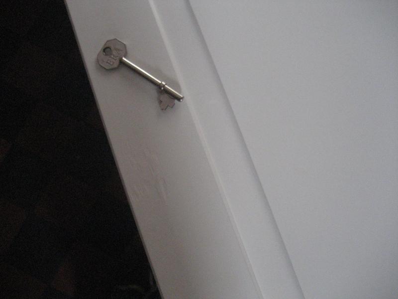

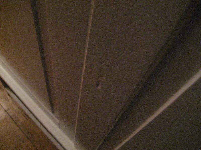

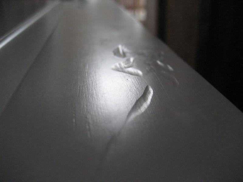

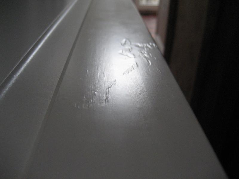

Hi group, moving house soon so I advertised my bedroom wardrobes locally, sold them and carried them down 3 flights of stairs which was no mean fete, however I caught one of the wardrobes on the newel post, I don't think dent is the right word but you can see from the photo's the damage I've caused. The buyer is coming to collect tomorrow so would really appreciate any advice on how to remove, or lessen the damage.

Damp flannel or towel, steam iron (not too hot, just hot enough to steam) apply iron on top of flannel and steam.
I don't reckon it will make much difference though, damage looks too deep and I am not sure what wood (or wood-like substance) the wardrobe is made of.
HTH
i too would try the wet towell and the iron trick,but do be aware if its plastic type laminate it could well lift.

Thanks, harbour Nigel & gregers for your positive advice, it does have a plastic look about it, but at the same time you can see the grain in the wood, I will try your tips, but I'll do it some where discreet first, once completed I will post the results.
Kindest regards Otto

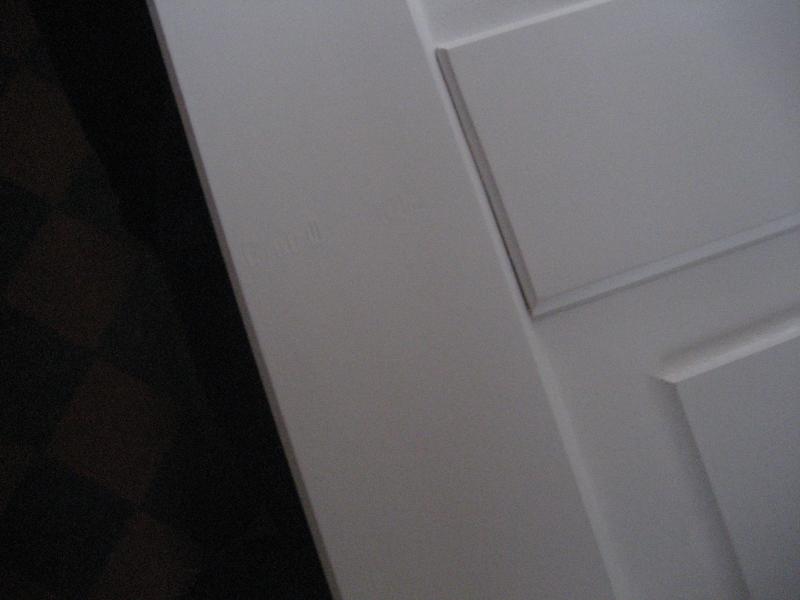

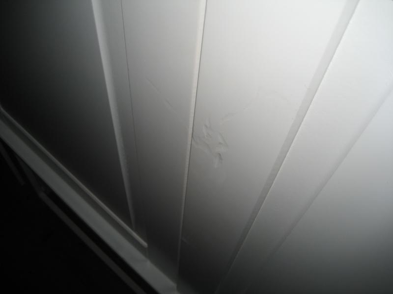

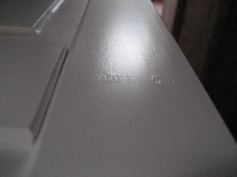

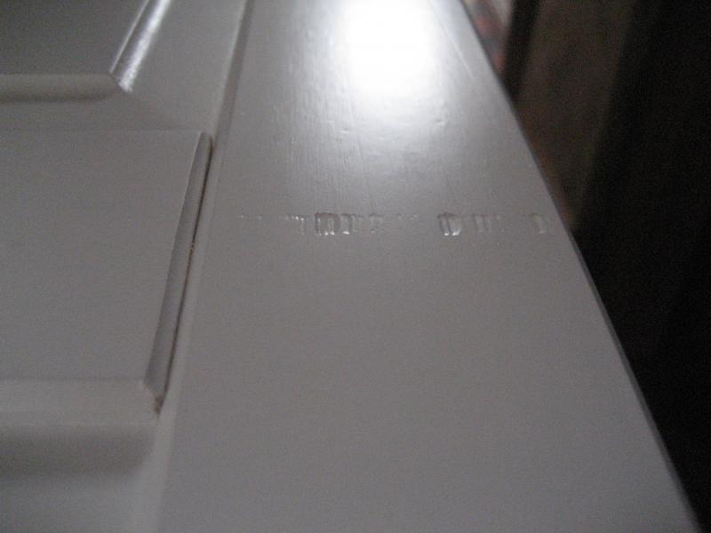

Well I think it went OK, definitely better and less pronounced, did it on the other wardrobe door which had been hitting a bedside cabinet for the past 2 years with equally as good results. Thanks again guys for the advice, its now stored in the memory bank.

Before
After
Before
After
