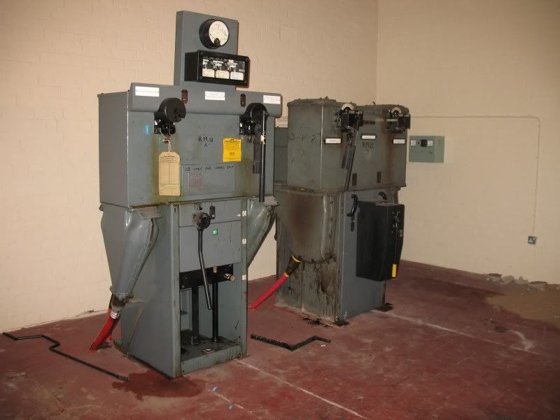

In Scot Power most urban areas are on an 11 or 6kv ring
As a matter of interest, just how much 6.6kV distribution still exists in that area? I remember seeing some statistics for this area (former Eastern Region) some months ago which suggested that 6.6kV now accounts for only a tiny percentage (less than 5%) of all local distribution.
the remaining 6KV or even 6.6Kv areas are in Merseyside for the SP DNO area and that has had a lot of uprating work carried out....I am not aware of any going on at the moment, however, the priorty seems to be to get a certain type of 50 year old RMU's off the system due to them having a switching ban due to failures.....the one on the right is the major culprit...
