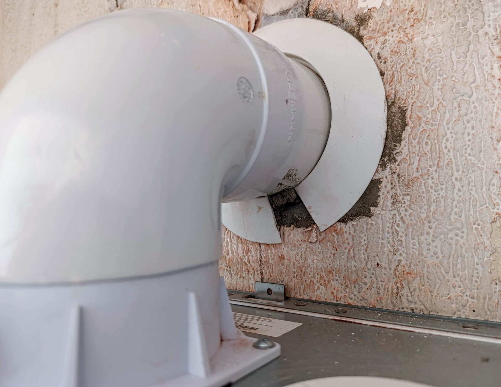

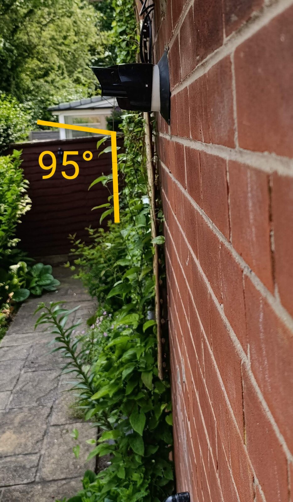

Our new combi boiler install (gas safe registered engineer, contracted by national firm) has its flue pointing 5 degrees up from horizontal. Presumably increasing the risk of condensed vapour dripping back toward the boiler.
This also means the outer collar does not sit flat to the wall, leaving small gaps. For rain or gases.
The inner collar has been cut leaving a one inch gap! (I imagine he couldn't get it to fit flat).

Before you jump to conclusion, check the manual as to slop of flue
You are imagining wrong, naughty of the chap but you are assuming too much. Have seen this collar not even fitted at times
Post a picture of that collar please

Does look a tad iffy to me.
Certain boiler manufacturers ask for a flue fall back to ensure that the flue condensate does run back to the boiler. Others have the fall back built into the standard flue, so the flue is then fitted horizontally.
InterGas MI -
The horizontal wall terminal must be installed level as the flue terminal already has a 3 degree rise built in. If the use of flue extensions are needed then they must be fitted with a 3 degree fall back to the boiler and have a bracket fitted ever meter to support the flue
Vokera MI -
The flue system should have a minimum of 1º; maximum of 3º rise from the boiler to outside, to ensure any condense fluid that forms, is allowed to drain back to the appliance.
As long as the annular space between the flue and the wall is sealed with a suitable medium (e.g. mortar) then that's ok. To meet the regs a flue should be sealed internally and externally but the internal wall collar isn't too important. Looks like he forgot to put it around the flue when fitting so has cut it and then fitted it, seen it many times, he could have been neater about it though TBH.
Thanks everyone. I tracked down a Viessmann flue MI which says ≥3 degree fall (50mm per metre) toward the boiler, so it sounds okay. I think building the fall into the flue is much neater - I'd never seen a slope like this before.
