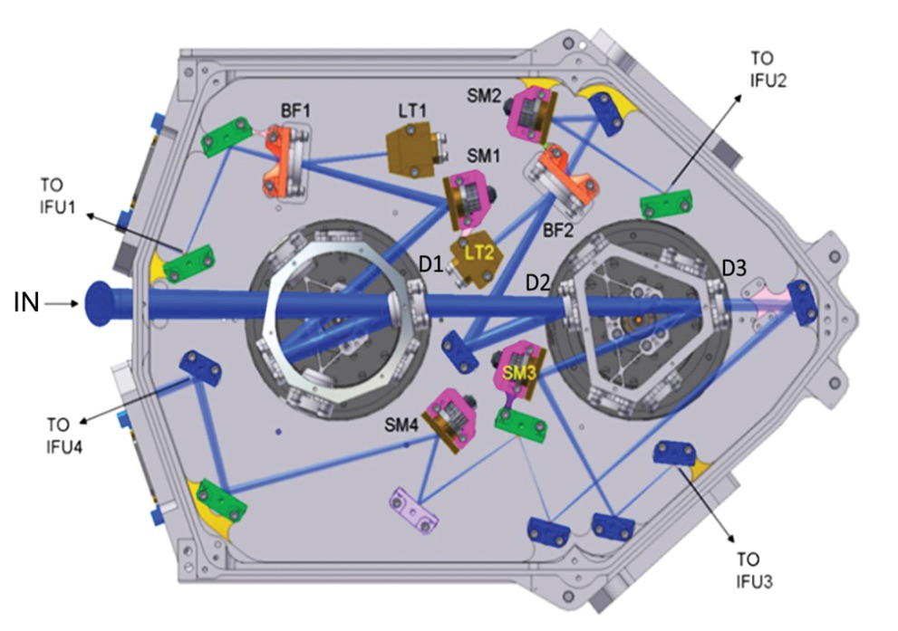

The Web is actually a 4 mirror off axis system. All mirror means no chromatic aberration problems. One it seems is flat.
The paper on that page gives more explanations,
I think we all know a parabola and a sphere are different - no idea why you bother to type stuff like that in every post.
You say there are 4 mirrors - well this is one of the more "coo" illustrations:
