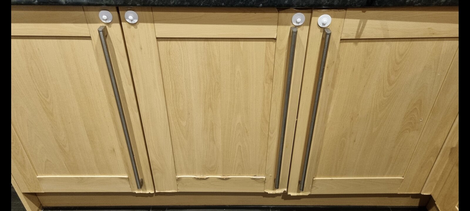

Thanks all for the replies.

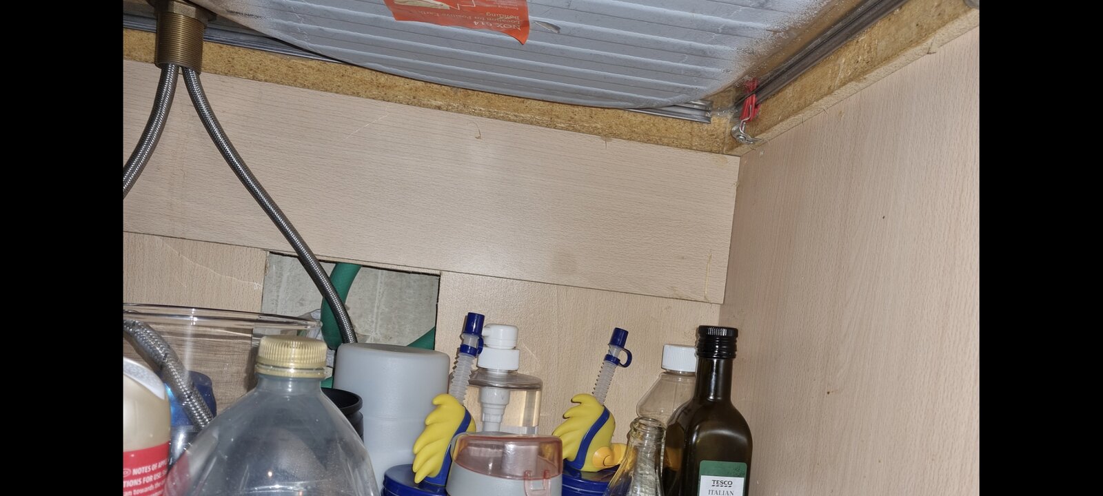

The picture below shows the cupboard I want to take the back out of.
Please ignore water damage on the front
If that is the unit beneath the sink it won't come out, as I said above, because the rear stretcher/bearer will foul on the sink bowl preventing it doing so. There is also, normally, a lot of plumbing in the way. So the best you can do is to cut the back out (in which case I will guarantee stuff will fall down the back)

The options you have with a sink cabinet are limited:
1. You can remove the plinth, but that only gives very limited access
2. You can empty the cabinet out then cut the back out, but that means an awkward repair to fix it afterwards (if it can be fixed)
3. You can disconnect the sink from the sink waste and water supplies, remove the sink and drainer, then pull the cabinet out. This is a very labour intensive process and you may find it difficult to get things back together depending on your level of experience.
If it were me I'd go for option 2. I've made and fitted kitchens, and I think I'd hesitate to go option 3 myself.
