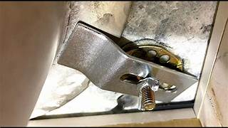

Usually clamped and sealed/stuck.
There are normally bolt plates that are either epoxied to the underside of the surface and then lever clamps are bolted to them or in the more Higher end fittings there are holes drilled in the quartz/granite/stone/wood and then threaded anchors are screwed/glued in and then the clamps/brackets bolted to them.
All of them though will have an adhesive/sealant run around the lip to ensure it's watertight
View attachment 339691View attachment 339692View attachment 339693

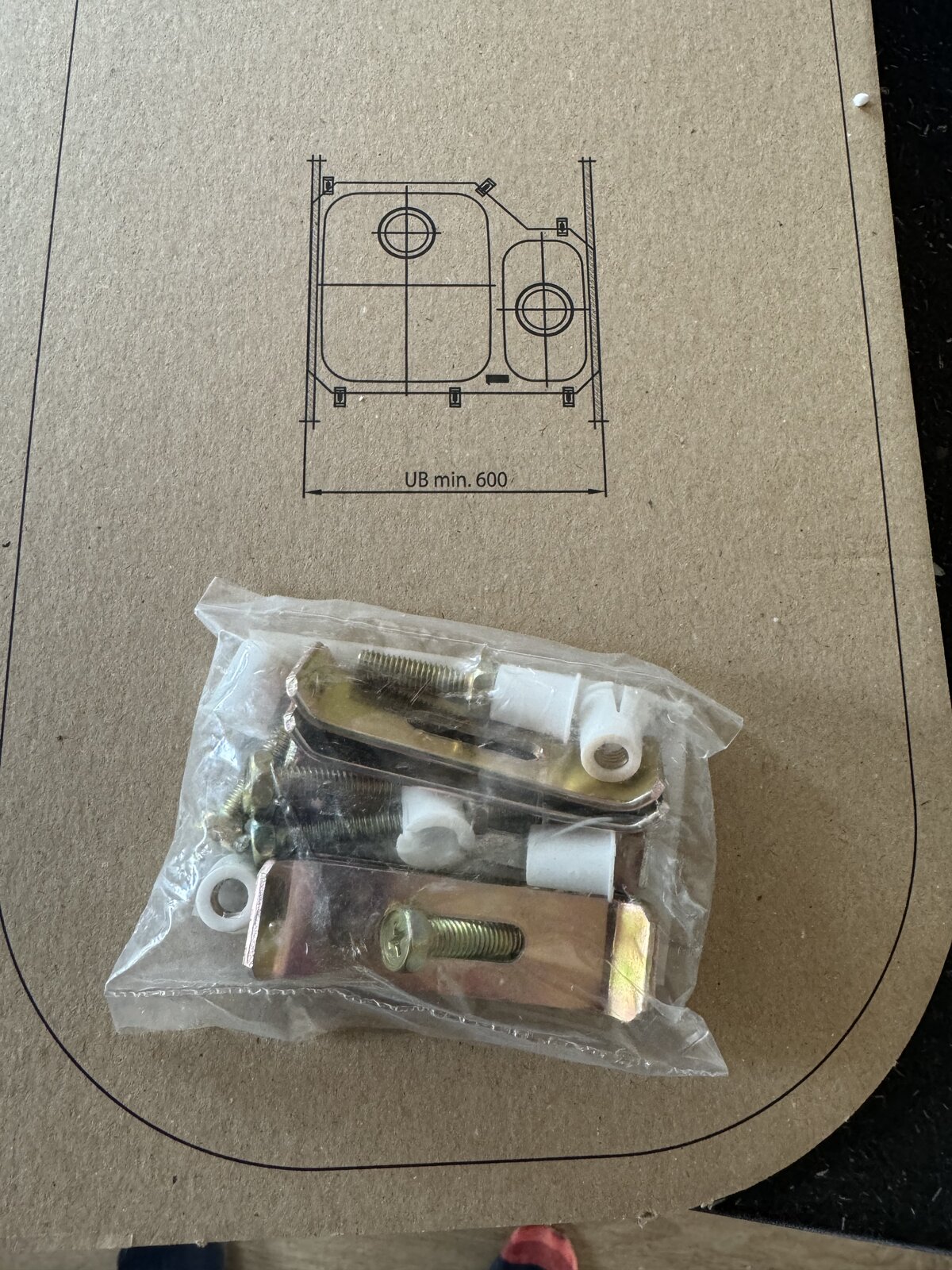

Thanks. So, if I have my sink to hand when they come round to make the templates of the worktops, will they include the fitting holes for me or will I have to drill them myself?
Last few I've done the worktop fitters also fitted the undermount sink and put grooves in the granite as a drainer at the sink position.

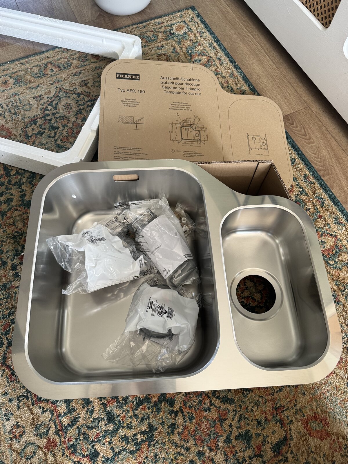

Bought this today. Looks like holes need drilling into the Quartz to fit the threaded inserts into. I hope the worktop people can drill the holes for me. If not, is it easy to drill into Quartz?

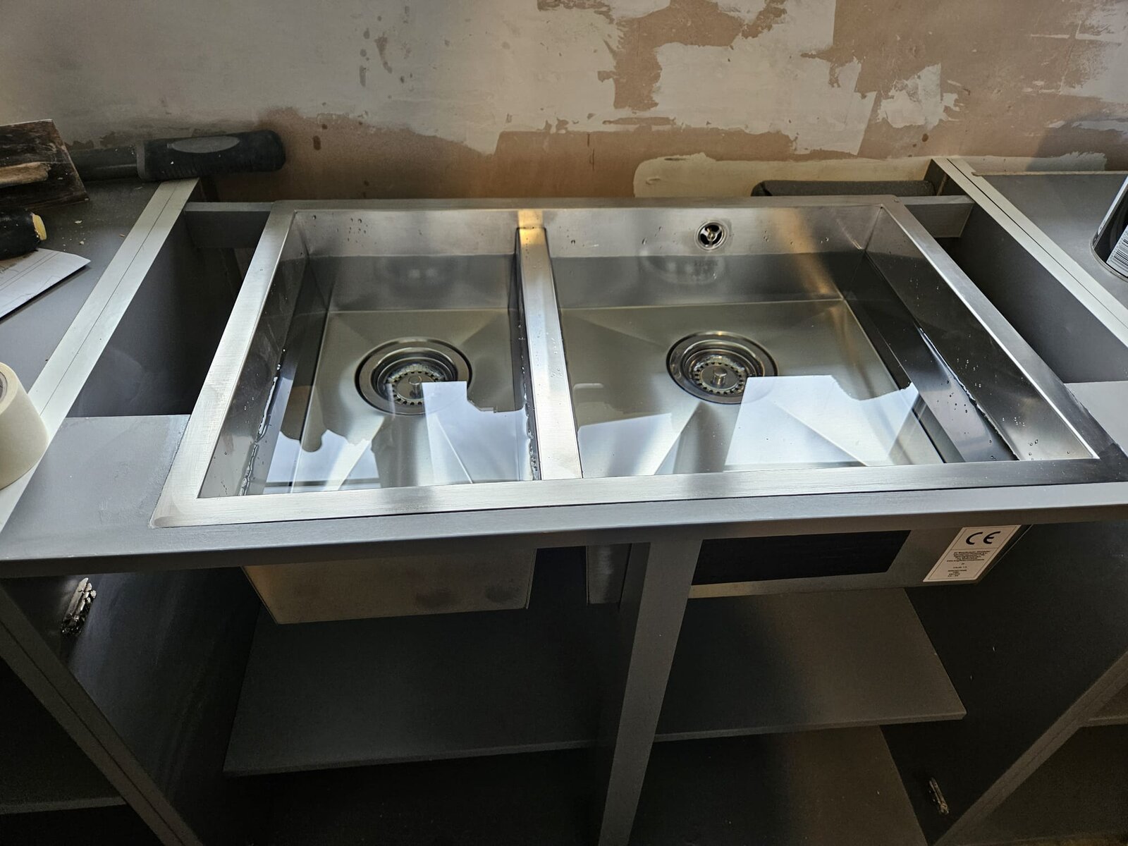

I had my worktop fitting last week, they wanted the sink in place so they could get the measurements absolutely perfect.

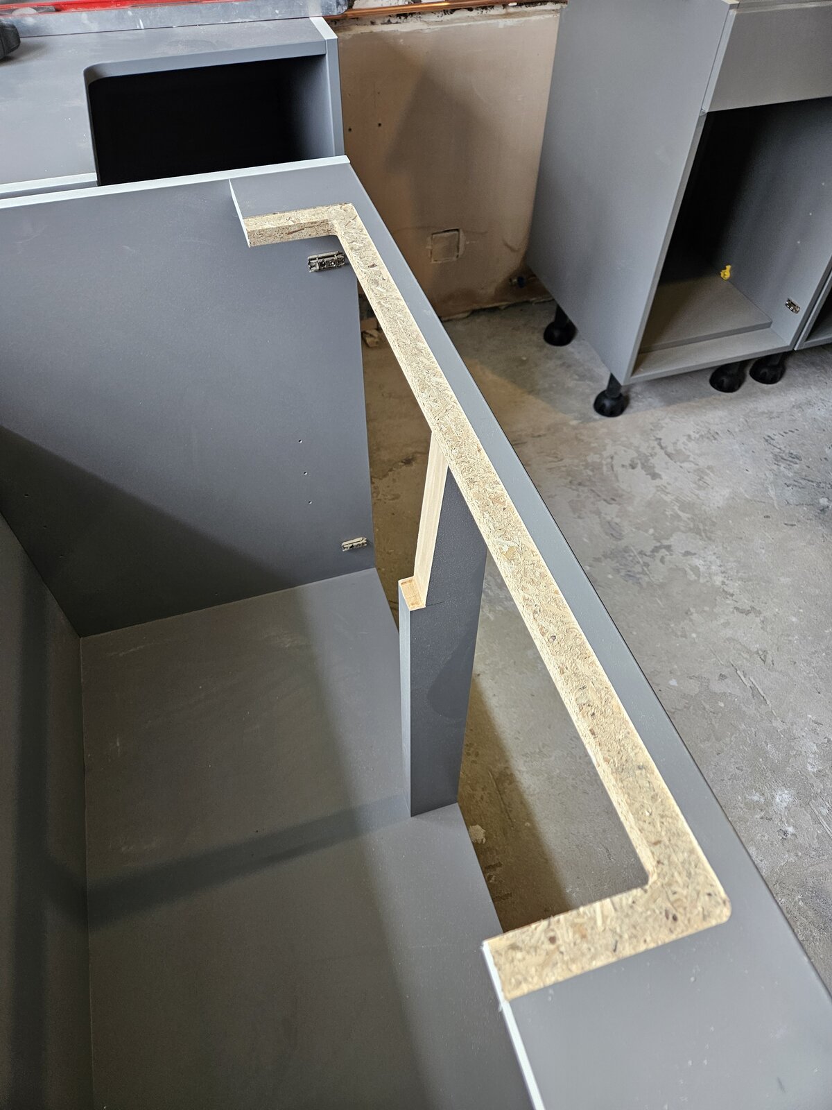

As shown in the photo I routed out a mm from the top of the sink unit to take the depth of the stainless steel, and fitted a wooden batten across the rear of the unit for the back of it to rest on.
I then fitted the waste pipes, stuck it down with silicone and filled the sink to weigh it down whilst it set in place.
This cooke and lewis (aka B&Q) sink came with some brackets and screws, but no way to attach them to the stainless steel and no useful instructions...
I'm not fussed though, it's stuck in place, it's enclosed with timber and will be weighed down and sealed when the quartz is fitted, so there's no way on earth it's moving...
Apart from the fact I don’t have a router, I don't think I’ll be able to do that with mine because of the irregular shape.
