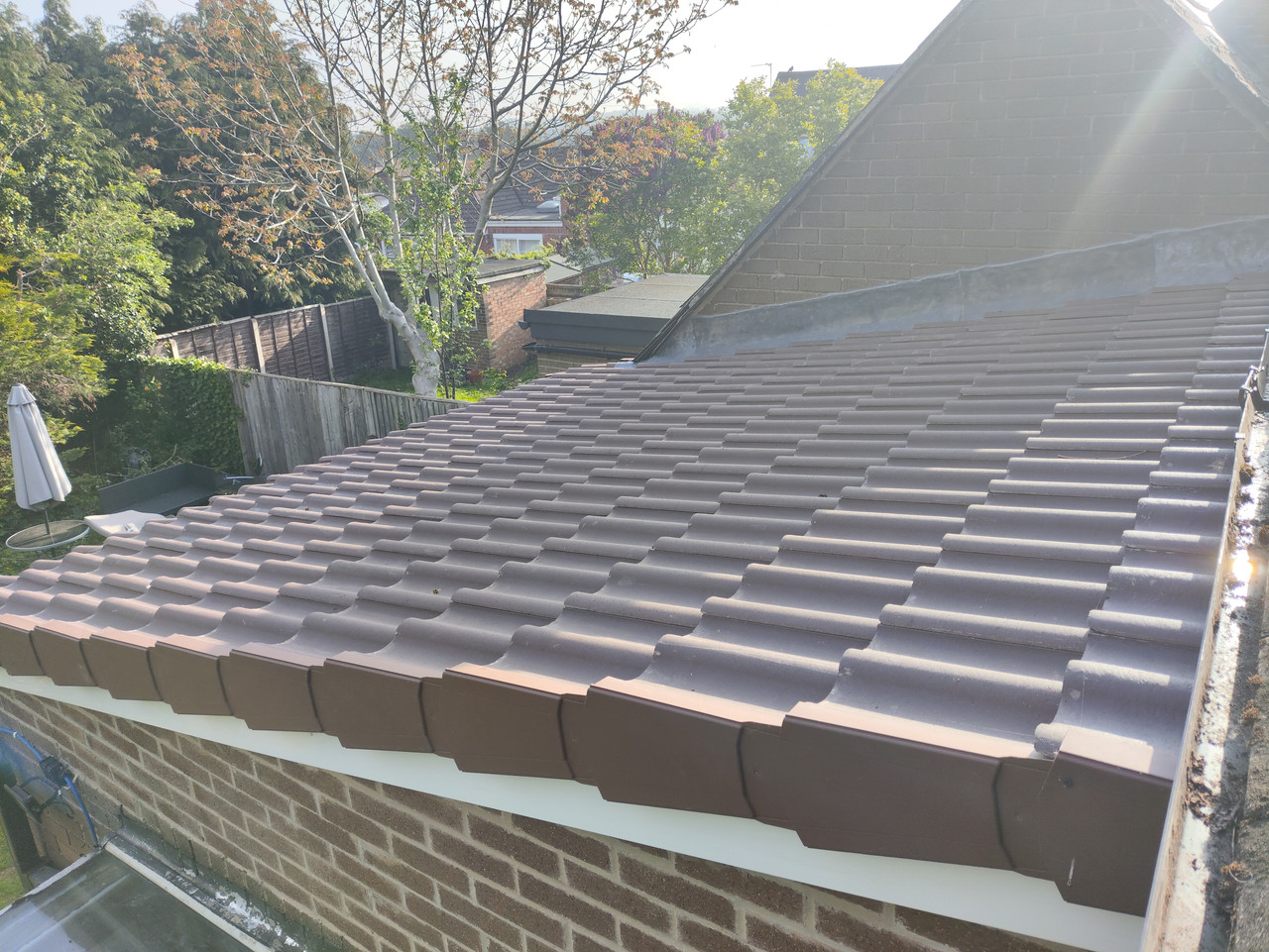

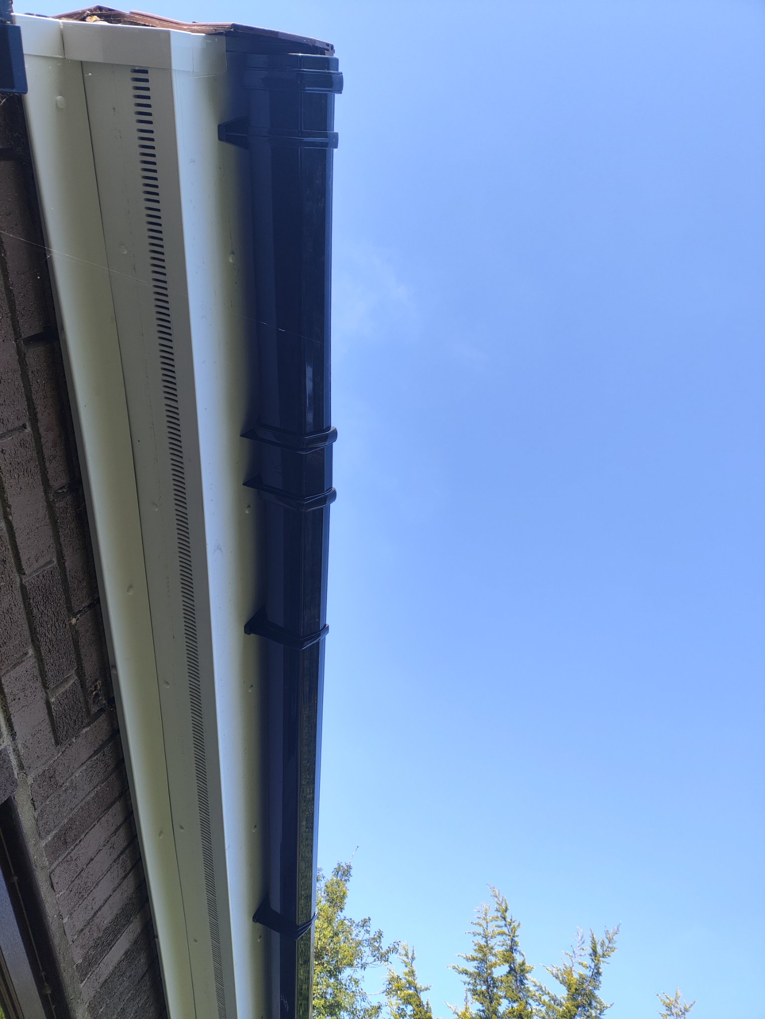

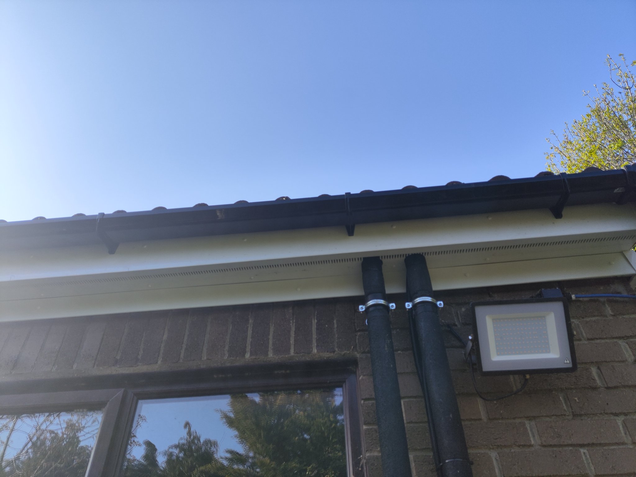

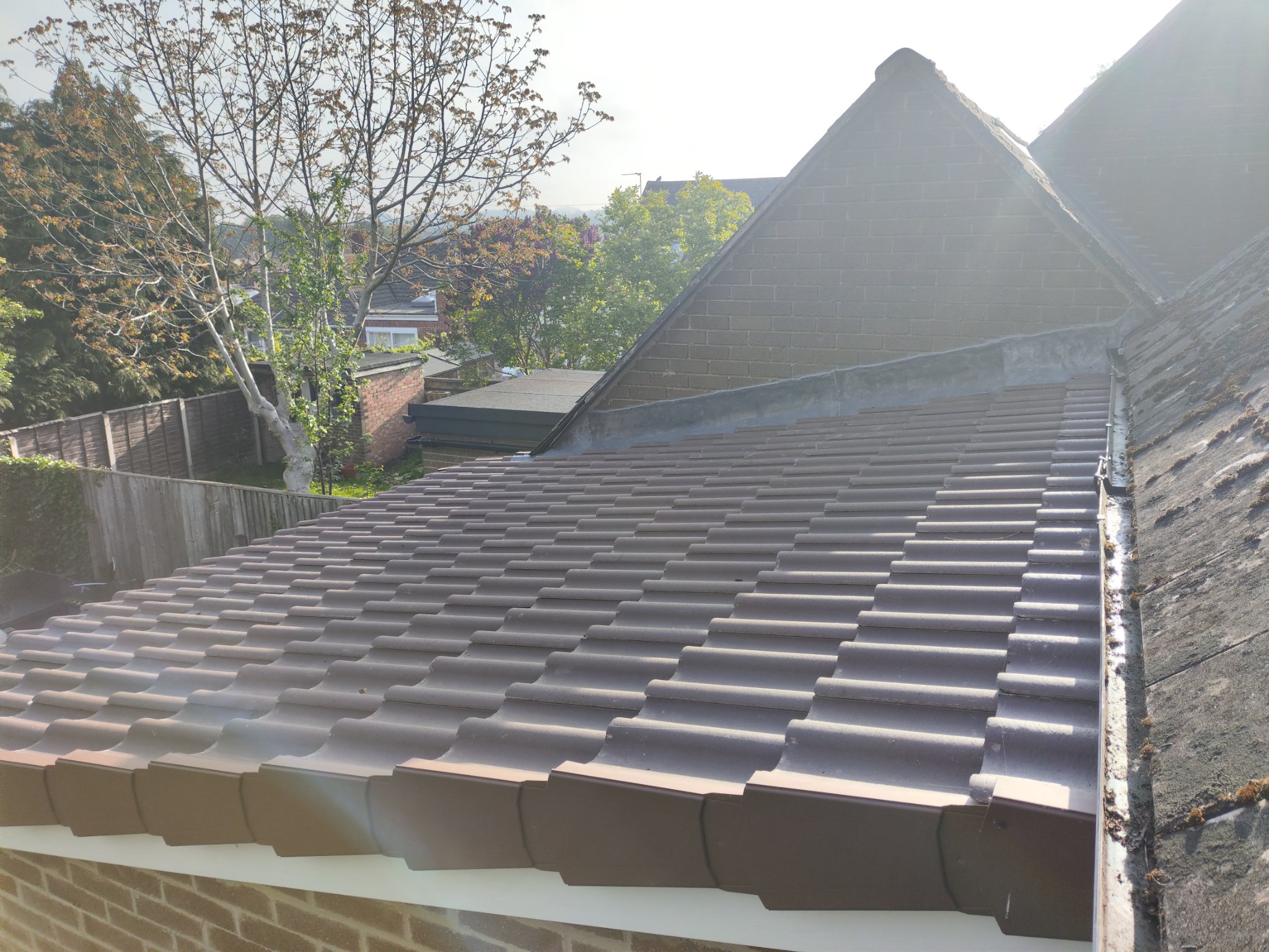

My nan had a roof replacement. There were some irregularities during the whole process and neither of us are too well versed in this.
To your trained eye, how is the workmanship of this? Please let me know if it's absolutely dog****.

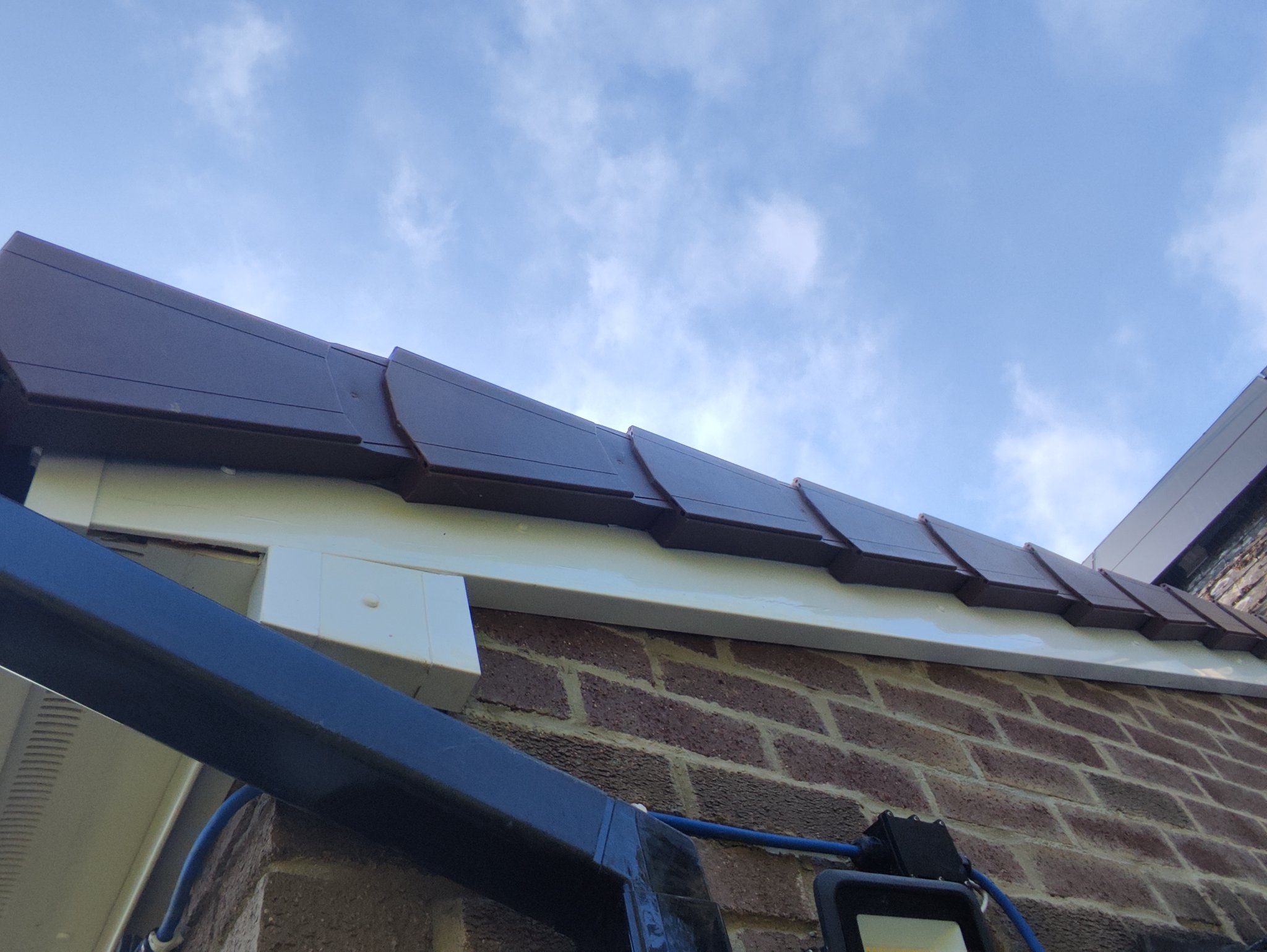

This needs further attention, it's going to come off in the wind.
OP,

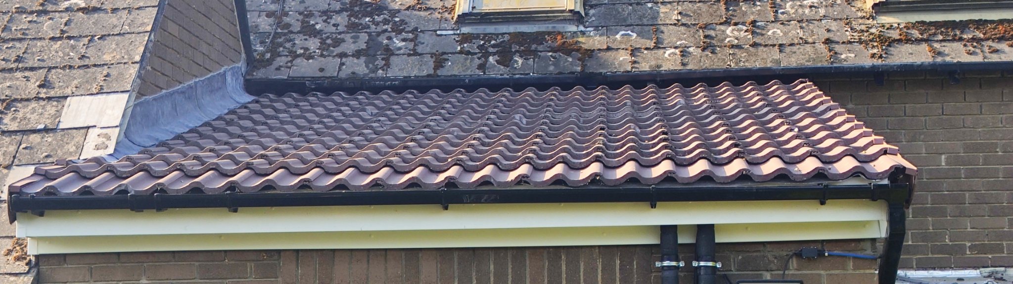

Thats not a professional roofer's job - but, with provisions, it looks as though it will keep the rain out.

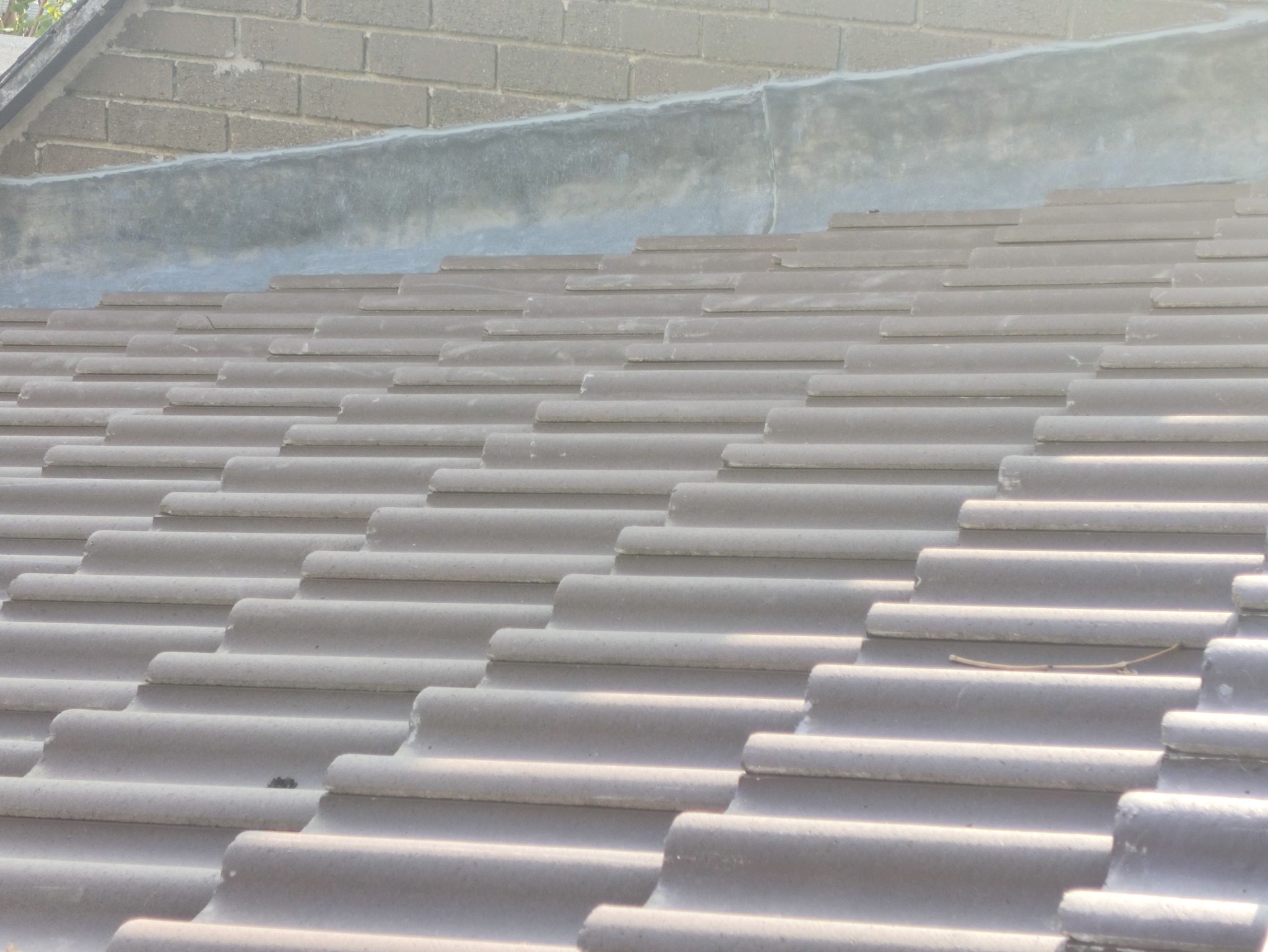

The abutment flashing appears to be stuck on with silicon or some kind of sealant?
One-piece step & cover flashing would have been the way to go.

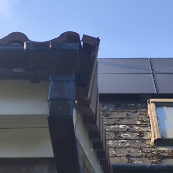

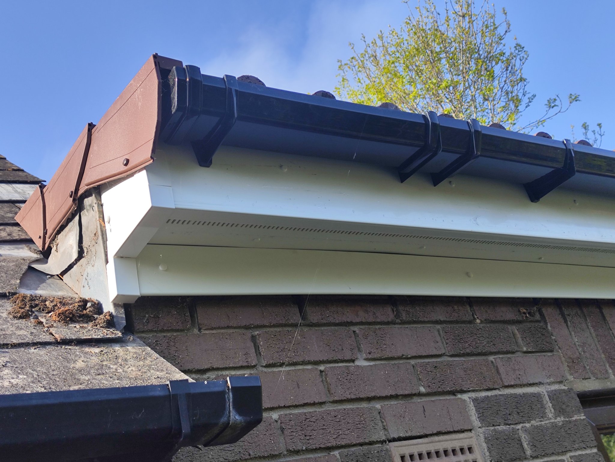

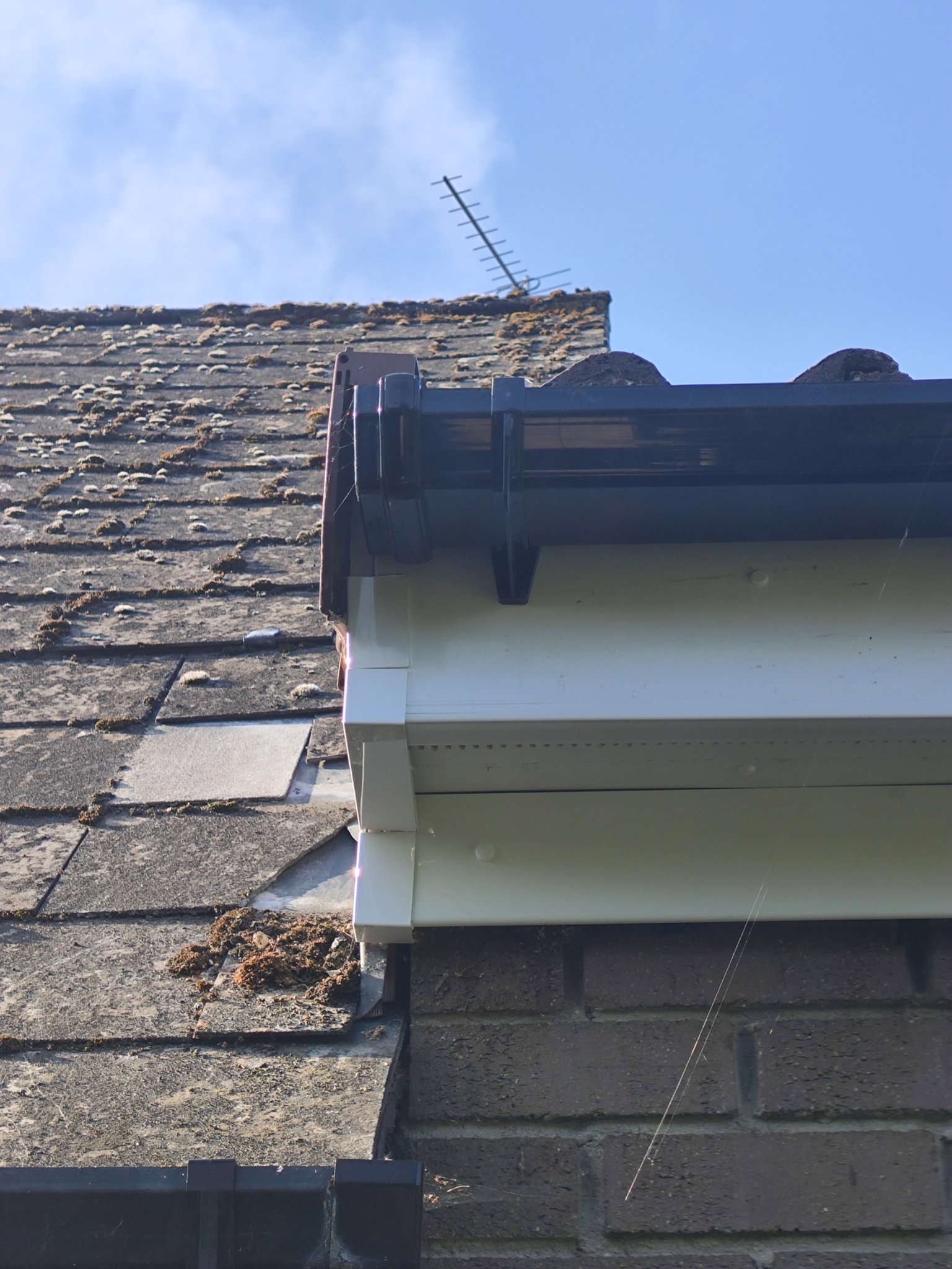

The LH verge return is confused and needs attention - the dry verge seems odd, and the flashing and tiles are not right.

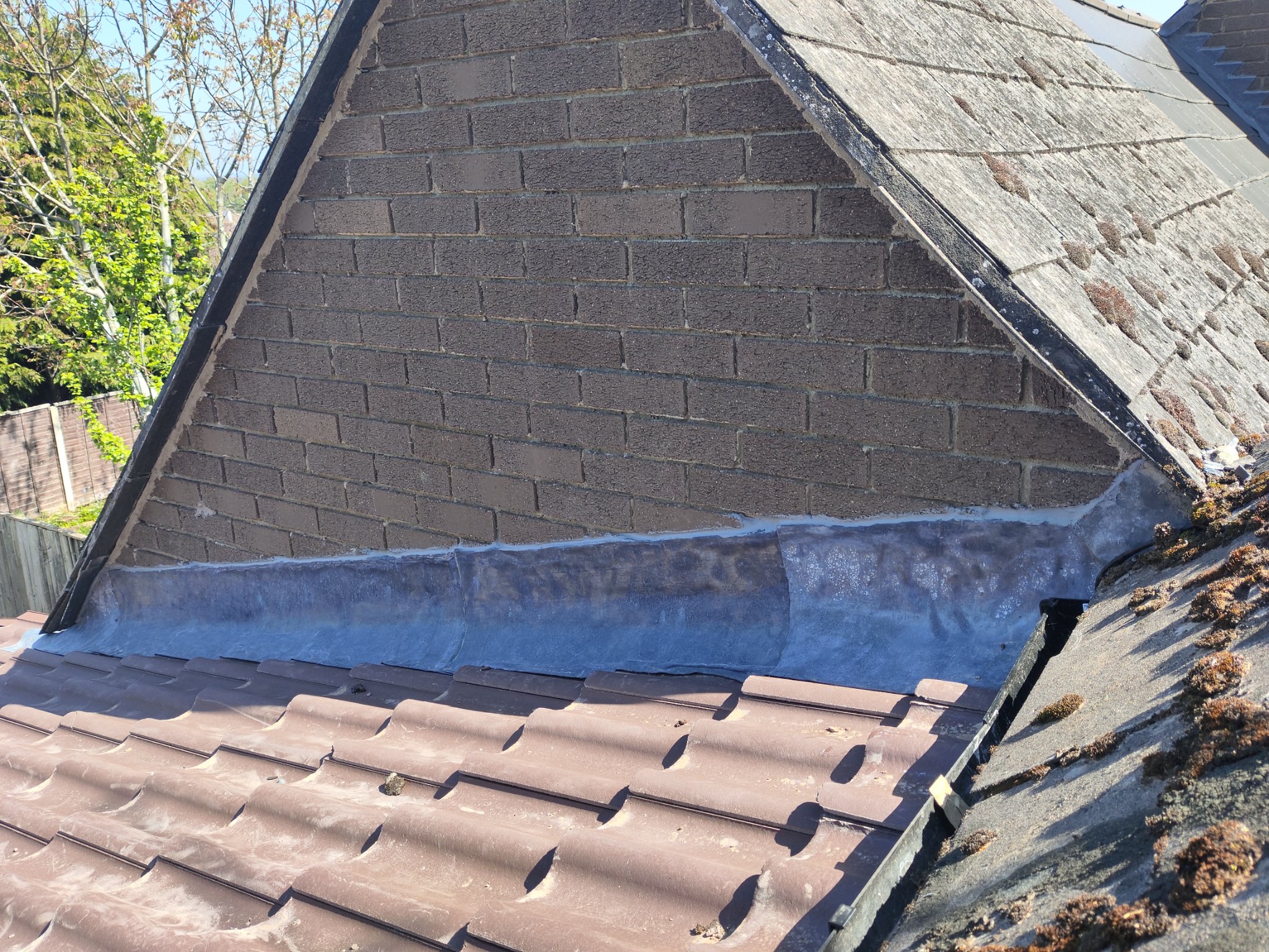

@robinbanks are you able to tell based on this photo? Is this a bad flashing job? Thank you!

Did they break the neighbours tiles on the left hand side?
The flashing is awful but probably functional. Looks like code 3 rather than code 4, but difficult to tell from a photo. It should have been stepped with the brickwork like this. In the second image you will see render at the bottom of the lead run, where the chase is straight. That's how (incorrectly) they have done yours. Lazy.

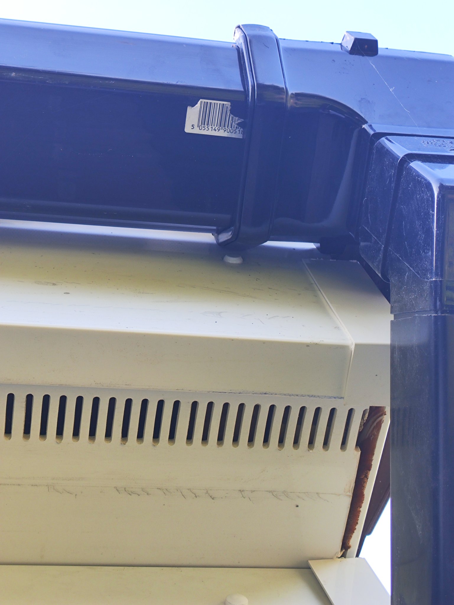

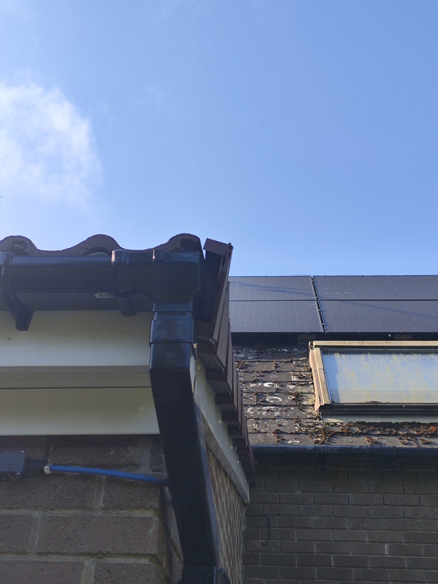

Thanks @noseall. Please could you comment on other aspects too? E.g., dry verge, tiles, soffit, fascia, bargeboard etc.?
