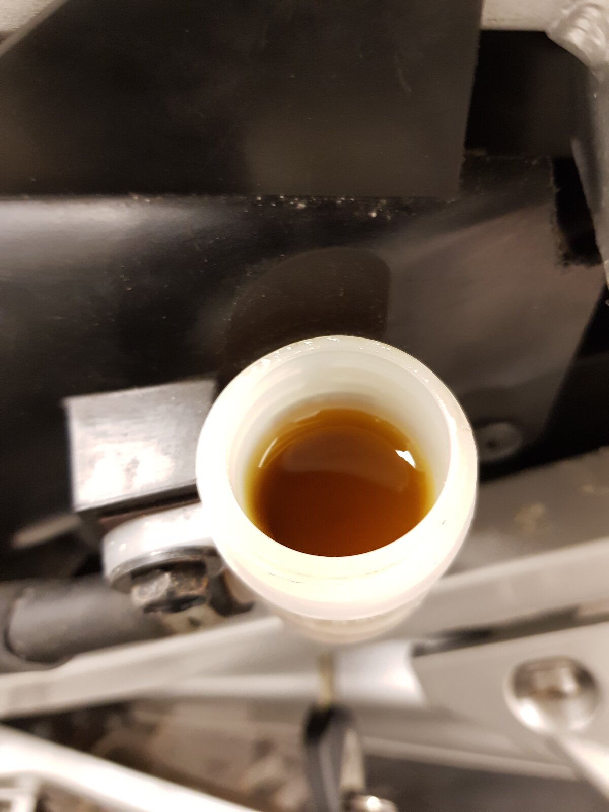

try this mate :sneaky:
dscn2996small-jpg.636281

DOT4 discolours with age, starts off clear ends up like gravy!.
There's the boiling point issue with water contaminated brake fluid but also the internal corrosion of the brake caliper bore and pistons etc. A car just doing deliveries at 60mph tops won't boil it's brakes but will be slowly corroding it's calipers.
This brake fluid is well past it's best, if it has a noticeable colour it's ready for changing (apart from ATE Blue/ Red etc).
