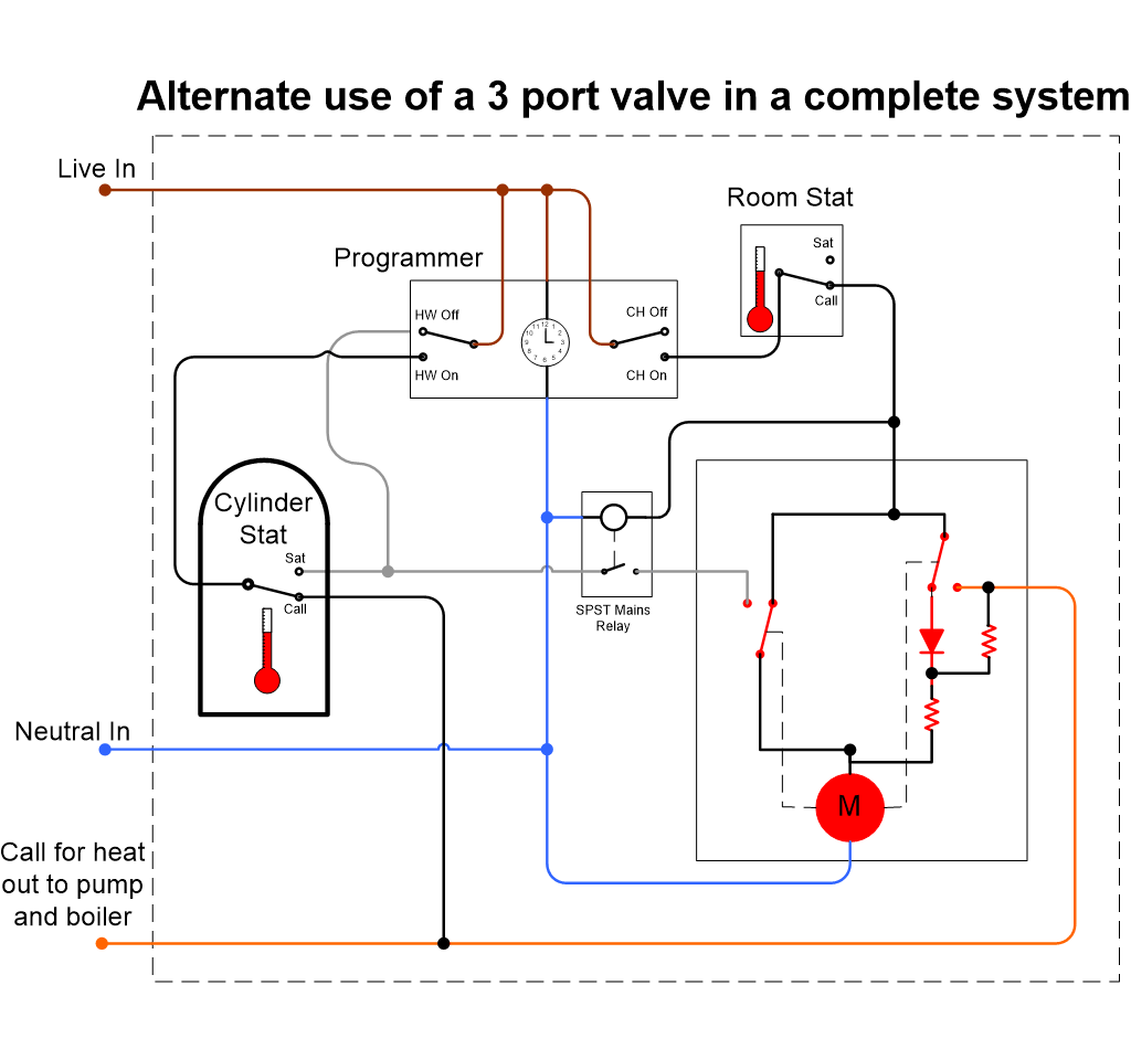

A electrician friend of mine modified his, presumably, as per attached, he has passed on but the mid position valve hasn't and must be approaching ~ 15 years now.
