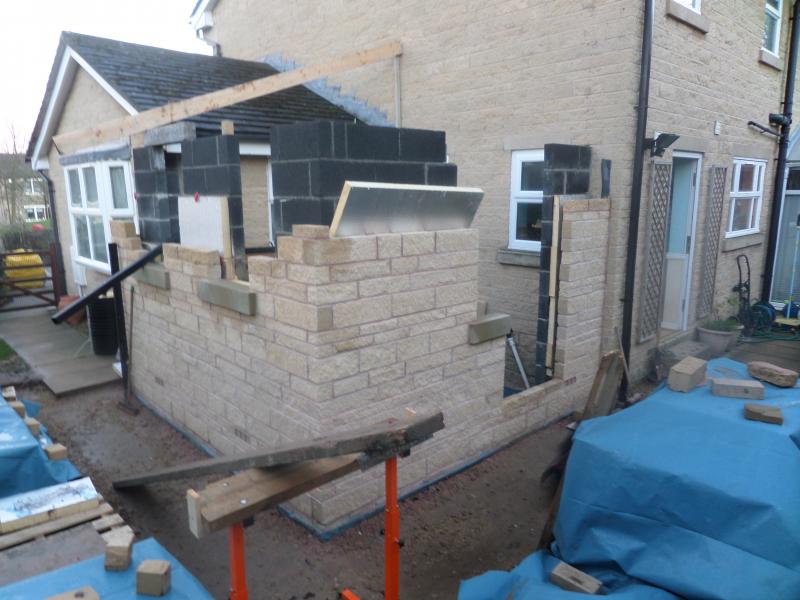

well.. the situation is as followes:-
they were meant to do the full job, but never got started... so I dug out and put in the foundations myself.. they turned up and did the blocks that got the foundations out of the ground (ive included these in the count BTW)... I then did the oversite myself and all the drains....
they have done the outer stone and the inner blocks (as the picture) fron on top of the foundation blocks, and we are as you see.. about 3/4 built to wall plate.
TBH I'm not bothered about the time it's taking to do as it allows me to save up... what does concerm me is the rate of build once on site....
as I said above... on average 7.5 mins per block!! :x

Horrific looking blocks to lay AND they are having to build a partial fill system!
Poor sods. I'd have ran a mile from that one. There is zero joy in that job.

Laying random stone is very time consuming. It not only requires an amount of head scratching time but is also difficult to cut and is low suction too. Horrible stuff.
Partial fill cavity as opposed to full fill. A lot more of a faff and adds to the time thing. I pity the brickies having to build that extension and I bet they can't wait to move on.
The stone comes in 3 sizes. 65,100 and 140 and I bought 3 lengths in each. So not a lot of cutting
On the fill, its 100mm gap with insulation? Isn't that standard?

Just thought 1 brick,stone,block every 7.5 mins was a long time... I was watching the guys at work building our new factory. They are on 80p a stone and they fire them in 😉
Looking at the picture, I wouldn't have thought it comparable with building a factory. Looks a pretty neat job.

zoom in... for some reason I have pink cement??... cast ends showing.... sills out of centre and out of square.... blocks not covered and hit by frost that I'm taking down... etc etc... no, it's not the best.....
and communication with them is imposable.. I think it's this that gets me more than anything!...

bit late now but if you buy red sand, against the light colour it will look pink

Per your topic heading seems you've been using brickies to do stonework, although it seems to be 10mm joints? So more in the brickies territory (2mm or 3mm joints is more common for stonemasons). Even so, its a random pattern which would be more what stonemasons are used to in e.g. "random rubble" or "coursed rubble" walling which they do with relative ease.
