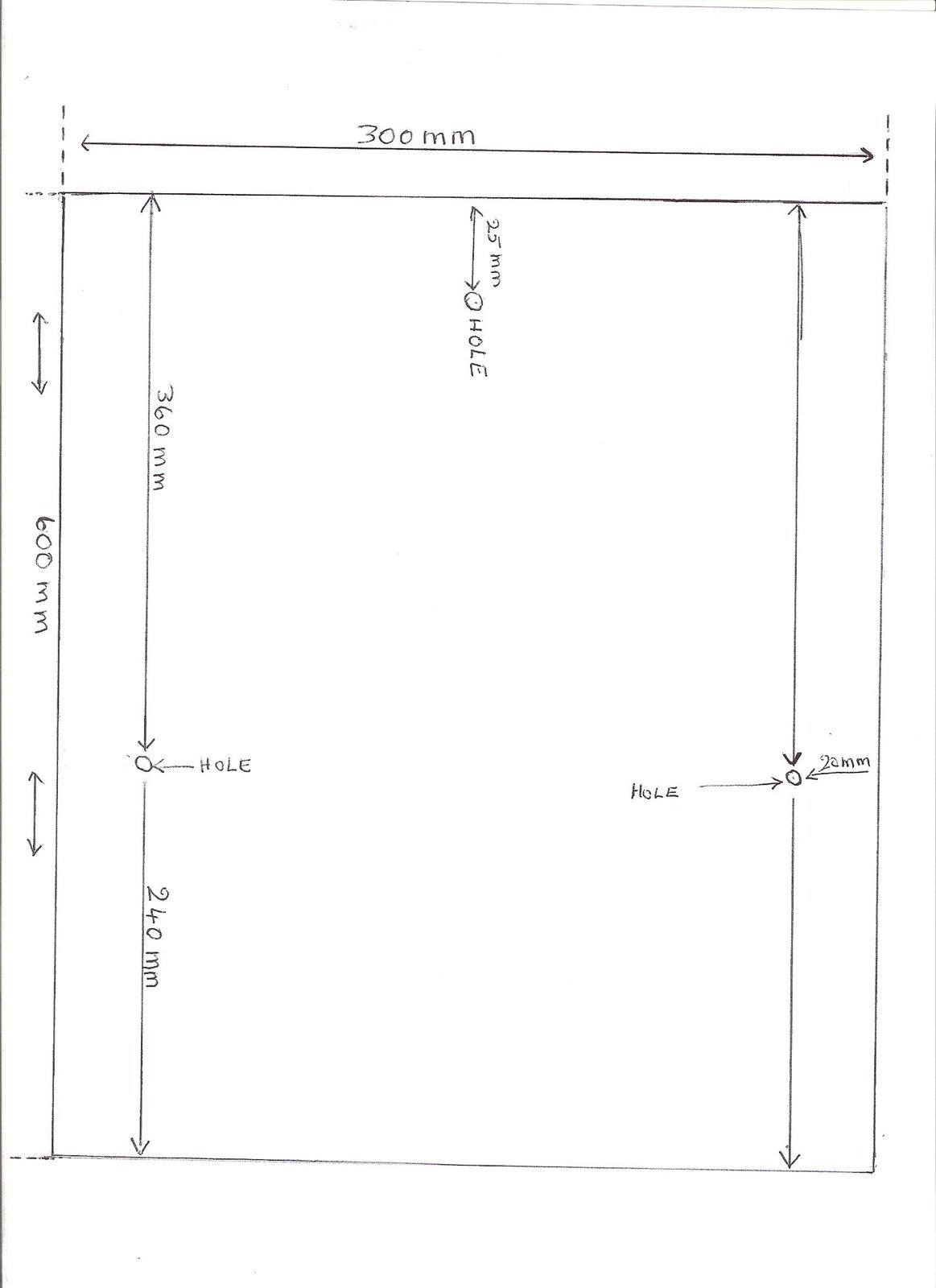

Hello
I am aware that the sizes of Roof Slates dictate the number of battens for a Pitched Roof.
I do not know how to work that out.
So I have included a drawing showing the distances between the holes in the Slate.
Please let me know if anyone can advise.
Please see drawing as attached.
Thank you.
Looks like a drawing of a cement fibre slate.
Generally a preset gauge of 250 mm for a 600 x 300 .
You are correct. It is Eternit.
