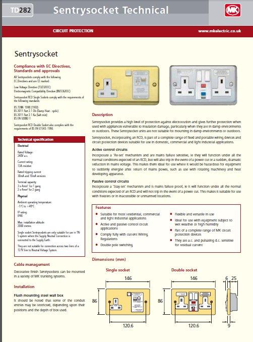

John, I don't see where you are reading any difference (apart from the BS compliance spec). Both statements posted about "only TN-S" to me say the same thing, only we yours states single sockets only, and we don't know where you got yours from. Would you mind clarifying?
The bit I posted about 9 posts back indicating that single-socket ones were 'only suitable for use with TN-S...' came from:
MK are devils for not putting dates (at least, not dates I can find) on their Technical Documents, so I'm not sure whether this one is earlier or later than the one which Lectrician posted (which didn't 'single-out' single-socket ones, if you'll excuse the pun!).
Kind Regards, John

EN 61543 is titled "•Residual current-operated protective devices (RCDs) for household and similar use - Electromagnetic compatibility". I can't see why that would apply to double SRCDs and not single.
Thanks. I wasn't suggesting that the Standard might apply to double ones but not single ones. Rather, I was wondering whether there might be something about MK's single-socket ones which is not compliant with the Standard, but that there double-socket ones were compliant with it.
As I sort-of asked, does this Standard perhaps call for double pole interruptuon as a result of operation of the RCD?
Kind Regards, John
It's not easy to answer your question about double pole interruption, since the standard has multiple amendments, and refers to several other standards that have themselves been amended. However I shouldn't think so, since that would have nothing to do with EMC.
I was also wondering if the single sockets fail the tests of the standard, or perhaps it's just that they haven't tested them yet to the newer standard.

So the Standard business is essentially a red herring, but we still have ('my' version of) the MK Technical Document in which the comment about 'suitable only for TN-s...' appears to relate only to single-socket devices.

There doesn't seem anything that can be deduced from that though.
It's applied (or so it says) in the product standard for 61008/9, from both are manufactured predominantly SP devices (for the domestic market that is).
... from both are manufactured predominantly SP devices (for the domestic market that is).
Are you sure that's true (genuine, not rhetorical, question - I don't know)? If it is, then I suppose that, as BAS suggested way back, they might be saying it's unsuitable for TT because it's a SP device.

Well most of the MCBs and RCBOs in our houses are only single pole, or at least they are in mine. They're compliant with BS EN 61008 and 9 respectively. I can't see anything to reference 61543 in those standards, but I'm not saying it isn't there (the 'secured' versions aren't very searchable) and I'm not sure how BS ENs are designed with respect to cross-referencing each other.
Certainly for isolation, but they are still OK for functional switching. If they're trying to be extra cautious though, they're the only manufacturer who would be doing so, and would drive them out of the market if they didn't clarify that statement with regards to isolation/functional switching.
In addition I should add that BS 7671 does not specify double pole switching for RCDs providing Additional Protection.
That's obviously true, but we're talking about SRCDs and, as I implied, I haven't a clue as to whether they are SP or DP (to be honest, I don't recall ever having thought about it, but probably 'thought of them as probably DP', since domestic RCDs {as in CUs etc.} invariably are)
Yes, I agree it's a fairly weak case, but I'm struggling to think of anything else about the 'earthing system' which has any relevance at all in terms of the 'suitability' of a certain SRCD.
Again, I think that's true, so it weakens the case again. However, MK obviously had something in their minds and, as you imply, felt it was sufficiently important to risk potentially having a major impact on their sales by saying it - so I guess we're not going to know the answer until someone asks them. Of course, in view of the 'no date' issue with MK documentation, we could all be looking at obsolete documents/ information, for all we know!

Well seems I have started something here. As said already lack of dates and other data means I have no idea if RCD sockets I have used were to a TT supply or MK or if MK RCD sockets were always unsuitable for a TT supply.
But with a RCBO it's quite obvious when they are single pole but with a socket one relies on some information written on the socket to tell one. Looked at Time Guard RCD socket and it states double pole. Also nothing about using on TN system only.
It would seem this is only something stated for MK RCD sockets.

Looked at Time Guard RCD socket and it states double pole....
Indeed it does - but I note that it also says "Breaking Capacity 250A". Does this mean that one should theoretically not use it if Zs is less than about 0.92Ω ? (I'm far from convinced that, in the case of an L-E fault, one could rely on an OPD in the circuit to operate before the RCD attempted to break it).
Also, I've just located a double-socket MK SentrySocket on my shelves and tested it. The RCD certainly does do 2-pole disconnection. I have no single-socket one to test, but maybe someone out there does?
