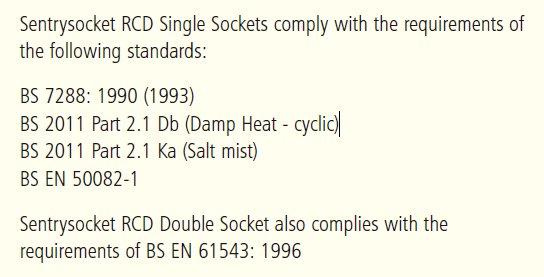

It is apparent that there is some difference between the single-socket and double-socket ones ...
Who knows about BS EN 61543: 1966? What is it about the single-socket ones that doesn't comply with that standard, I wonder? It is, perhaps, as BAS suggested, 2-pole RCD operation (it does say 'double-pole switching', but that might apply just to the switches, not the RCD!).
Kind Regards, John

John, I don't see where you are reading any difference (apart from the BS compliance spec). Both statements posted about "only TN-S" to me say the same thing, only we yours states single sockets only, and we don't know where you got yours from. Would you mind clarifying?
Who knows about BS EN 61543: 1996?
From the standard:
BS EN 61543 Residual current-operated protective devices (RCDs) for household and similar use - Electromagnetic compatibility (Introduction) said:

I guess MK must have seen a market to get these certified as compliant, but not the single-socket ones!
Kind Regards, John
Seems I'm needed here!
EN 61543 is titled "•Residual current-operated protective devices (RCDs) for household and similar use - Electromagnetic compatibility". I can't see why that would apply to double SRCDs and not single.
