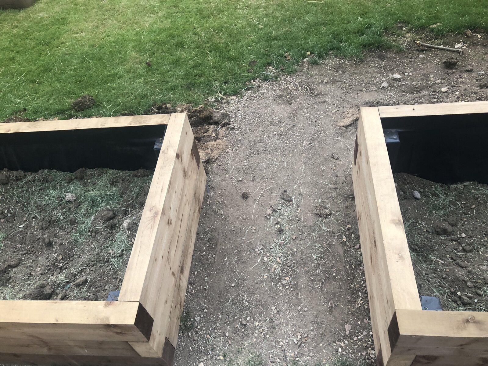

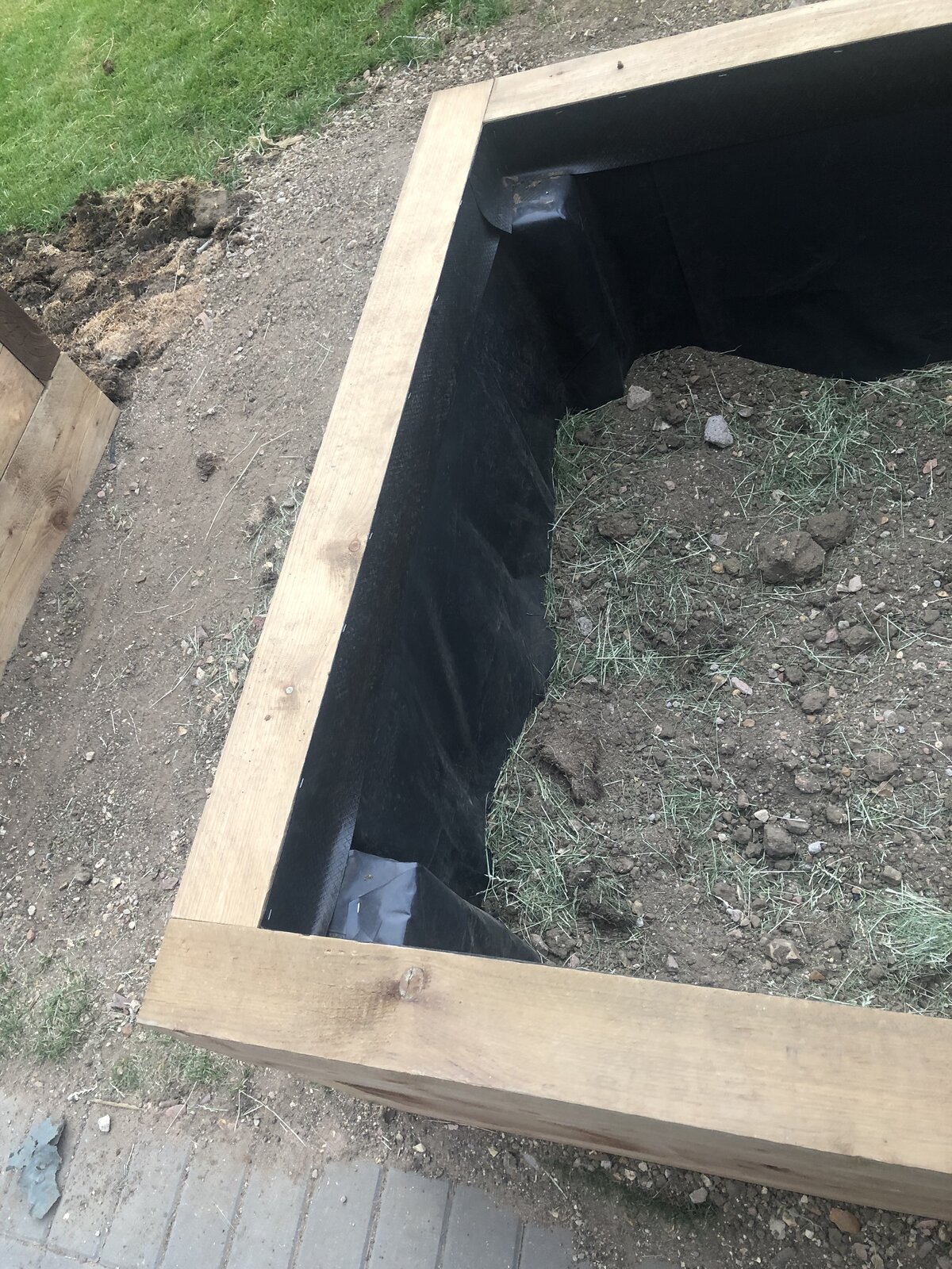

I used 50cm 4" x 4" (100mm x 100mm) posts on each inside corner to fix it all together (with 16 150mm screws in each), which means that I have 10cm of room between the top of the inside corner post and the top of the raised beds in each corner (see pics attached).
