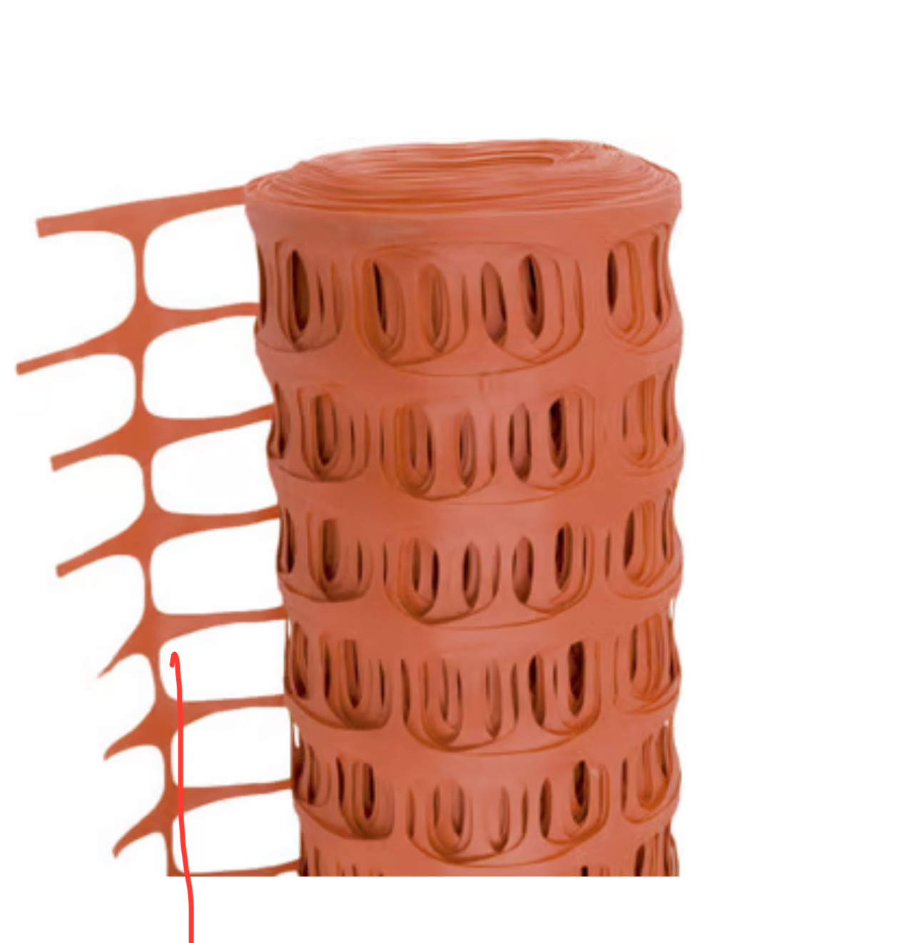

What about something like this, cut to a couple of inches wider than the joist centres. Staple it to the side of the joists so it forms a cradle?

It will depend on how snug the fit is, i.e. exactly what the joist spacing is. I have also used the orange fencing in stud walls. If crawling under a floor, I think a spool of something would be easier to work with. Put in as much as seems necessary at the time. Don’t worry about the insulation becoming more saggy later, it’s pretty stable stuff unless it gets wet.
