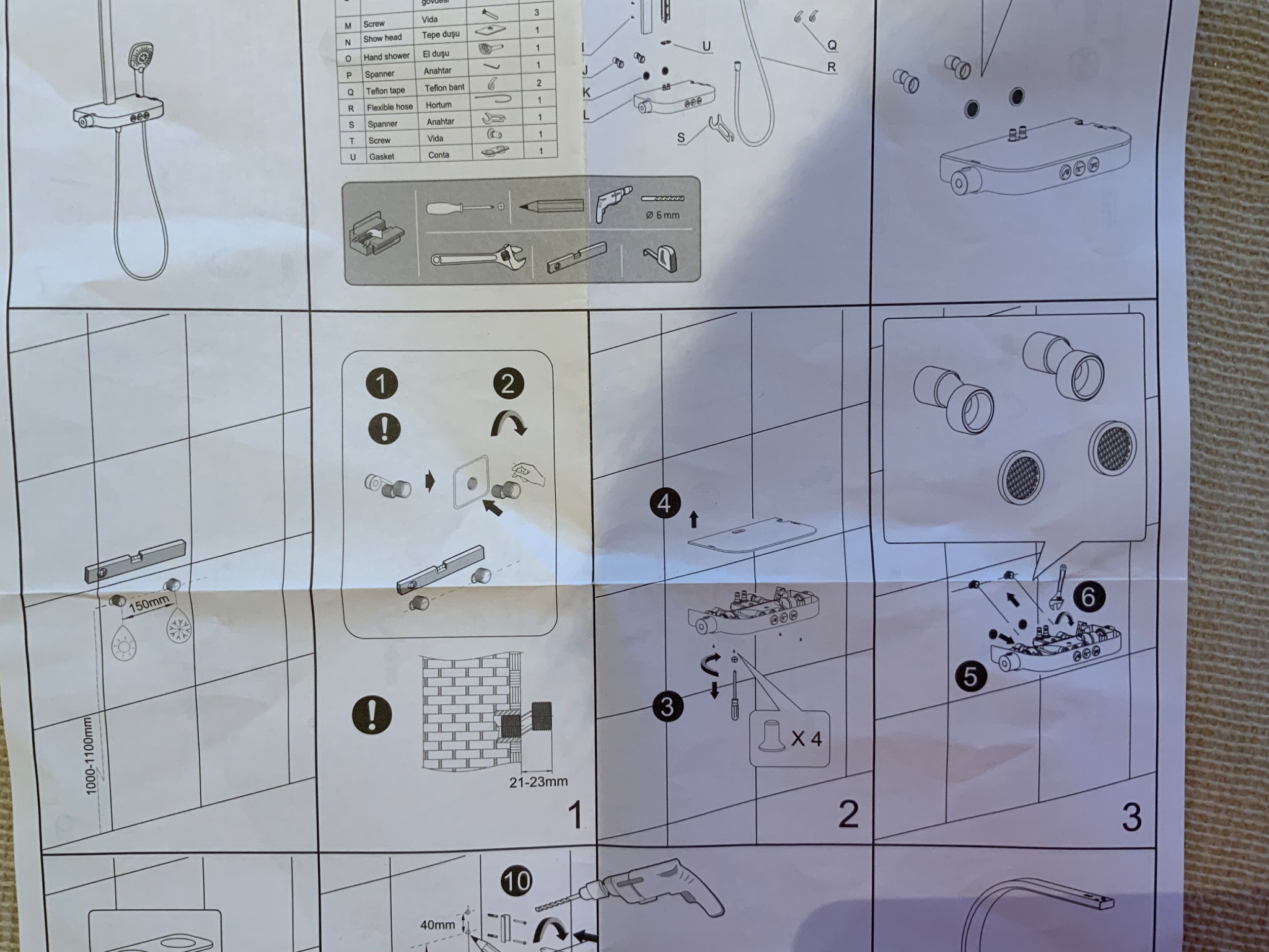

We have recently purchased a Vitra Charm 360 shower valve to install on a new stud wall in a bathroom. This is a deep exposed valve with a glass shelf on top of the valve for shampoo bottles etc. However, it does not have a separate mounting plate/bracket or any screw holes or brackets on the back of the valve. Without any of these, there is no way to attach the valve to the wall, so the only thing keeping it on the wall will be the copper pipes and all the weight of the valve (and any shampoo bottles etc that are stood on it) is on the copper pipes. We have seen fast-fix plates for bar-style valves, but these do not appear to be substantial enough for this type valve. The instructions just show the offset connectors embedded in the wall. Does anyone know how we can install it safely and securely?

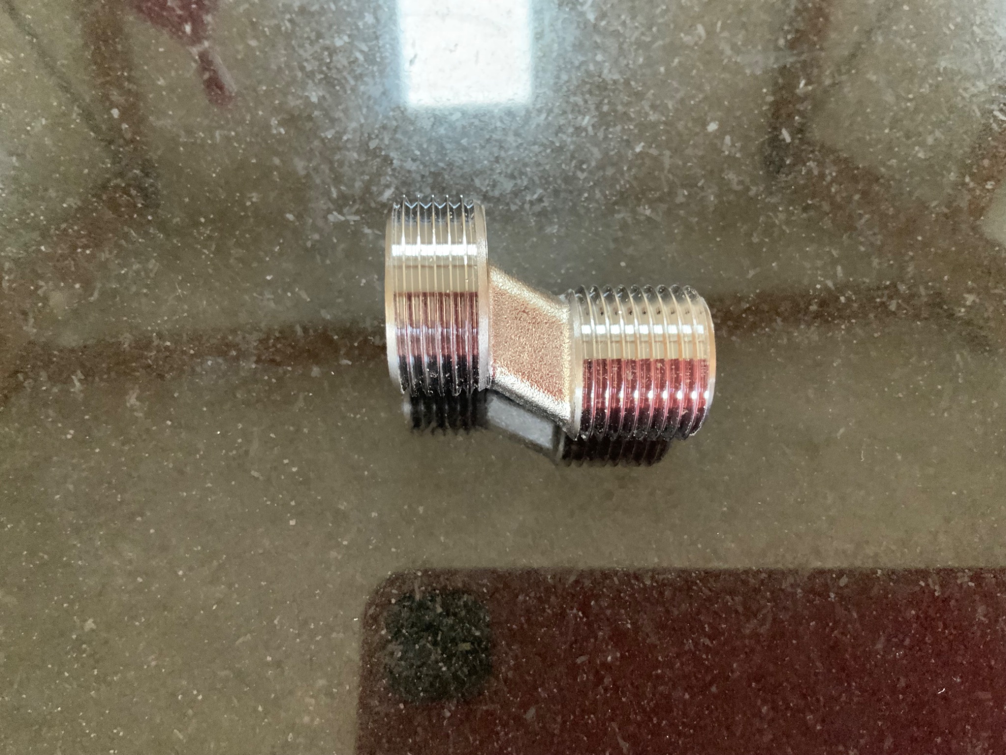

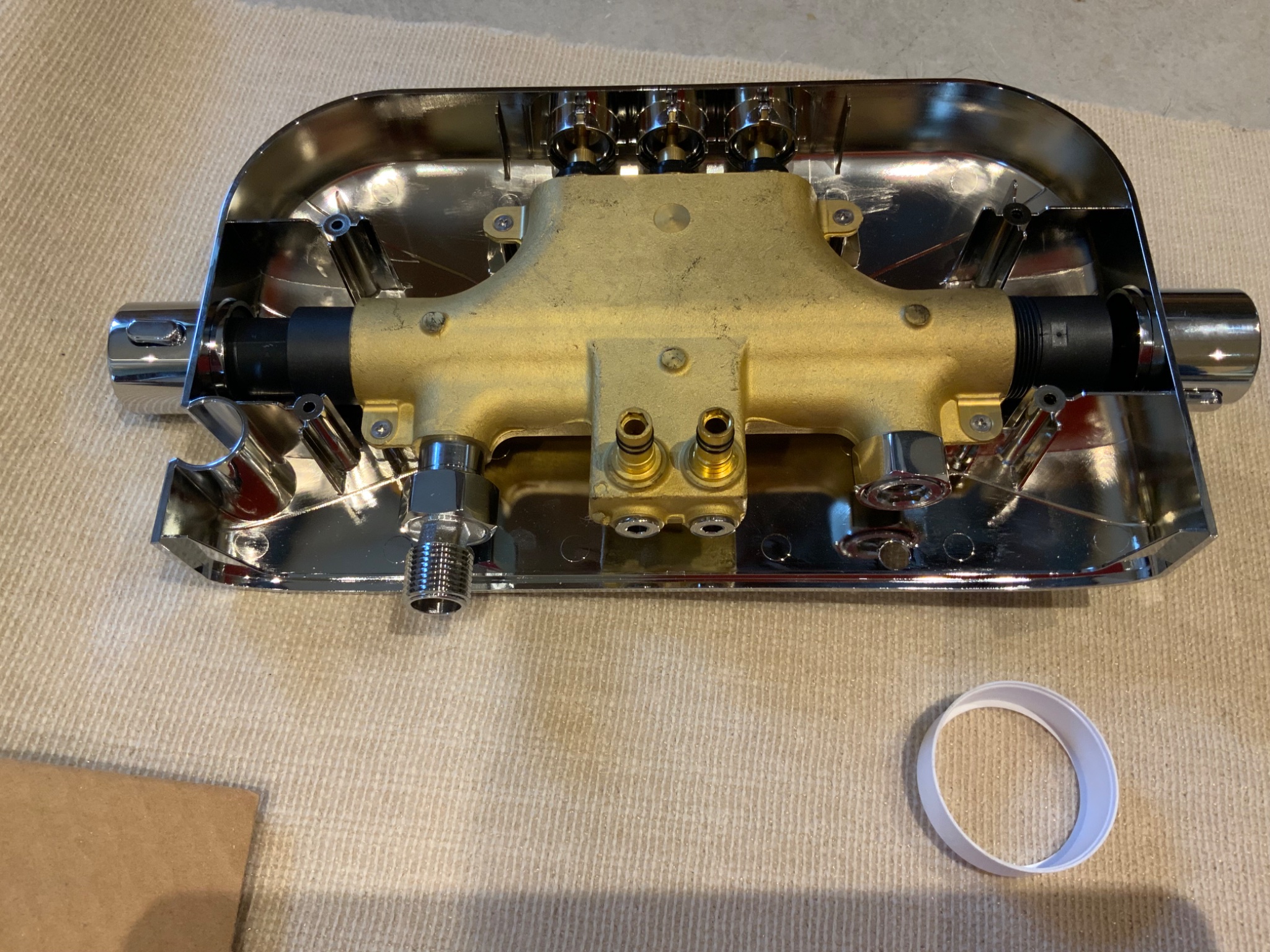

Thanks for the responses. It’s a new stud wall that we are currently constructing. We have looked at the plates like the ones sold in Screwfix, but they just don’t appear to be substantial enough - it’s very heavy and deep. The plate would also have to be positioned within the wall at exactly the right depth (to the mm), otherwise the valve won’t fit or it will sag and put further strain on the pipes. Photos of the instructions, the valve without the glass top on and one of the offset connectors.
Decent screws into a solid piece of stud and it'll never move. Much better than those dogleg things.
We’ve looked at the instructions for that plate and, whilst the plate itself can be secured firmly within the wall with some decent screws, the weight of the valve is still on the copper pipes. When you assemble that plate, there are two nuts that have smooth sides back-to-back, so there is nothing joining them to each other than the copper pipe going through them. I haven’t weighed the valve, but my dad (a retired plumber) said it feels about 4 - 5 times heavier than a standard bar valve!
I know I've fitted loads and that is what they designed to do. It isn't an issue.
The pipes are actually fixed withing fittings which are fixed to the plate. They aren't taking the weight at all.
