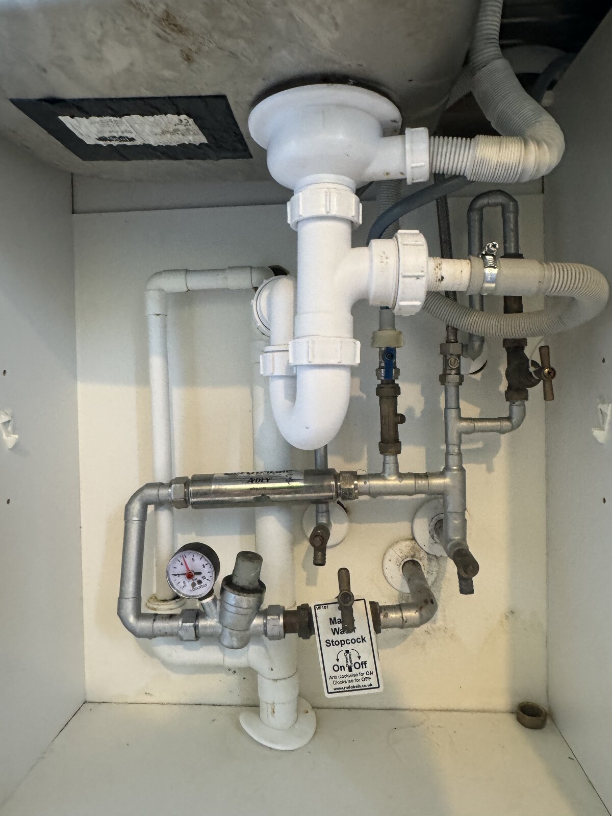

I’ve removed the cupboard next to the sink which has designed to be removed exactly for this purpose as there’s a power supply. Could someone explain to me how I can split the water supply to give me another connection and the same for the waste. Links to parts would be much appreciated. Or is this a little more complex for your average diy’er and should I just get a plumber. How much could I expect a plumber to charge for this job? Based in the south east
Change the current washmac isolation valve for one with two outlets for the supplies. You will need to change the trap for one that has 2 spigots to accept both waste hoses.
1. Waste = Mcalpine WM11 = Screwfix item 95241
2. Two outlet isolation valve = Screw fix item 24030
