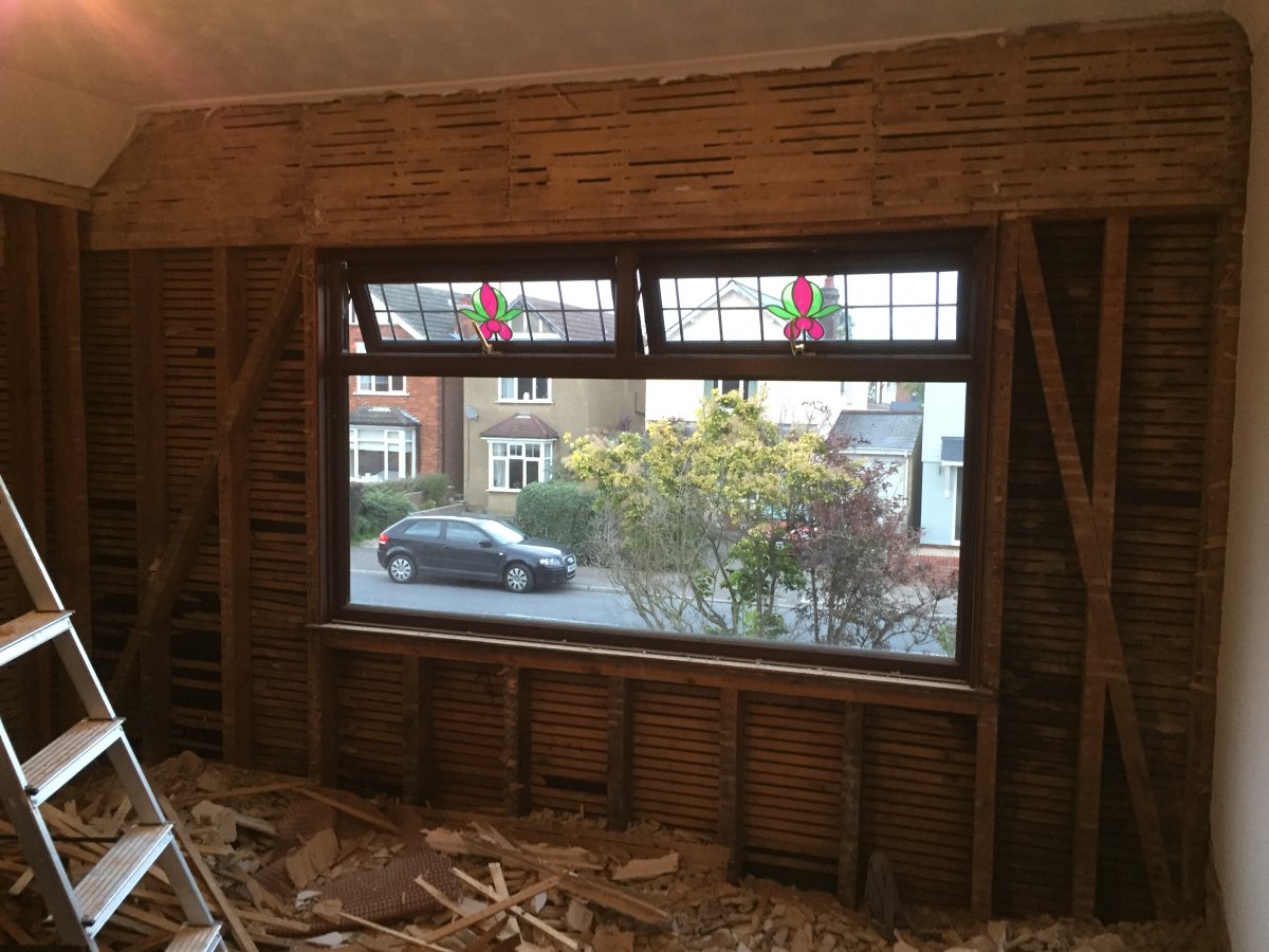

Made some progress removing the plaster today, which came off in fairly big chunks. Removing the laths was not fun. I've still got the clearing up and nail removal to do!
Here's a picture:
From what I can tell, I think at some point in the past the outside must have been rendered onto the laths you see on the outside of the studs. I could be wrong but there were still plaster snots attached in places.

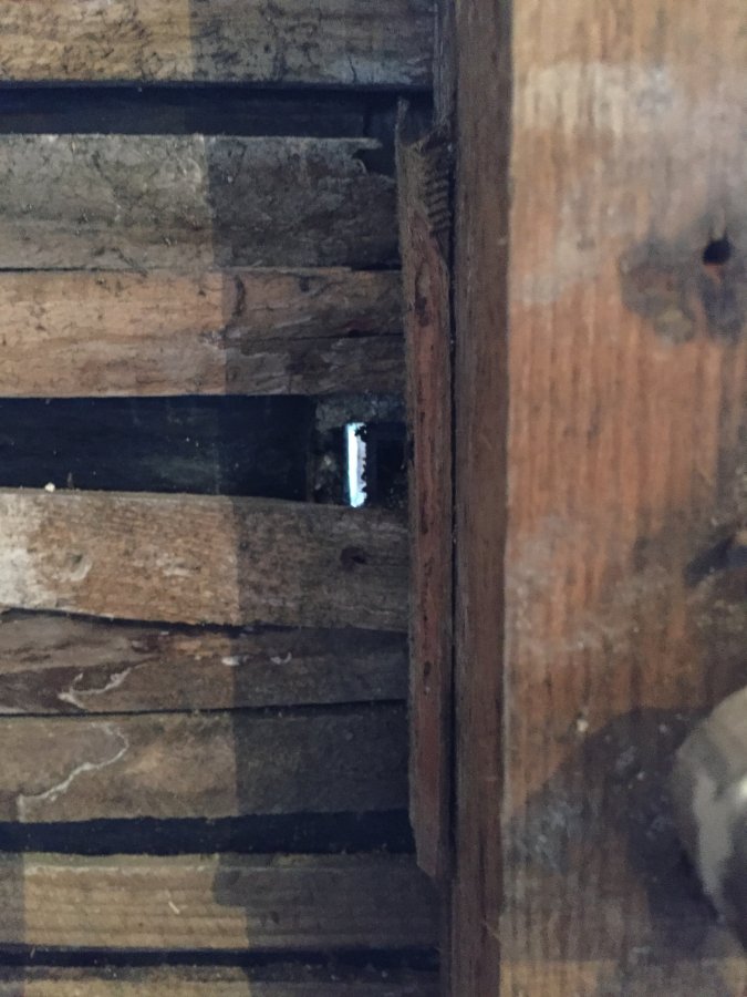

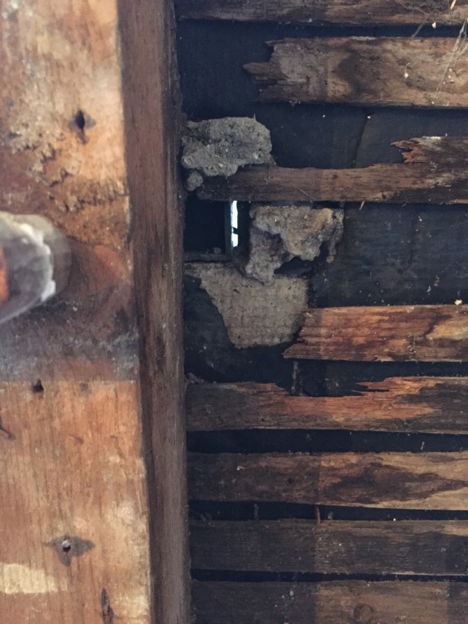

So we finished the job of removing the laths and nails and clearing up today and now have a clearer picture of the state of the timber.
Probably 95% of it is sound. The black membrane looks to me like some kind of bituminous roofing felt and looks the same as the roofing felt in our roof which makes sense, as I'm fairly certain the roof was redone around the same time as the front extension and re-cladding. I suspect this isn't breathable.
The other 5%...there are some small patches of damp timber, some of it rotten (mainly the tops of the 6x2 floor joist and the old laths). My original thought was that this was due to the damaged render but the vapour barrier seems intact. On further inspection it, it looks like it's more likely to be water penetration around the window sill - definitely in both bottom corners and possibly the top right too looking at the staining on the wood. On both sides of the sill you can see daylight. This has nothing to do with the render as the window is surrounded by timber fascia boards on the outside.
And the other side:
So it looks like AronSearle was spot on about checking the window junctions. We need to get this sorted before we proceed further.
What would be the most effective solution? Mastic on the outside to fill the gaps and possibly expanding foam on the inside? I'm just guessing as I'm not an expert!
