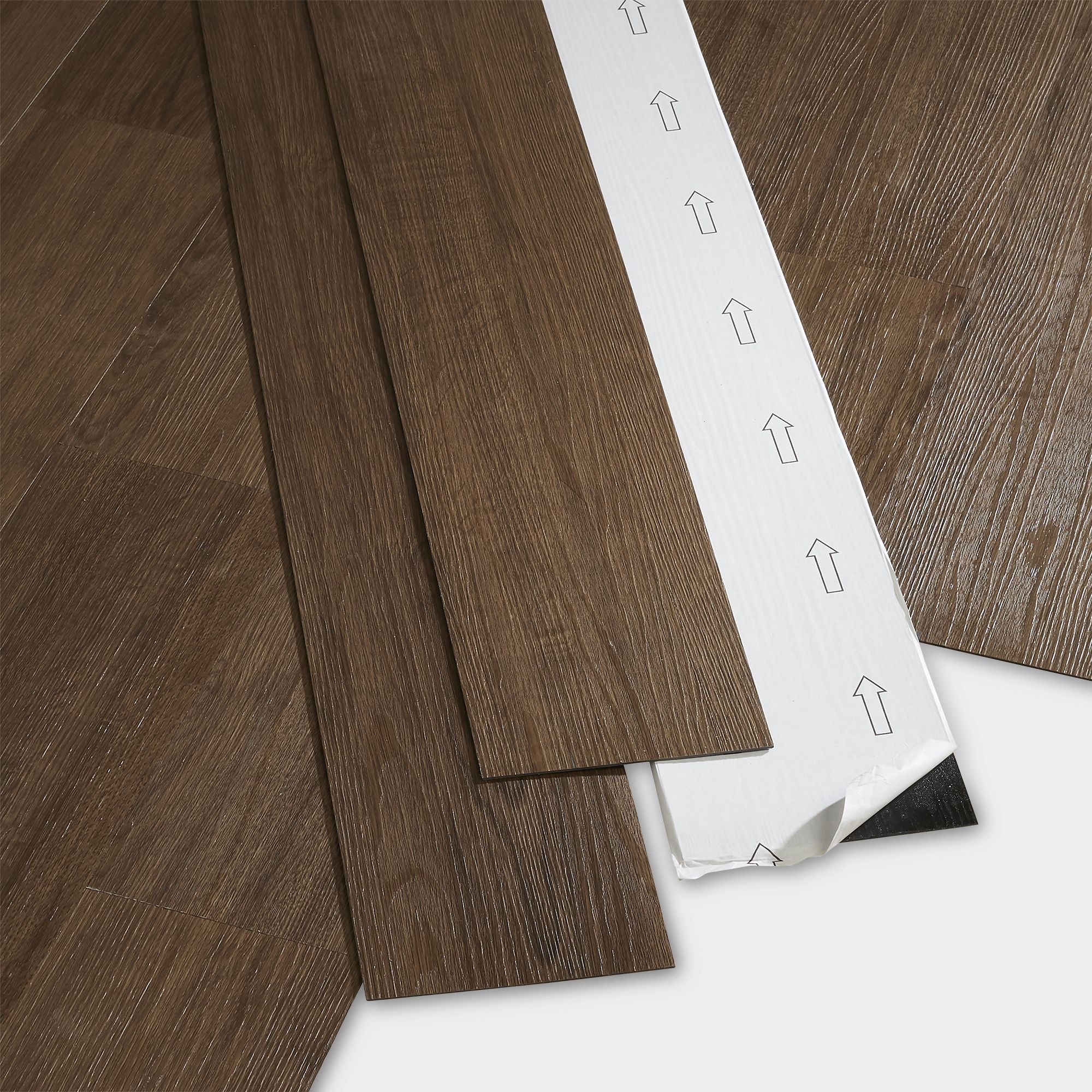

How to bond peel and stick vinyl tiles to porcelain? Too much trouble to remove the porcelain tiles now that the ceramic wall tiles are up. I got a same day response from Mapei advising me to contact the manufacturer. I won't waste my time with that as the manufacturer of these peel and stick vinyl tiles are sure not to reply:
I've used this product twice before successfully. Both times overboarding with ply. I'd rather not overboard as I'm trying not to increase the floor height. Are there any (contact/spray?) adhesives designed to bond peel and stick to porcelain tiles? B&Q stock some 'seemingly' suitable products, but when I read the exclusions, vinyl tiles were excluded. Anyone bonded these peel and stick planks to porcelain floor tiles?!
Why do you think that they would not stick to porcelain?
I would have thought that the porcelain tiles would be an ideal substrate for the adhesive on the vinyl tiles.
You may need to level off the existing grout lines though.
Already attempted it. Stuck one plank down well for a few hours. Later in the day, the plank popped off the porcelain tiled surface. Without a doubt, I need some kind of adhesive that bonds well for two non porous surfaces.
The surface is clean and totally flat. It'd be a real shame if I had to overboard with ply and stick the peel & stick onto the ply. I don't want to raise the floor height if I can help it.

I've overboarded with ply twice before with this kind of flooring and it's still stuck down 5+ years later. I've combed the usual forums and YouTube but alas there's little or nothing about bonding peel and stick to porcelain tiles. Peel and stick bonded to any kind of wood based sheet material such as ply is straightforward. Also, quite a few of the contact spray adhesives specifically exclude soft flexible PVC which these peel and stick planks are. E.g.
I'll have to have a look at some more spray contact adhesive technical data sheets and check exclusions. I'll perhaps take a punt on one or two and see if the planks bond to the porcelain tiles. If not, I'll have to overboard with 1/4" ply. Not ideal, but a solution nevertheless! :)

Alas, I couldn't find any mention on the technical data sheet for prim grip that recommended for use on flexible vinyl PVC tiles.
Aha! Now I understand. It seems this product can be used on non-porous surfaces like my porcelain tiles.
I can't find any post or videos in the usual places where someone has actually used this for peel and stick tiles. However, I'm very grateful for your post as plenty of reviewers on Toolstation and the like have commented that it leaves a grainy sandy surface texture. I expect that will prime my porcelain tiles well to take the peel and stick planks. Thanks a lot @dazlight, I feel this is a product that will work! :-)
The best way would be to put a 3-5mm coat of smoothing compound after the primer but you will be ok with peel and stick.
