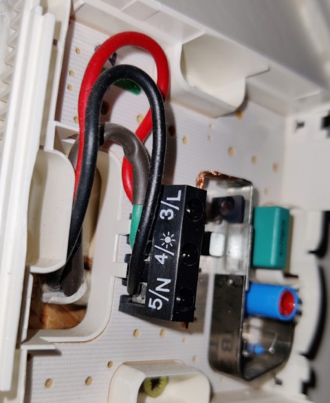

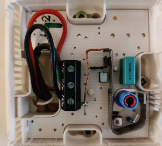

Thanks for the help - the TimerSwitch has an always-on feature I was not aware of.
Unfortunately, once I got started, the labels on the Thermostat don't match up with the choices presented in the Nest app.
The nest app talks about Common and Normally Open.
But the VRT-30 and the Boiler thermostat connections are labelled 3,4,5
The Vaillant thermostat wires are as follows
Red goes to 3/L,
green to 4/*
Black to 5/N
Can someone help me translate from Vaillant numbers to Nest labels? Thanks
The boiler manual states the following:
VRT 30 (room thermostat) - Wall-mounted, 3-wire connection to terminals 3-4-5
Terminals 3 and 4 are linked together when the boiler is supplied.
If external controls are used, this link must be removed, and the controls connected across terminals 3 and 4.
Terminal 5 is an additional neutral connection for external neutrals such as from the anticipator of a room thermostat.
Thank you.
3&4 to NO and COM on the nest, safely isolate the N , nest E doent use a N it uses batteries, dont touch any links at the boier, and it doesnt matter which way round you connect the wires at the nest
