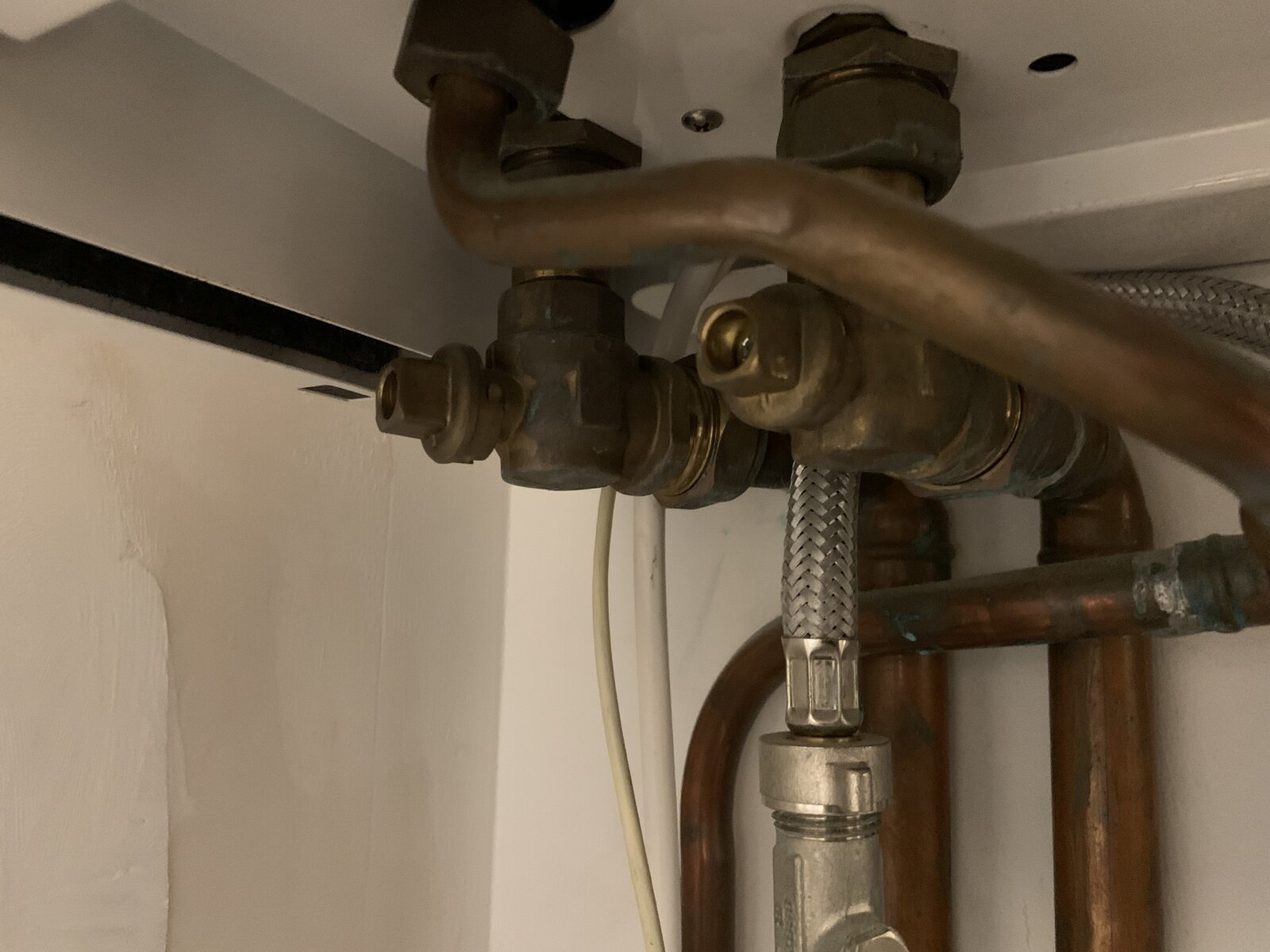

How to close these valves?
1 Feb 2017
69
3
Some advice would be appreciated here. I want to turn off these valves on the flow/return pipes under my Vokera Mynute i20 boiler to isolate the boiler and hopefully drain it without draining the full system, but how do you turn these? There’s a screw but can’t turn valve with a screwdriver and I also tried some pliers but the valve started to drip a little. I’m worried that if I turn too hard I’ll break something.
If they weep when turning then don't use them, old boiler isolation valve leak just for fun. If they've stopped weeping then you're lucky they usually continue to weep and the only fix is replacement.
If you want to try then use a spanner sized to the square or an adjustable spanner and they will go, twist through 90deg to turn off.
Thanks, they are 9 years old, is that considered to be old for this type of valve? Are they just ball valves?
Yes - and because they get the constant hot/cold treatment and have chemicals running through them it impacts on the seals and when they are used the seals can weep.
9 yrs is enough time for them to be effected and as they won't have been used for 9yrs. It's a common issue.
