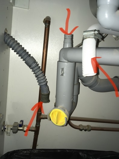

Hi guys
How does one connect the waste of the setup in this picture? The grey pipe on the left is from the dishwasher and the white pipe on the right is the boiler overflow. I need both of them to go into the grey sink waste trap in the middle.
+1 ... terrible things these bespoke waste setups. They might work well in Scandinavia but they don't cut the mustard over here. I can just about guarantee it'll cause problems later down the line.
th
As @HERTS P&D suggests, one of these from SF or TS or B&Q should do the job.
  • Thanks
Reactions: Mun
Thanks so much gents! Makes a lot of sense - I'll give this a go.
