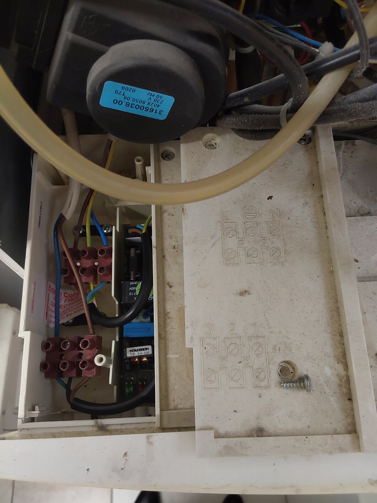

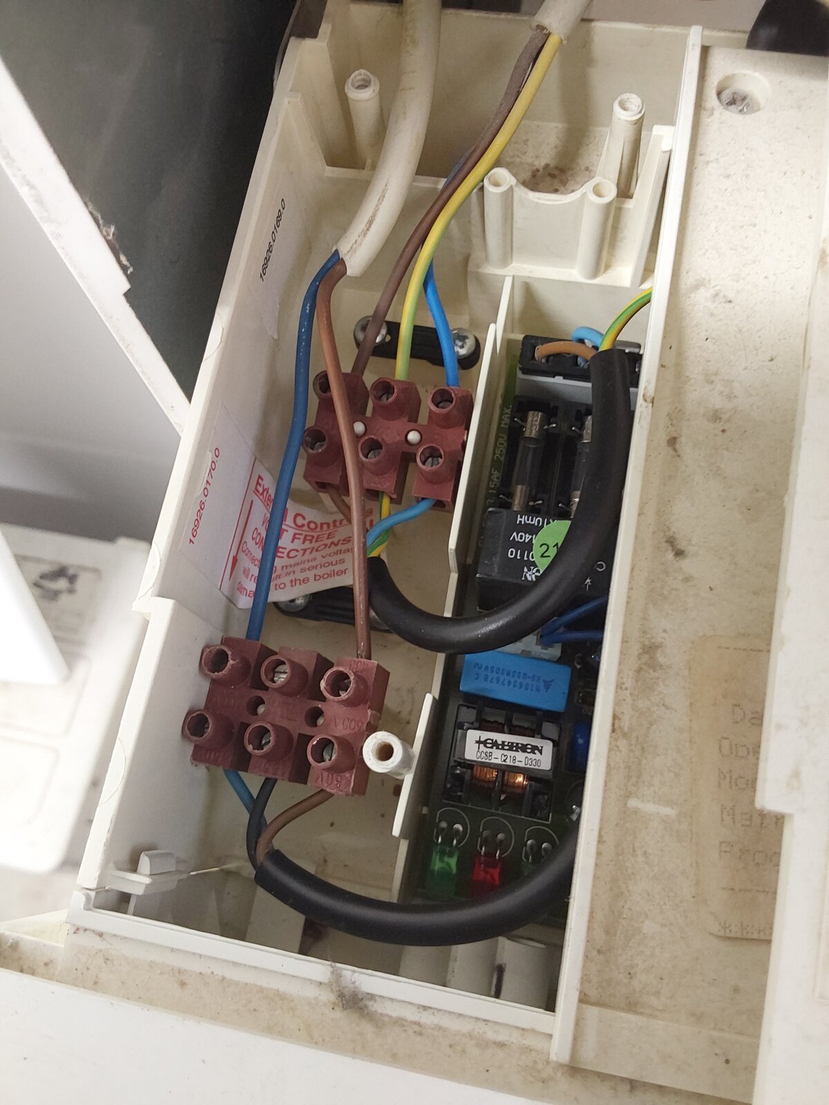

Hi,
I have recently bought a nest thermostat to replace my Honeywell wired thermostat and i was wondering if someone can help me with instructions on where to connect the heatlink to?
Find attached pictures of the fuses on the boiler, connections on heat link and from boiler.

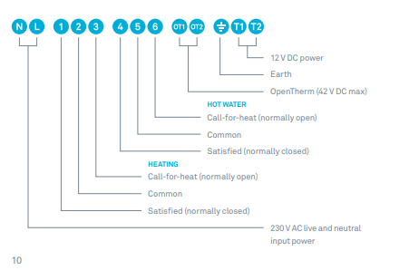

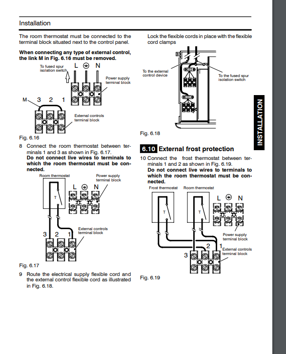

The Heat link 'Heating Common' (2) and 'Heating call for Heat' (3) are connected to boiler terminals 3 & 1 as per the manual below. The wires to the existing thermostat are removed.
Then the Heat link also needs a 230V supply to N, L, E to provide it with operating power. That comes from the same 3A fused connection unit that supplies the boiler.
If you are going to use the Heat link to power the Nest thermostat, then a cable to connect the 12v T1 & T2 terminals of the heat link to the T1 & T2 terminals of the Nest thermostat are also required.
You may see some installations that require a link to be made between the Heat link L and 2 terminals. You must not do this. Your boiler uses different voltages for its power and switching circuits. As per the label inside the boiler and the instructions.

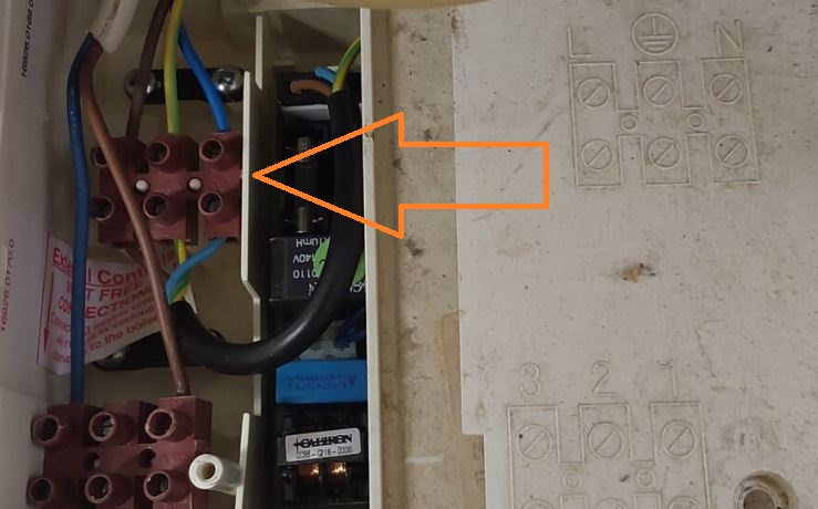

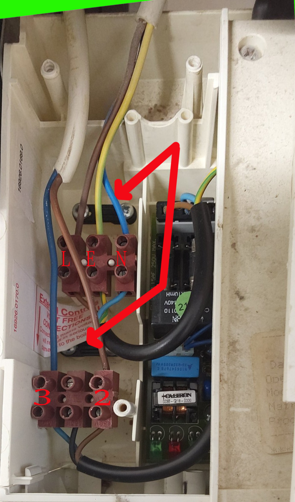

However one more question. can i take power from the boiler Power supply terminal block? And how ? (I am a rookie, so it might be a stupid question but i don't know it;))
The terminals with the orange arrow are the 230V supply. The diagram at the side tells you ;)

I definitely want to try and do it myself. I am used to wires but not Electrical ones. (I am an IT)
I will use the current thermostat wiring to connect the thermostat to the heat link. It is just the 230V connection that i am struggling with how to do it.

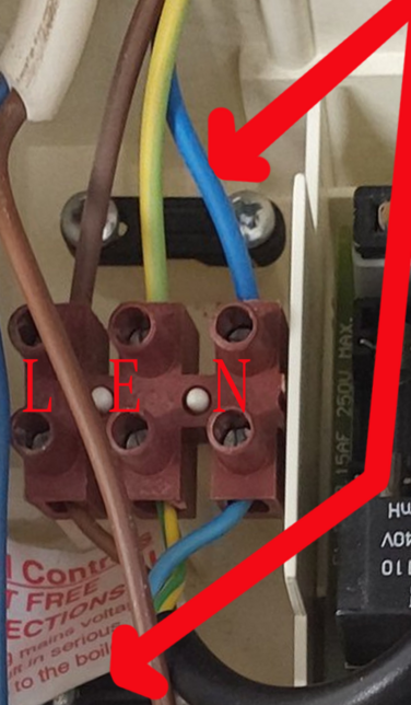

It sounds like an easy concept: Pull power from the existing wires (In the picture bellow). But I don't really know how to divide 1 electric wire to 2.
Do i cut only the live and run it trough the heat link and then take the neutral back to the boilers live connection? or do i need to divide the wires?
