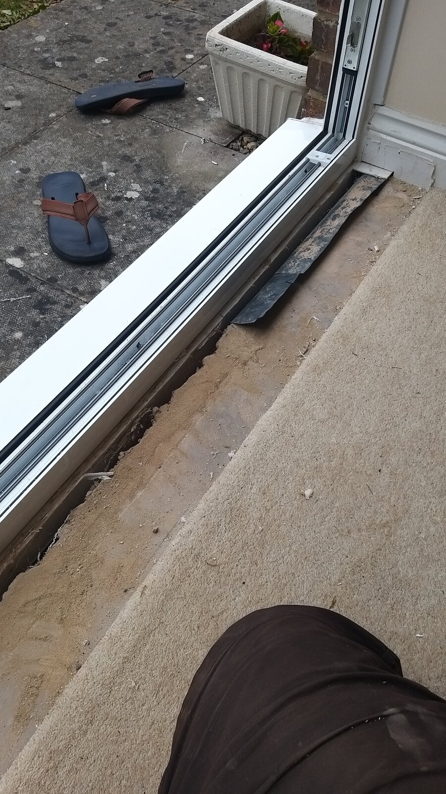

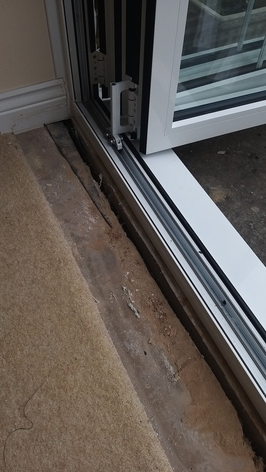

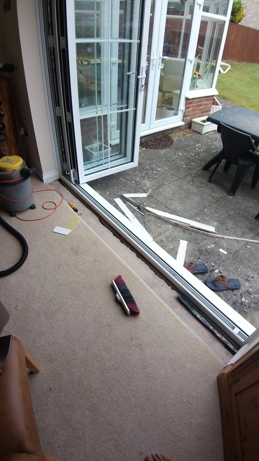

I have just had new bifolds fitted and because I want to tile right up to the door, I cut out what I thought was some some trim, so the tiler can get right up to the door.
Turned out, this "trim" covered the cavity, and I believe it is a "cavity closer", which I have mostly removed (rightly or wrongly).
The gap is between the inner and outer brick course, and I need to close this some way so the tiler can tile over it.
Its about 50mm wide and 150mm deep.. And I hoped I could just fill it with mortar or foam, but talking to a friend at the weekend, he has put the fear of god into me as he talking about breaching the cavity causing a whole world of problem..
I have attached some photos which I hope will explain better.
So what can I do here? He suggested lining the whole thing with DPC membrane and filling it with cement, effectively making a 'bag', but this is almost impossible to do as its only 50mm wide (max)...
What options do I have? What can I do about this gap/cavity?

Basically do what he said.
If you can get some thin insulation board (insulated tile backer board) and slot that in, even better.

I did consider this, but the cavity is far from straight and is different depths, so it will be hard, if not impossible to get insulation board in.. Perhaps I could put it in in smaller pieces, but it didn't seem like a stable surface to tile over.. That said, its only the last 2" upto the door and I can't imagine anyone would ever step on it..
I was hoping to do something a little more "solid".
Tile backer board is 10mm, double it up if you like.
You could just back fill it with concrete but a thermal bridge is useful. I've seen thresholds 'sweat' where the floor insulation stops

Yes.. The strip was under the door. When the door was changed, they left it and I assumed it was just some trim, but when I cut it out, I realised it was covering the cavity.. I didn't really have much choice to remove it as it was too thick to tile over... But with hindsight, I might have left it in and then put some kind of trim over the top.. But it would have ment tiling 4-5" short of the door and wouldn't have looked great.
I have some membrane, so after looking again, I think I am going make a 'bag' and then fill it with cement.... I am still not convinced this will be easy as I fear there won't be enough cement to force the 'bag' into the corners (As the membrane is pretty thick)... Its a shame I can't just go with the expanding foam, as that would be easier.
Use thinner polythene. You can ex foam it if you like.
