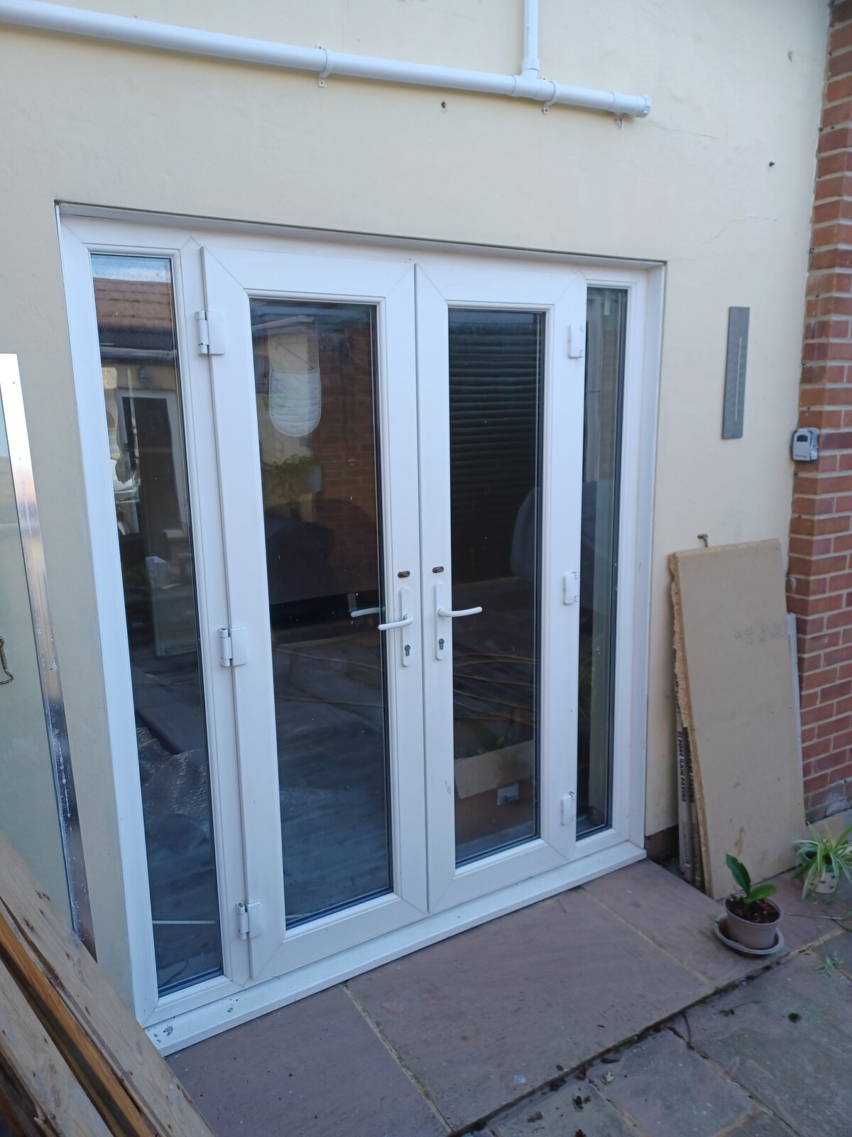

This is the door in all its glory. More trim on the outside (not present on the other one). I'm not going to investigate what's under there. Lol
I had to replace one of the big glass panes in the other one and it was circa £110 from what I recall, including fitting.

Looking at the new photo, you'd only need to remove the windows. You could leave the doors untouched.
Sealed units are dirt cheap. I've replaced many (misted up units and one cracked in my case), just measure up and order online. All very much disaster recovery anyway, anyone using care will not break one. I'm just saying that the scenario you're attempting to portray as doom-ridden just isn't real.
I can't tell from the photos, it looks like they're internal beads as most have been for decades. Lever up one long vertical edge and have a look at what's involved. Probably a sealed unit sitting on some packers.
