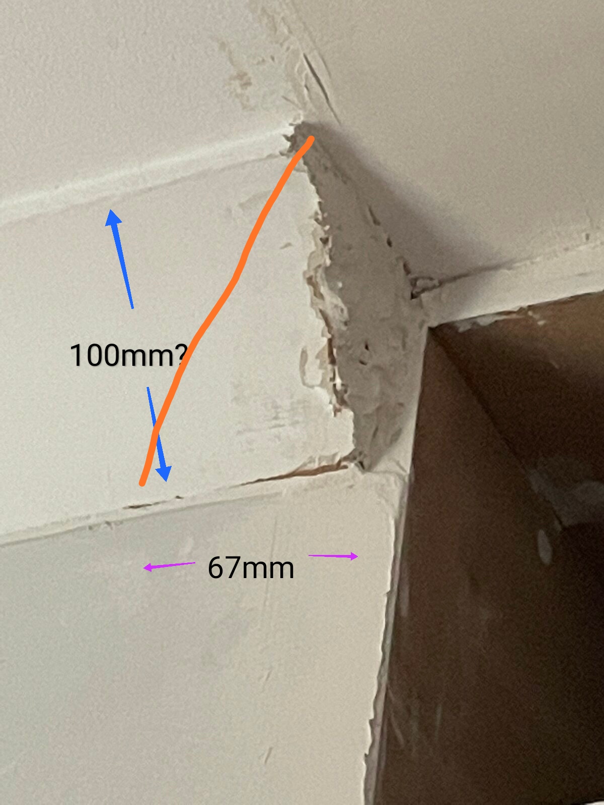

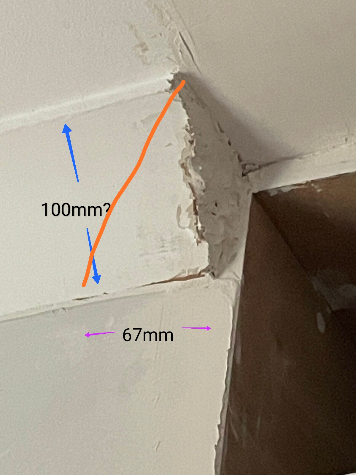

Just cut the existing piece back using a left hand, LH, external mitre template, to mark where to cut, then cut another small separate piece of coving, using a RH external mitre template. Join/fix the 2 together on the ceiling, then you'll end up with a neat, external mitre.
Be careful when you cut the existing piece. When you've marked it, cut it back carefully with a sharp Stanley knife.
