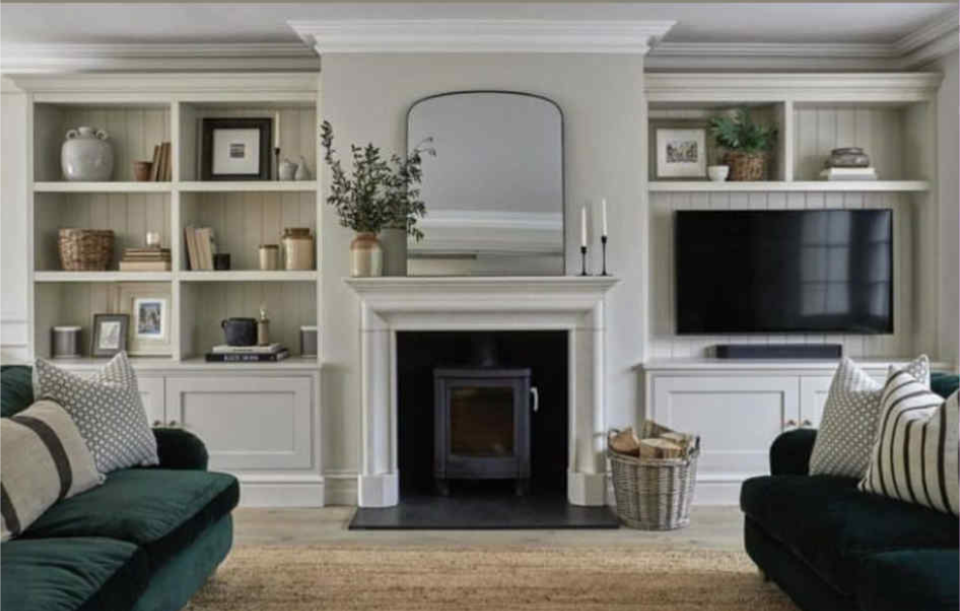

How to fix these shelves?
9 Jan 2021
40
Amateur DIYer about to start next project.
I'm looking to put built in cabinets and shelving in my living room alcoves, similar to the photo attached.
I'm comfortable with building the cabinet and plan to build the shelving above in situ.
I plan on using 25mm MDF for the vertical partition and shelves.
I'll fix 25mm MDF to the walls on either side and then a board at the top which will will eventually be covered by trim.
I'd fix the vertical partition by screwing upwards from inside the cabinet and down through the board across the top.
Where I am a bit stuck though is the shelves as I won't have access to screw these in from the outside.
Would sinking screws at an angle and covering with filler be the best way? From experience I've struggled to fully sink the screw when doing this in the past.
Ideally I'd want to avoid having any visible brackets if possible.
On a side note, the width of each shelf will be around 640mm. Would I likely see sagging at that length if using 25mm board or should I be ok?
Thanks for any advice given.
Dan

Would you not build the whole shelf unit as a complete box on the floor ie like you would a kitchen cabinet and then fix it back to the wall, supported on the base units? They'll be no sag with 640 wide shelves.
I suppose another option would be to make the partition and shelves out of timber (thinner than 32mm ideally) and 'wrap' this with 6mm MDF. This would solve the side fixing issue but would mean slightly chunkier shelves
I don't really understand the side fitting issue, if you build the units beforehand.
My only issue with building separately would be gaps at either side if the chimney breast wall isn't perfectly straight. Something I'll need to double check.
Let's say I did manage to build it separately, I'd still have the issue of fixing one of the shelves to the vertical partition
You build a back on to the unit and screw through that. For the sides you would fit an architrave over and scribe it to the inevitably uneven walls.
