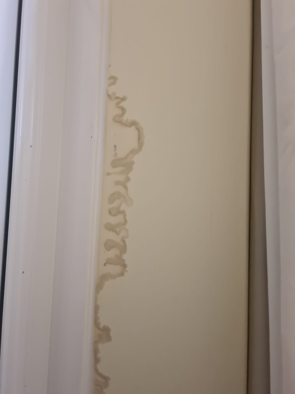

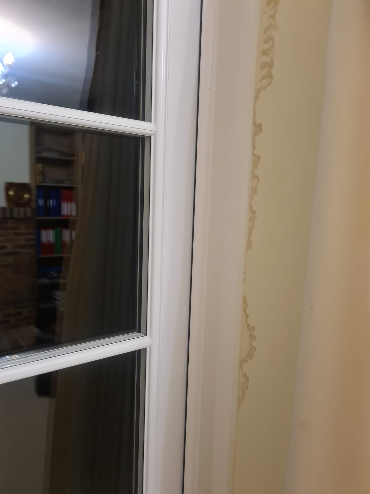

How to fix these water marks /seepage near patio door? See photos
21 Feb 2021
163
2

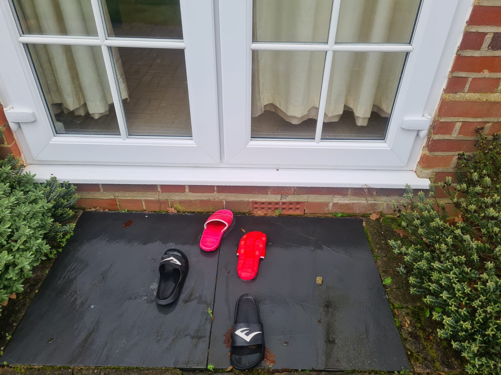

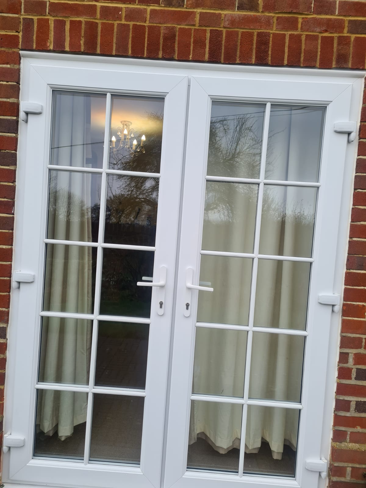

I have seen some water marks near newly installed patio door. See photos. House is built 80 years back . not clear what causes this and what is DIY remedy? Please help
Photos here

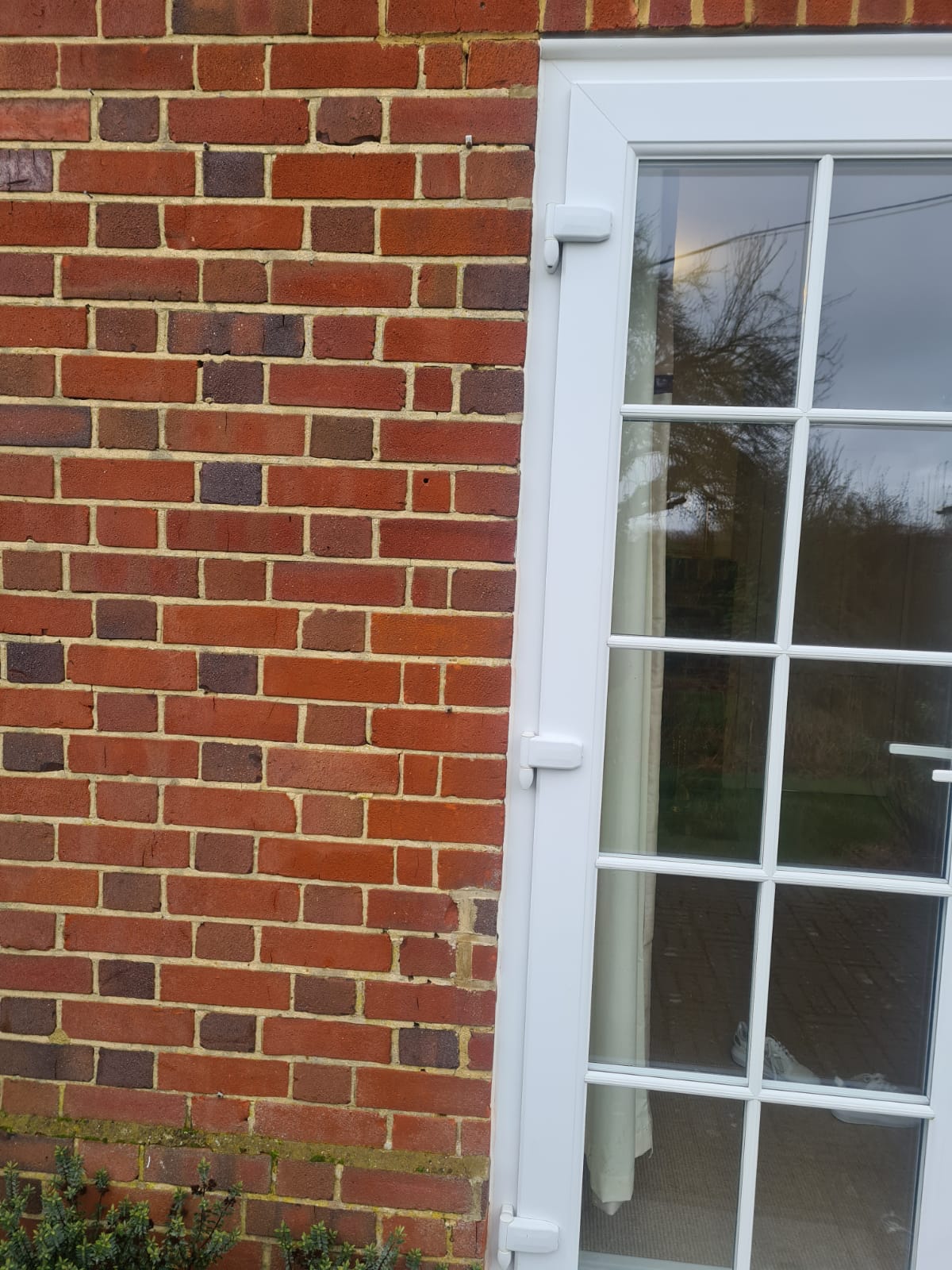

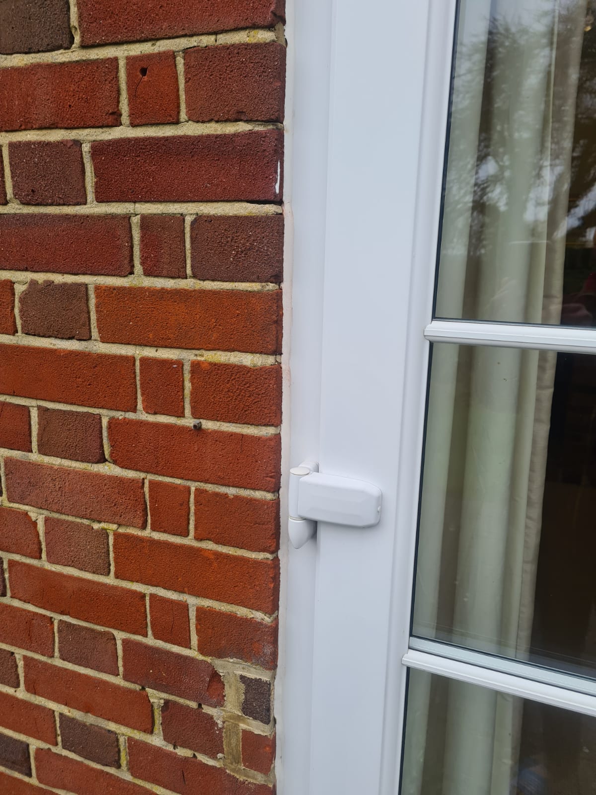

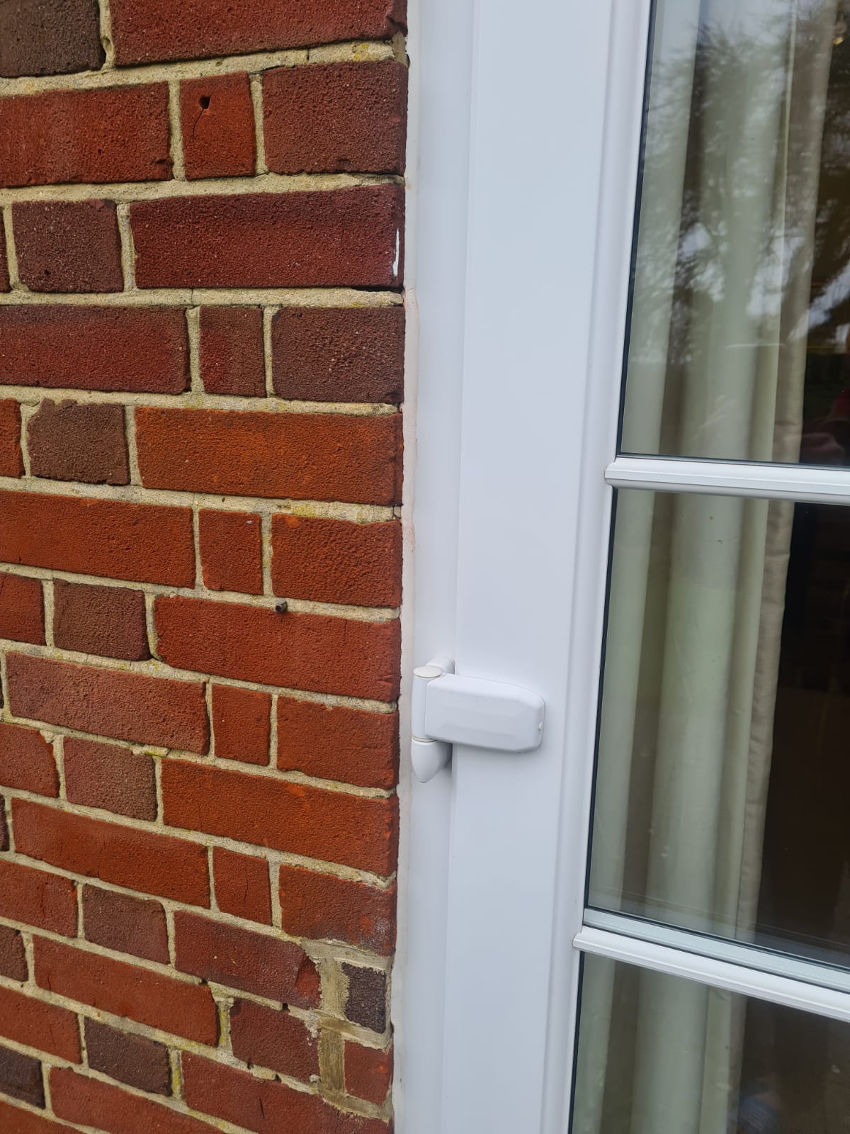

See photos from outside. thanks.
Not sure if these photos help anyway to find reason..?

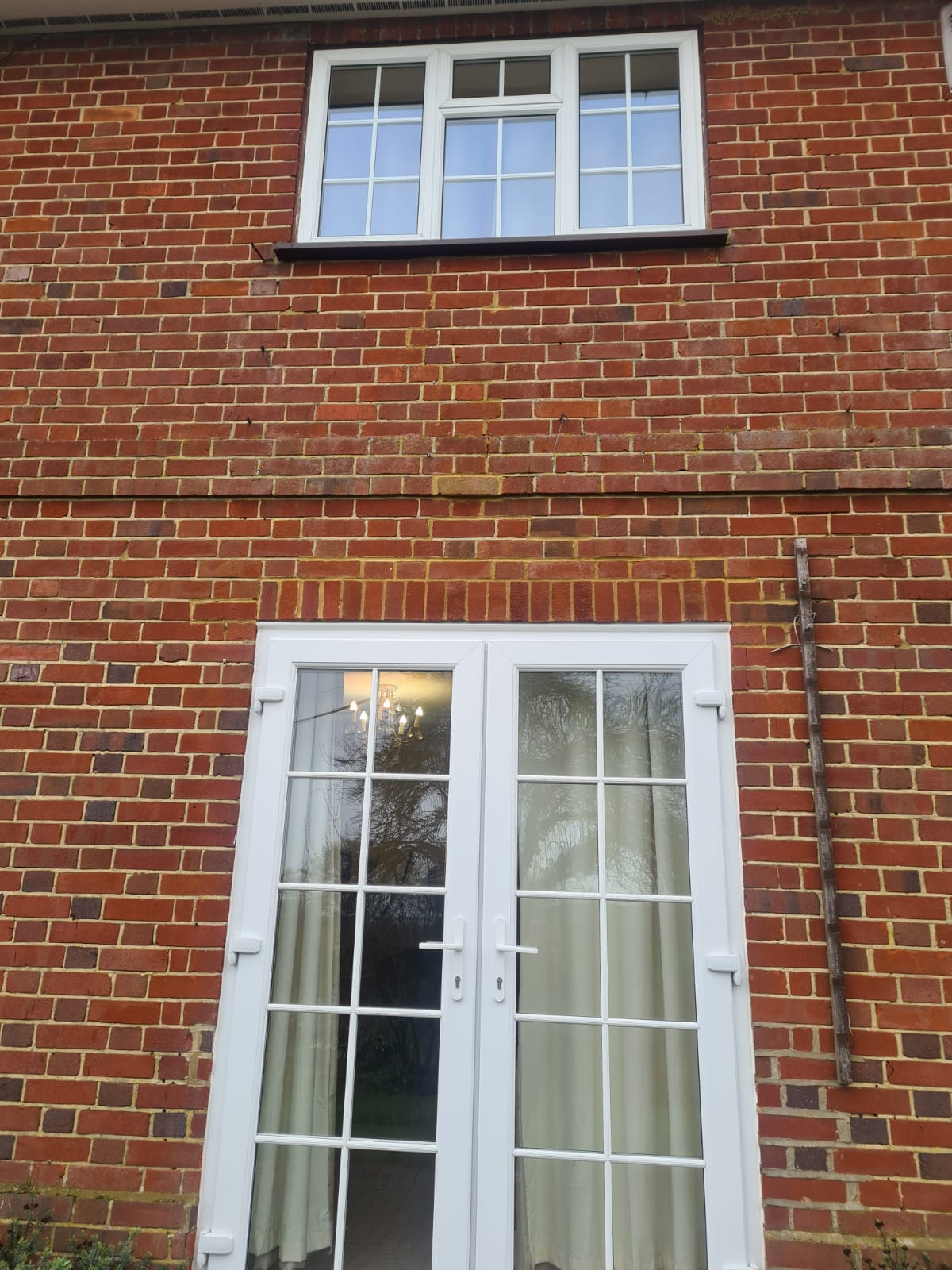

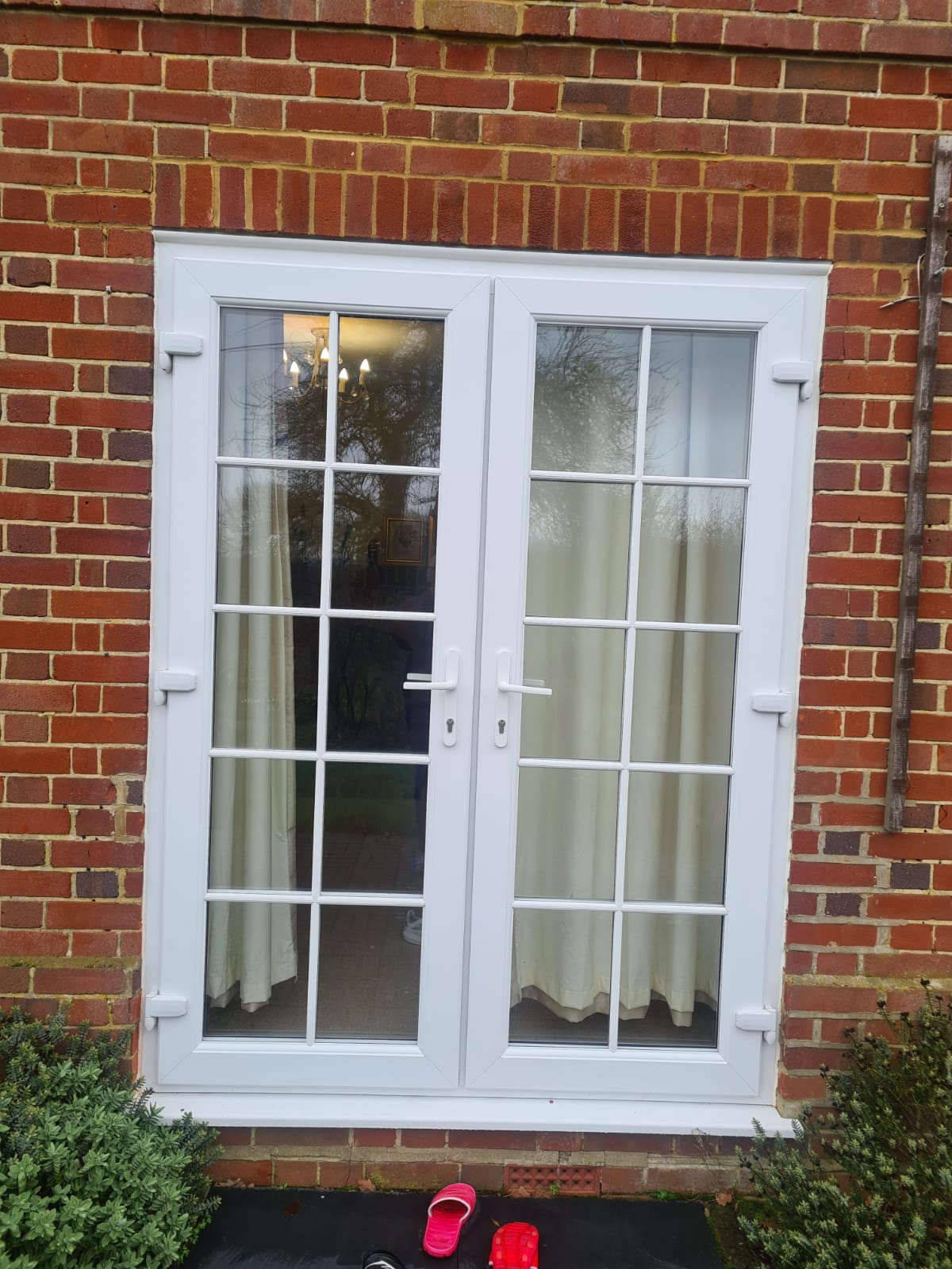

Pictures from the outside, near and far will help. Including the guttering above, if any.

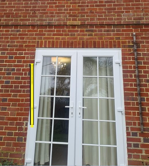

Not sure if these photos help anyway to find reason..? I couldn't see any reason. House is 80+ years old and this door in installed recently only. Outside some areas shows need to repointing but not nearer to this door.

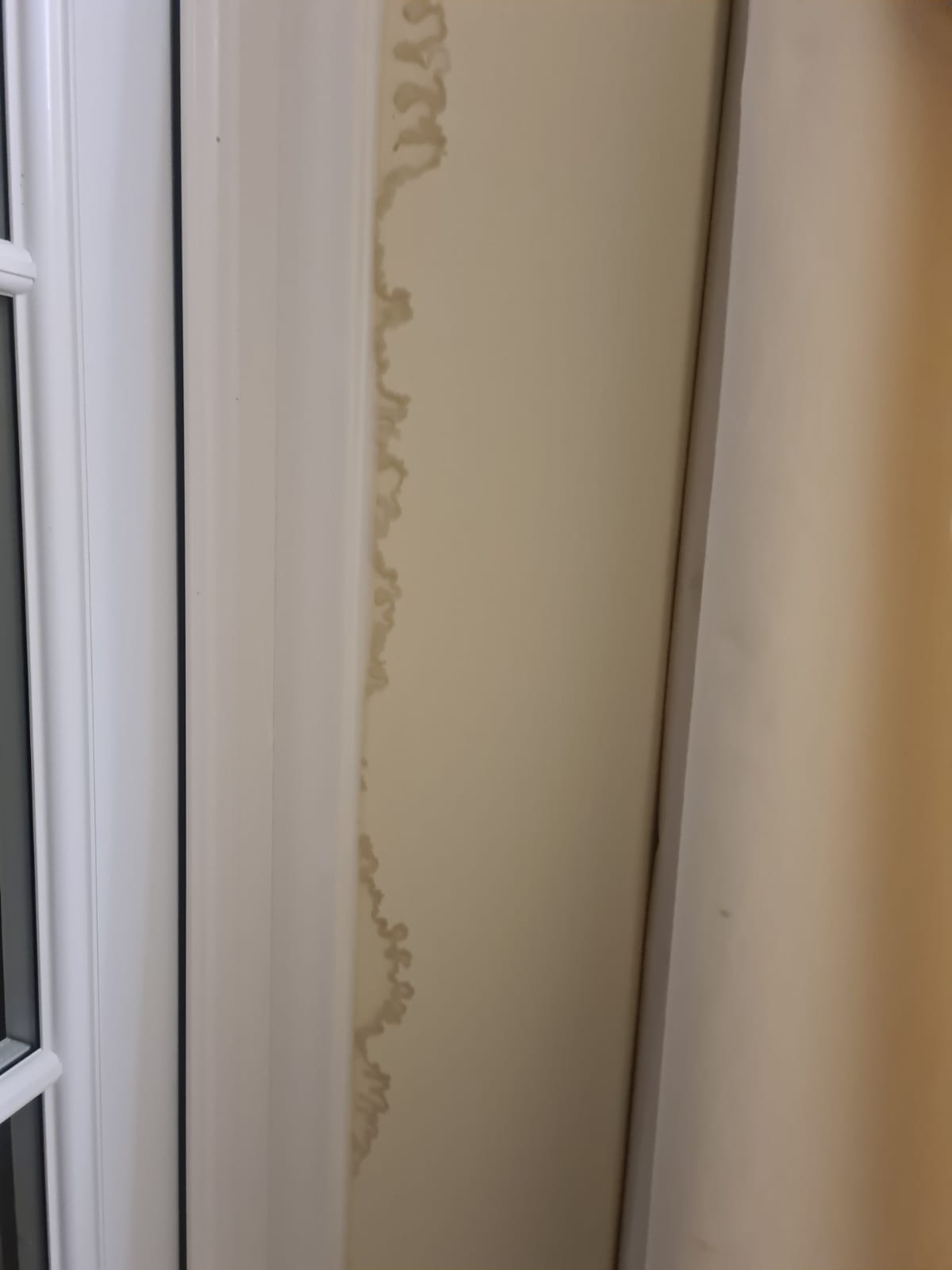

Seepage/leak/water mark is mainly in this area inside the door. Not on the Top
But if there is a gap then it could be running down into the cavity and bridging across.
Have you just bought this house? Did you have a survey? What did they find?
Andy
Nothing above door to cast off rain so just running down brickwork and in around frame.
Remove an inner trim , probably find big gaps around frame.
