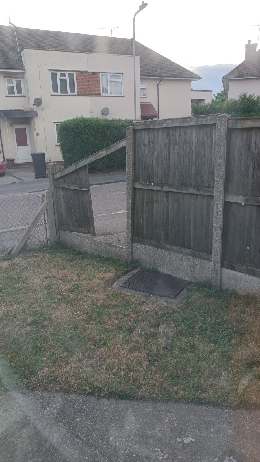

How to fix this fence please?
10 Sep 2012
47
Kent
Please can someone advise me on how to fix this fence. I don't know what to search for fence panels doesn't work. Do I need to make up the panels (planks) sorry I don't know what I'm on about. Would getting a pannel and sawing it a bit to fit work? Sorry i have no clue. Any help is much appreciated thank you
Fencers regularly cut down panels to fit the end of a run, just remove and replace the bracing carefully after measuring the angle of cut and sawing to size, or even leave full height as per the rest of the fence. Alternatively, you can build from scratch with parts sourced from a timber or fencing merchants, you have the full panels to measure from.
