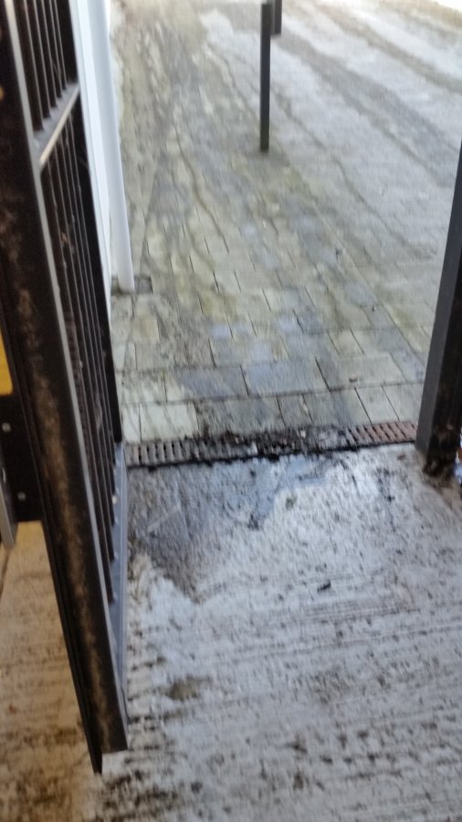

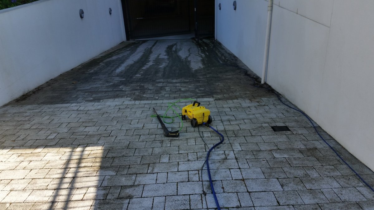

What's the best way to pressure wash and also keep it tidy? I was leaving piles of wet pressure washed dirt for the next day so it was dry and easy to sweep up.
But person I was doing it for complained that said it looked messy. Can u sweep it up all wet?
Get a patio cleaner attachment.
Alternatively, try to direct the waste into a particular direction eg the road. You can brush wet debris too.
+1 for the patio cleaner. I think the drive slopes away from the road;)

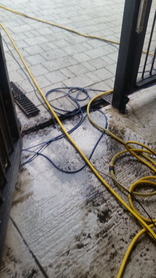

Look like you are blocking the drains. Sweep the rubbish up first , then wash.

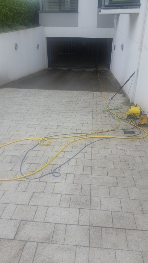

It's not obvious but it looks like you've got the Karcher K2.20M pressure washer. Karcher do a range of accessories including these:
https://www.kaercher.com/uk/accessory/t450-patio-cleaner-26432140.html
https://www.kaercher.com/uk/accessory/t550-patio-cleaner-26432510.html
https://www.kaercher.com/uk/accessory/ps-40-power-swab-surface-cleaner-26432450.html
I have the Nilfisk version and it minimises the amout of crud that goes flying about when you use the pressure washer.
