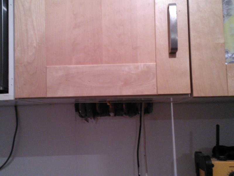

So far he has done the foundations walls, roof is not really complete, there is nothing inside, heput the sink, and charged us an extra £120 to put a sort of unit undeneath the sink. I will put pictures later.

the list is long, the felt on the roof is not properly done. he is supposed to put all units in kitchen and it's part of the quote, but he still want £150 for the unit heput under the sink (look at picture), he used the wrong size pipe for boiler and the heating is not fully working, we also have 2 leaks.

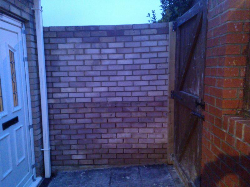

For half the garden wall, he wants us to pay £450 which we never agreed on, and the second hlf which we did ourselves he wanted another £450.
For the shower room, the wall at the end of teh room, he wants £450 and we have him the bricks and cement, this wa part of the original quote, he
wasn't going to put bricks but because we wanted bricks we bought the bricks.

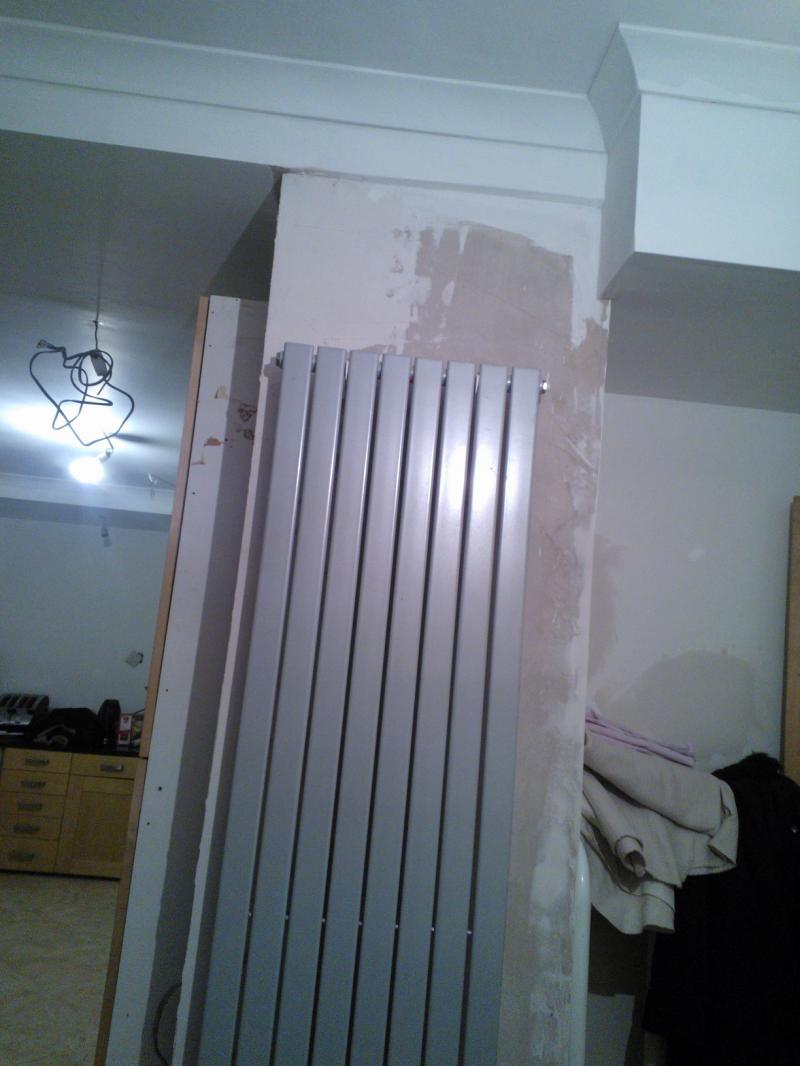

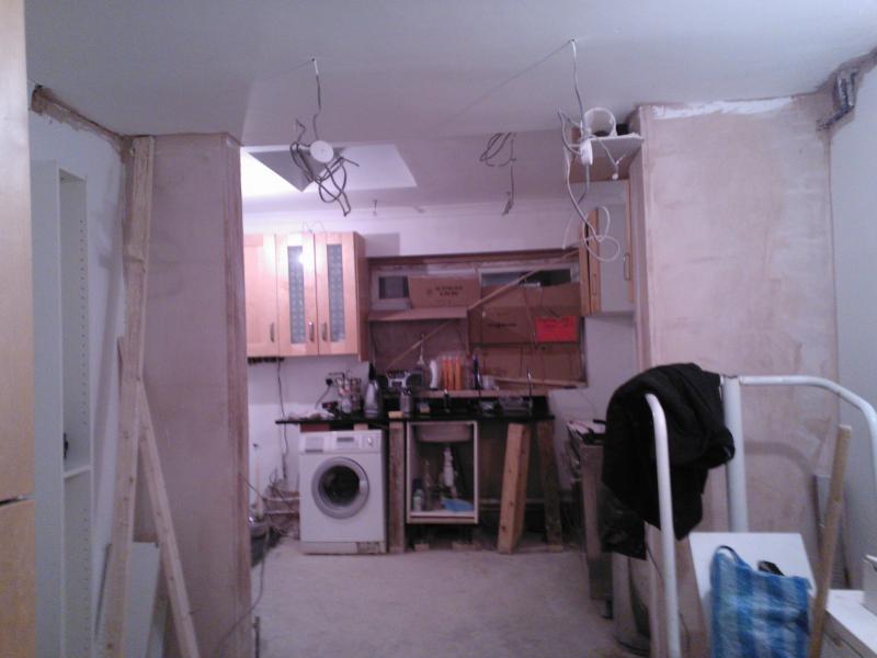

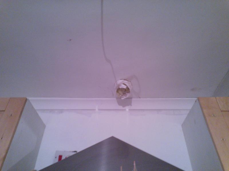

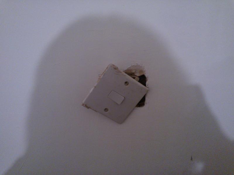

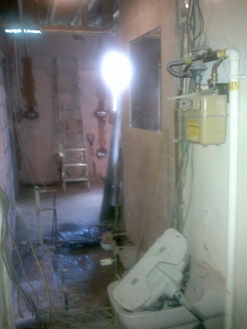

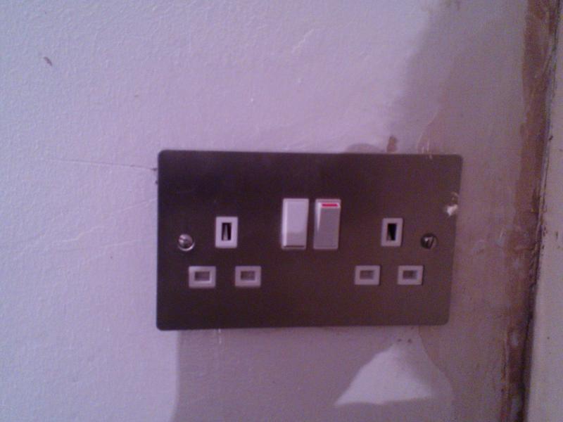

I can't figure out why anyone would leave junction boxes with additional wires hanging from the ceiling, is there to be a false ceiling or something? Even still, screw terminals aren't meant to be used in areas which are not accessible.
As some of the electrical work is in a kitchen and a shower room is he using an electrician who can self certify compliance with part p of the building regulations?

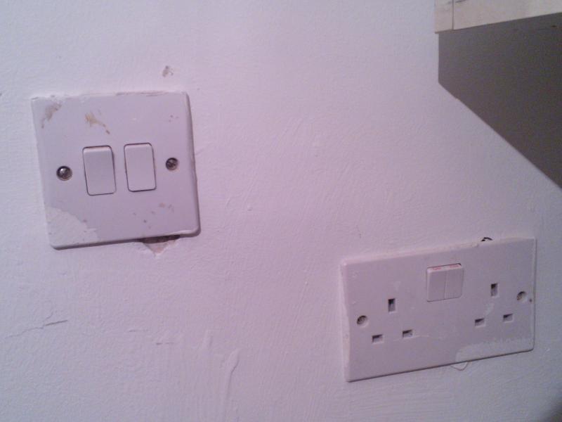

Is that light switch which isn't screwed back live? If so it is criminal to leave it like that. Also makes my attempts at plastering look good :D

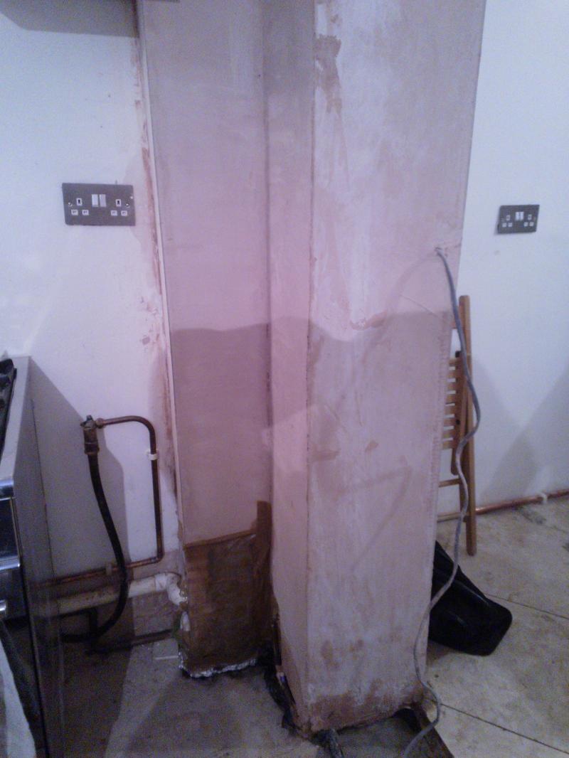

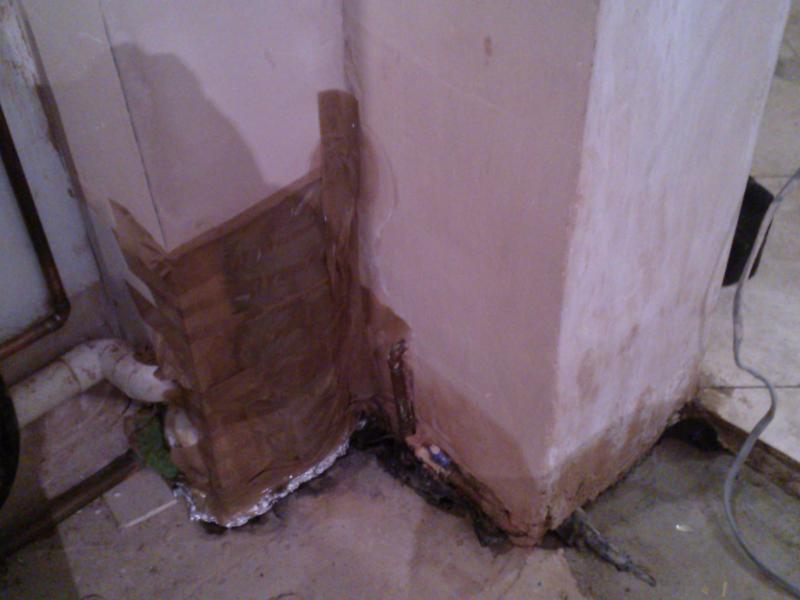

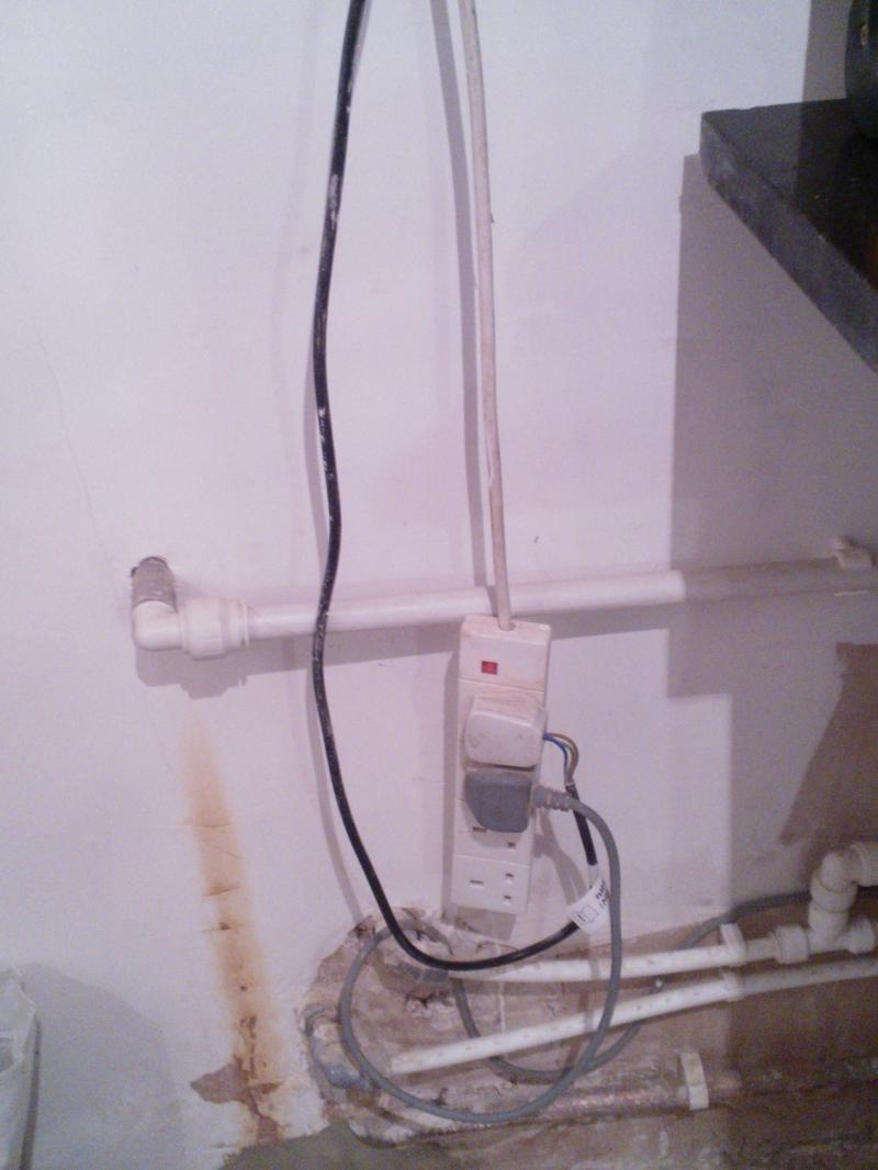

The picture next to the cooker is where the main drain is. They have boxed it, and there are 2 leaks, also i had to try to close the bottom as mice were entering the property.

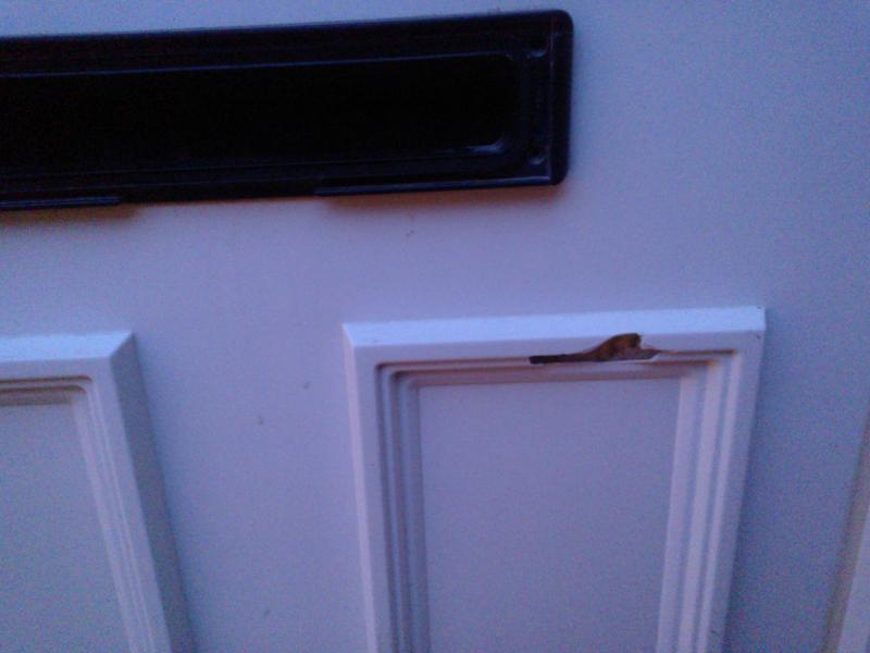

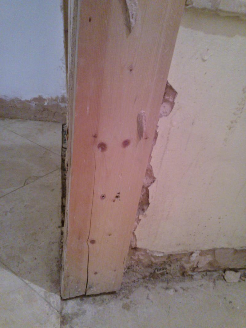

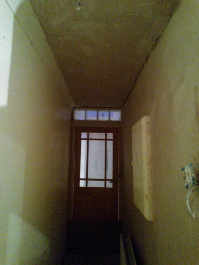

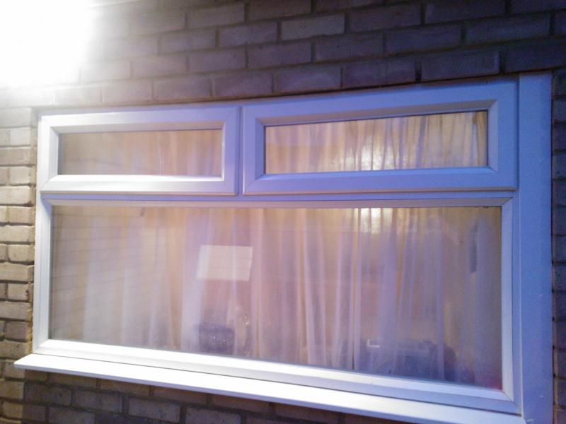

The wiindow is not fixed properly and they have damaged the door.
The guys who dod the electrics are the guys who did the plastering.
