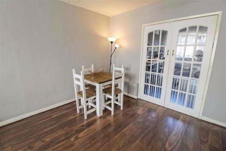

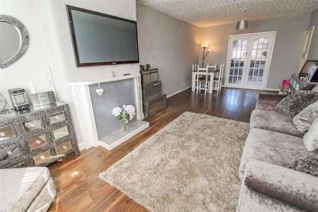

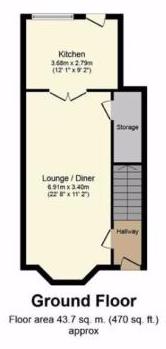

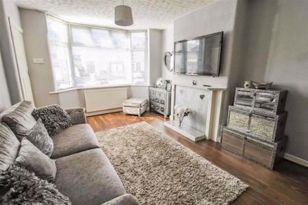

The biggest problem is downstairs which is essentially one big lounge / diner and kitchen which is an extension but in the 80s. There's a radiator in a bay window at the front, and another on the wall in what would be the dining part of the room and a very small one in the kitchen extension. The two bigger radiators are hot when on but if you move from standing right in front of them you can't really feel anything. The kitchen is absolutely freezing and I wonder if that is the problem. It has a sloped roof which I think has zero insulation but also no access so past pulling the roof down I'm not sure what can be done there. The walls are I believe cavity but I don't think there is any insulation. To compound the problem there's double doors from the kitchen to the lounge / diner which do nothing in terms of stopping heat escaping.
There's a couple of things I think could be an issue. The doors & windows despite being uPVC double glazing aren't the greatest and I think a fair bit of heat is escaping there. I've been round with a candle and there's no obvious draft but I suspect replacement is needed. The second issue is not so easily solved. The walls are 225mm thick solid brick and therefore cavity insulation isn't an option and looking at the price of external installation its horrifically expensive. Looking around my street I can only find one house that has had it done.
So I could potentially replace the doors & windows, add cavity insulation to the kitchen and look at doing something with the double doors to stop heat escaping, although I'm not sure what to do with them. But I guess my biggest question is how can I work out if that will work. What I want to avoid is spending another big chunk of money to find out its made no difference.

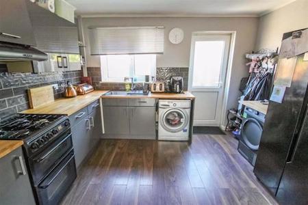

That small kitchen radiator seems likely could be undersized, even if you do improve the insulation. What are your heating bills like?

To be honest the kitchen is a bit of a mess. It looked nice on viewing and the survey picked nothing up, but they missed pretty much everything that was wrong with the house. Looks like new doors have been put on several times and now the hinges don't sit in place properly and a couple of the carcasses are damaged. There's also no extraction for the cooker.
The kitchen could really do with ripping out and starting again but given how much I've spent on things I wasn't expecting to spend on so far that's on the back burner at the moment. Also, I want to be certain I'm staying here for a good few years before I start ripping out kitchens and bathrooms (which also needs doing).

I've done the heatless calculation. The lounge should be fine, needs 7926 BTUs, has 9124. The kitchen, not surprisingly is nowhere near, needs 6632, has 877.
Problem is there's not really anywhere to put a bigger radiator. The current one is 30cm wide by 70cm tall. You could go taller, although a quick google suggests that might not be something that's available, but wider is a no go as there simply isn't space. Although one thing I did consider was bringing up on of the double doors to make it a regular single door, preferably that held heat in / out a bit better, which could give some scope to extend the radiator, although typically the door I'd want to brick up ideally isn't the one next to the radiator!
In terms of insulation in the roof how do you do it with no access? Presumably you've either got to take the plaster down or the roof off to get into it.
To be honest the kitchen being freezing isn't a huge issue, it was more a concern that the heat was pouring out via the kitchen.
The bigger problem is the lounge. Where I sit is about as far away from the kitchen as possible, on the photos it would be on the left hand side of the sofa next to the door. I feel there's a draft coming from somewhere but can't work out where. I will defiantly be trying the candle around the skirting tonight. Have also ordered a B&D TLD 100, hopefully that's easy to use and might show where there's a sudden temperature drop.

The radiator does look a bit small too ... I have curved radiators in my 1930s bays, which I think must be longer. And in the bay itself you will probably lose a lot of heat as so much glass and no insulation in the walls - thick curtains can help keep the heat in the room rather than getting lost through the windows.

A Myson kick board heater would fit in the dead space under a kitchen unit. They are a small unit, which has a large heat capacity, using a thermostatic fan to blow the warmth into the room.

I'm thinking of trying to change the kitchen to a single door to make it more of a separate room and hopefully stop heat escaping from the lounge but I'm not sure if it will look weird.
