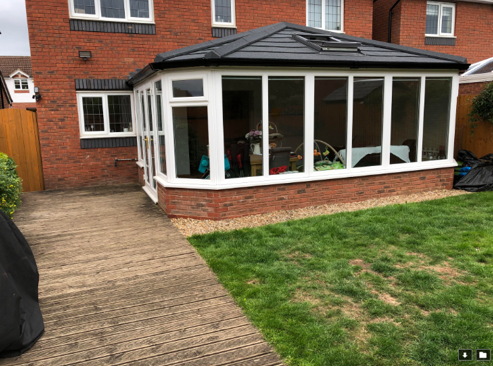

Current garden pictured below, with existing decking level with the top of the DPC. I want to maintain this level so a) we don't have a large step down from the back door, and b) so I don't have to drop the level of the rest of the garden to match (even though it is only small garden). The house was built in 2000, and the conservatory added in 2005 by Anglian Home Improvements, walls of both buildings being approx 300mm deep so I assume they're cavity walls. We bought it 5 years ago and haven't noticed any issues with the current arrangement.

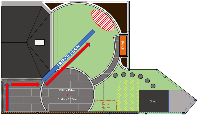

I'm planning to makeover the garden similar to my design below, and believe I can put new decking against the house walls and have it drain in the same way the existing decking does now (i.e. slight fall away from house and gaps between decking with 180mm gap underneath to a gravel base), before leading into a circular paving area that can be sloped to drain into the lawn and/or the decking.
However we would ideally like to have the whole area as paved patio rather than a mix of decking and patio, for cost, aesthetic and safety reasons (the current decking is like ice in the wet and anti-slip composite decking costs a fortune). My research suggests there are two main roadblocks to achieving this, which may have suitable solutions but I don't fully understand if they're viable in my circumstance, 1) draining the water off the patio without bridging the DPC, 2) getting rid of the water somewhere once it has drained off the patio.
1) draining water off the patio without bridging the DPC.
Due to the neighbours fence along one edge of the patio (which I'm not legally allowed to drain towards?), and the total length of the patio towards the lawn being 8-9 metres, I believe my only option is to drain the patio towards the house :eek: I believe this is ok as a last resort providing there is adequate drainage that stops water sitting against the bricks above the DPC?

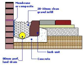

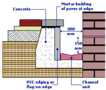

Having a 200mm stone french drain between the patio and Wall B isn't desirable (I don't mind so much on Wall A) so I'd like to avoid the proposal from Paving Expert shown below

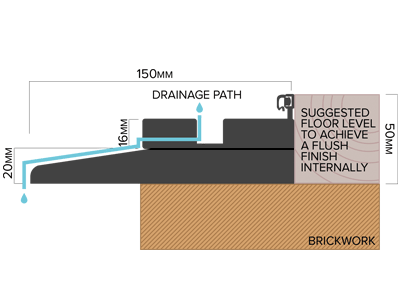

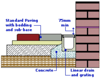

I've read people propose using a linear drain instead of the french drain proposed above, i.e. this proposal below from Paving Expert but level with the DPC instead of 75mm below. Their argument being that this would be enough to stop the DPC being bridged and 'splashing' isn't a concern because all bricks above the DPC get rained on anyway without any issues.

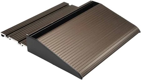

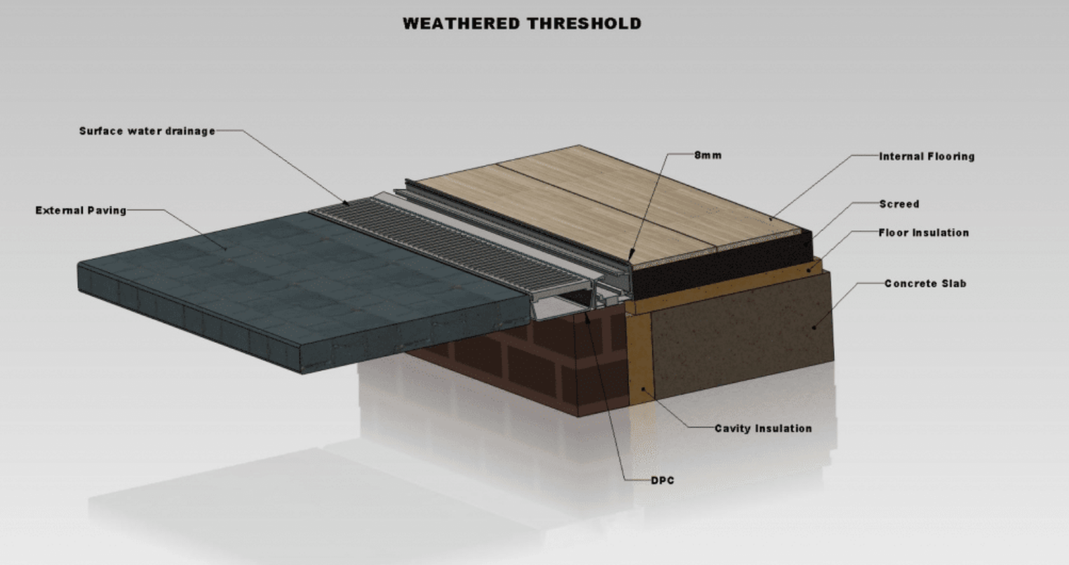

So it would be like using these threshold drainage designs but along all of the wall (albeit with the paving flush with the underside of the door sill and not the top surface). Is this an adequate solution, and if so could I use a slot drain along all of Wall B or would it have to be a linear channel to manage the amount of water (the width of patio draining towards Wall B is 2.75m and Wall B is approx 4m long, so approx 11sqm area to be drained)?

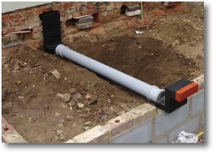

One added complication is an air brick along Wall A, the top of the air brick is the same height as the DPC so would be below the level of the proposed patio. Am I right in thinking neither the linear drain or the stone french drain solution would work here because they would block the air brick?
Therefore would something similar to this shown below on Wall A be a sensible alternative and if so would I need to measure the 150mm down from the bottom of the air brick rather than the bottom of the DPC?

Hi David, You've clearly done a lot of research already and have most of the answers. I'm no expert but had a similar experience when I raised my patio above DPC to door threshold (plus a similar air brick issue).
I'd suggest you can run your patio fall away from the house and even towards your neighbour's fence AS LONG AS you have suitable drainage in place - run a linear/clark drainage channel in front of the fence that drains to a soakaway under your lawn/Luna's toilet. The cost isn't much, just a fair bit of digging required. You're right that you aren't allowed to connect to a foul water drain. The french drain idea would be a "poor man's" soakaway but probably still sufficient given the size of your patio. However, if you already have drainage issues in the red zone, why not bite the bullet, do the job properly (as appears to be your way) and install some proper soakaway crates. Hire a micro-digger that can fit through your gate for a day (and driver).
On the airbrick and DPC, while not a solution you seek, you could leave a gulley between the house and patio (I have one 150mm wide) except for at the patio doorway thresholds where it is usual to breach the DPC with doorsteps anyway. We honestly have forgotten the gap is there. Many folk fill such with decorative stones but I think such might concern a surveyor. Leaving it empty makes visual inspection easy (checking its dry and draining) and prevents a build up of crud under the stones.

- can I have my patio level with the DPC as long as I install linear drains (like below) and ensure they are kept clear of debris so as not to breech the DPC? Would this be sufficient for either the patio falling toward or away from the house wall? Or only if falling away from the house?

To be honest I think you are over thinking it!
House exterior walls get rained on in the UK all the time - above and below DPC particularly lower down where there is no protection from overhanging gutters and soffits then dry out again when it stops.
A DPC is a horizontal barrier built into the walls of a building, typically near the ground, to prevent moisture from rising up through the masonry via capillary action, a process known as rising damp.
As long as the DPC isn't bridged, for example a blob of concrete or mortar mix which starts below the DPC and ends above the DPC or any other type of material with a capillary action then the DPC should carry on doing what it is supposed to do.
Many houses are built where the soil goes right up to the house walls, albeit under DPC level. Rain hits the walls drips down over the DPC and into the ground without issue. Why all of a sudden would you now want to start installing expensive drainage systems? You could in theory just leave a gap between the raised patio and everything would continue as it has been for years before.
Bearing in mind people usually do raised patio areas after having patio or bi-fold doors installed to bring the finished floor level up to somewhere closer to that of the room floor you step out from. These types of doors usually have decent size thresholds on them which would probably cover most of the gap anyway.
Typical bi-fold door threshold:
Any rain hitting the glass would run down the glass, off the threshold onto the raised patio slabs/tiles etc. As long as there is the correct amount of fall on the raised patio floor to make the water run away from the house there shouldn't be an issue.
I would be more concerned in diverting the water from the patio area itself, particularly if it's a large one into some drainage channel and back to the the rainwater sewers.
Alternatively there are thresholds with shallow drainage channels for use above dpc:
If the gap looked unsightly between the raised patio and the house wall, you could fill it with decorative pebbles, as pebbles do not generally exhibit significant capillary action due to their large pore spaces. If you wanted to be really anal about it you could install some aco or clarke drainage below DPC draining to the nearest rainwater sewer with decorative pebbles on top (bigger the better, easier to clean out and less if any capillary action).
Another alternative would be to treat it like a brick chimney or a wall abutment with lead flashing. You could chase out the mortar a brick or two above the DPC level or in line with the underneath of the door threshold, bang some lead flashing into the brickwork, then beat the lead down past the DPC into an aco or clarke drainage channel. A vertical piece of lead would have no capillary action at all... Finish with decorative pebbles and seal the lead where it goes into the brickwork with a nice neat line of lead mate silicone sealant. Any driving rain would simply run down the wall, down the lead into the drainage channel.

For airbricks you'd simply extend them: Google air brick extending.
